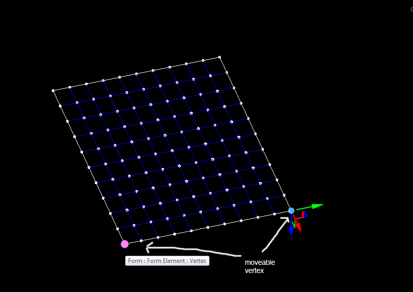

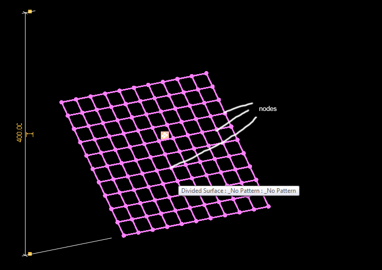

When you divide a surface on vertical and horizontal lines, and you make your nodes visible. Nodes as the spots on the grids intersection. You dont have the same ability as with the nodes called Vertex on the corners of the surface.
What I would like to know is there any way, to make surface nodes selectable (therefor movable) as the vertexes? Look at the images
Any help is appreciated
Michael
Mon, May 10, 2010 at 3:55:51 AM | Surface Nodes. Help.
Joined: Tue, May 22, 2007
5921 Posts
4 Stars: 205 Votes
I think you should watch this: http://buildz.blogspot.com/2010/03/look-ma-no-api-rule-based-form-creation.html
