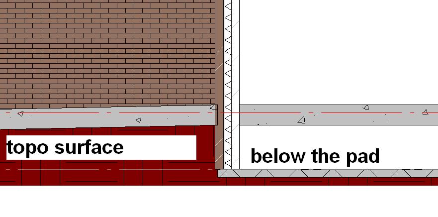

I am wondering if there is a way to create a void in a toposurface? My problem is that i have a basement 4' below grade with a patio at the same level, i need the toposurface to go around the patio space, or lower it 4'.

yeah, i know but i want the pad lowered 4' then the toposurface at grade around the pad,

Tue, May 11, 2010 at 4:35:55 AM | Toposurface
Joined: Tue, May 22, 2007
5921 Posts
4 Stars: 205 Votes
Great image... I CAN'T see anything what you want...

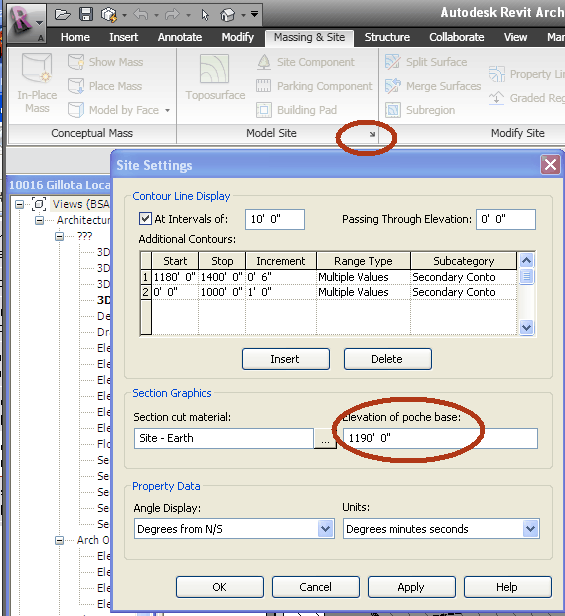

Tue, May 11, 2010 at 9:04:45 AM | Toposurface
If your problem is the depth of the site poche, you can change that settings in the site pull-down - see attached:
