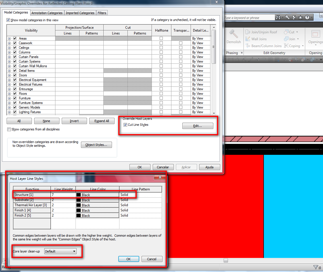

Hello...
 When we make a compound wall with many layers.. the wall in plan shows higher lineweights to the outermost boundaries of finishing. for working drawing purposes, we need the core boundary layers to have the highest line weights..
can we change the lineweights ??
 please advise.
P.S.: i am using revit architecture 2010.
Sun, May 2, 2010 at 5:20:15 AM | Wall's line weight in plan
Joined: Tue, May 22, 2007
5921 Posts
4 Stars: 205 Votes
Check in your "Object Styles" - "Cut Lines Styles" ...
