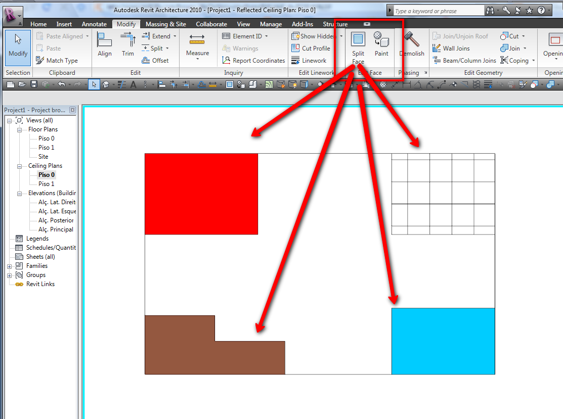

YES, you can... just use the "Split face" and the "Paint" tool...

How are you doing that? can you show us? put some images to see how you are creating that "Split"...
