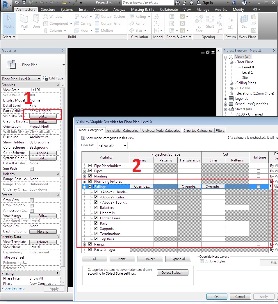

@Typhoon - where do I find the visibiity?  I looked into both the railing and baluster family parameter and I don't find the visibility to check on.
Tue, Mar 14, 2017 at 7:17:43 AM | Making railing balusters visible in plan
Dheena14asian
Joined: Sat, Oct 8, 2016
0 Posts
Have a look in the attached image.
Tue, Mar 14, 2017 at 7:27:15 AM | Making railing balusters visible in plan
Ballusters were not cutable in earlier than 2017 versions.
railing wont update balusters.
