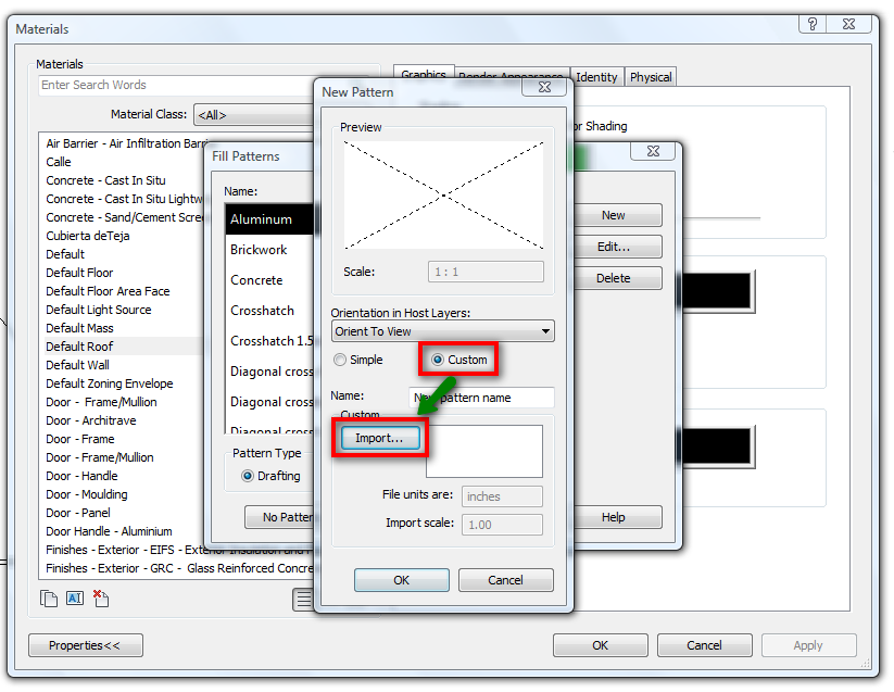

I down loaded the spanish tile roof pattern from Revit City.  What is the process to being able to use these patterns.  IE when I create a roof system I would like this pattern to be on the finish surface pattern.  Or am I not using this system correctly?
Thank You
Wed, Apr 28, 2010 at 2:02:08 PM | Roof patterns
You need to load the pattern into your project or template.  Under manage/ settings/ fill patterns

I am on Revit version 2011
Wed, Apr 28, 2010 at 3:03:20 PM | Roof patterns
KenM
Joined: Sun, Dec 23, 2007
6 Posts
KenM
Sorry for asking for more information, However I am new to Revit and not a computer wizard.
Can you give a few more directions as to how get the tile roof pattern so I can use it.
IE: type this, go to that.
This would help.
Thank you
Ken

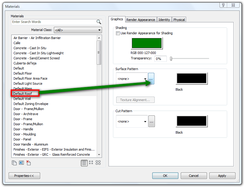

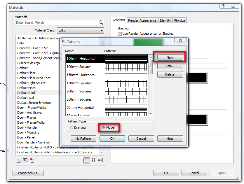

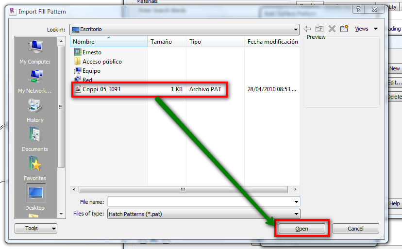

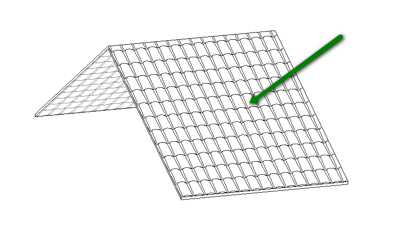

Follow the arrows.............
76117_2010-04-282059.png76117_2010-04-282055.png76117_2010-04-282050001.png76117_2010-04-282056.png76117_2010-04-282057.png
Wed, Apr 28, 2010 at 10:24:42 PM | Roof patterns
KenM
6 Posts
erland 73.  Thank you very much.
Good instructions.
Ken
