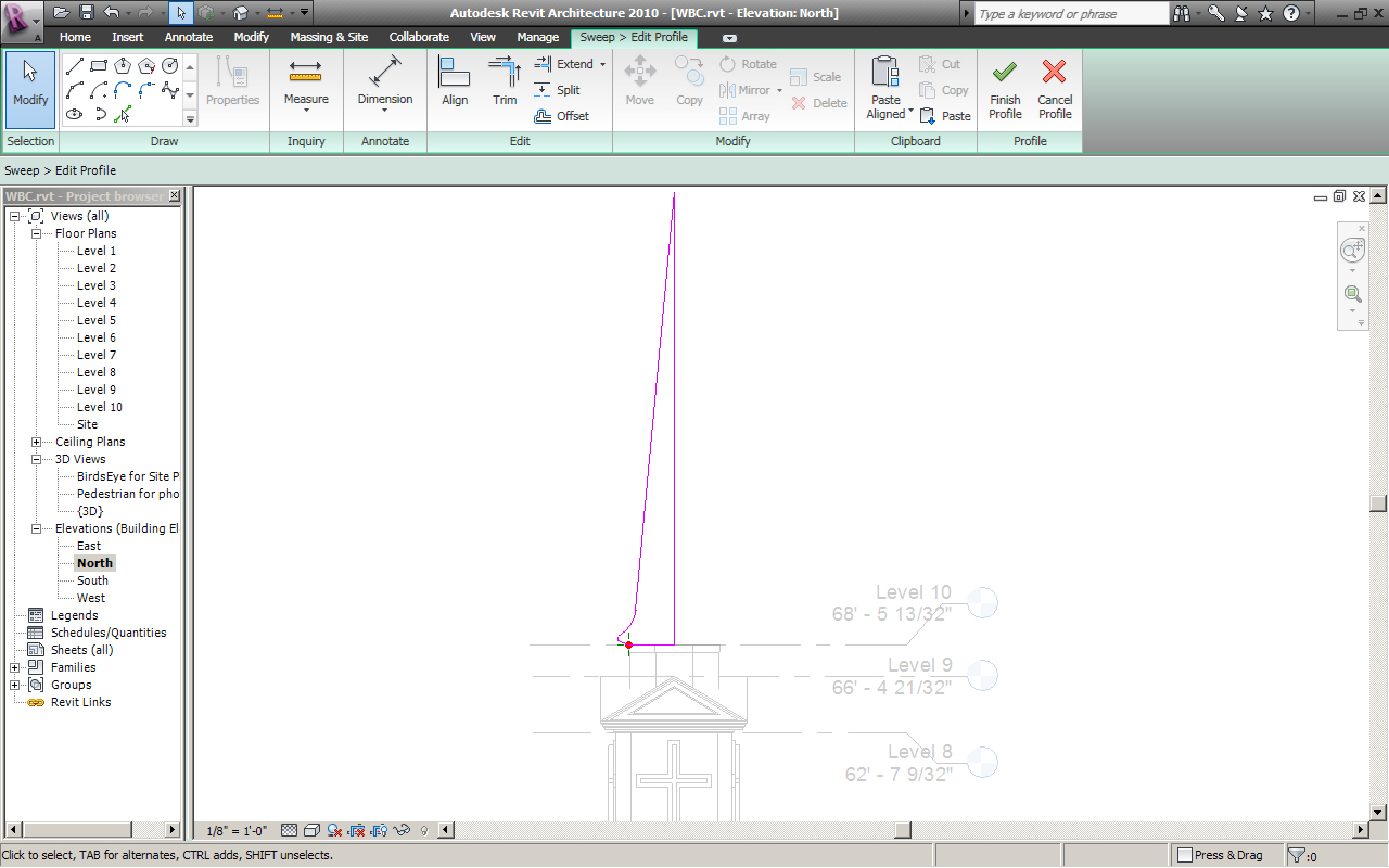

 I am having some problems trying to create a Steeple by using the Sweep tool using Revit 2010.  I selected create new component, then selected roof category (only because I didn't know which one to use), then selected Sweep under Solid.  Attached, you will see an image of my path, as well as my profile of the steeple.  When I click finish sweep, Revit gives me an error message saying cannot create sweep.  Does anyone have any idea why it won't let me? I have done numerous sweeps, and can usually figure out what the problem is, but with this one I am stumped.  Any advice would be very much appreciated! Thanks!

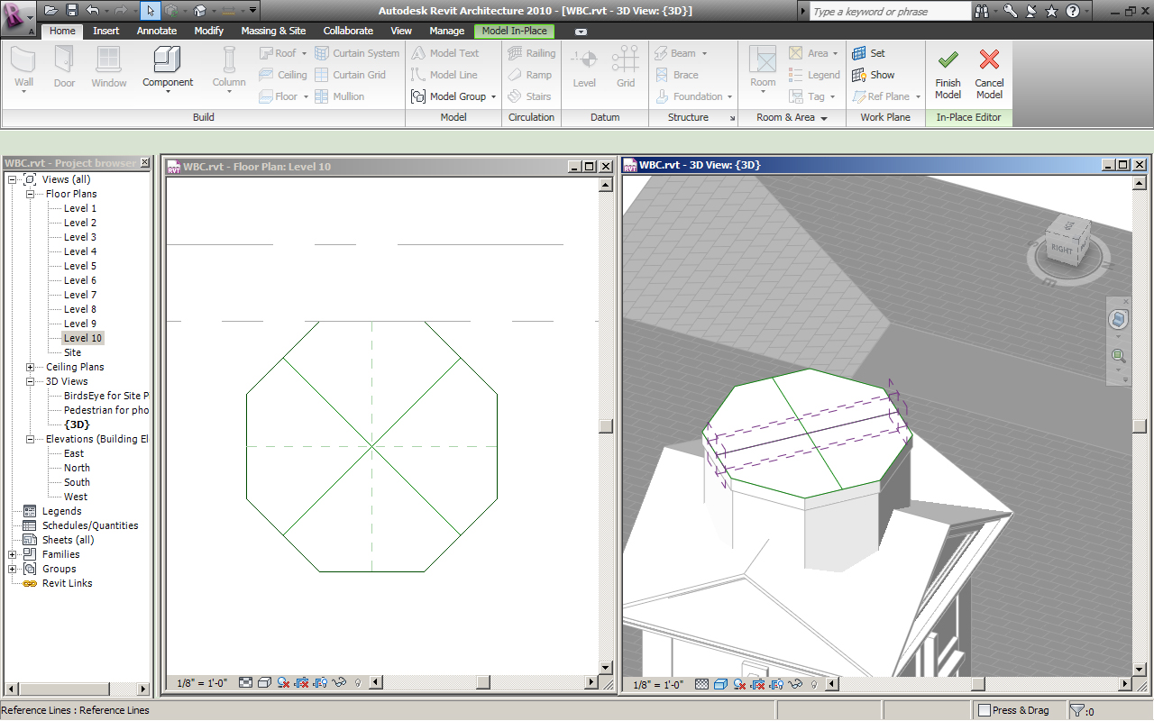

Ok, see this: http://www.megaupload.com/?d=5YX3SYKR

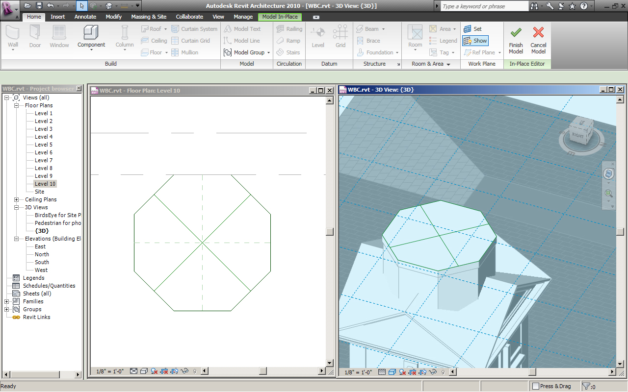

This is by far the best help I've ever received on this website! Thank you so much for taking the time to do that for me. I am having a problem with it though.  When I go to set my workplane, I select one of the crossing reference lines you said to draw, then it asks me to select a view, and 3D view is not in the list. I select the level I am drawing on, and then when I click Show, the plane is horizontal, not vertical like yours.  Is this a problem?

Don't you have a 3D view created in your project? if not just click on the icon (button) and you have a new 3D view, then follow what i did...

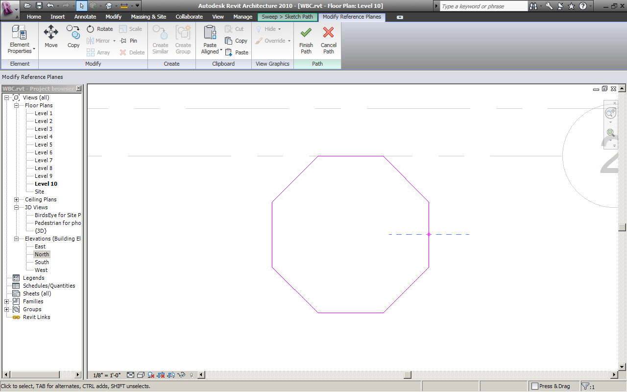

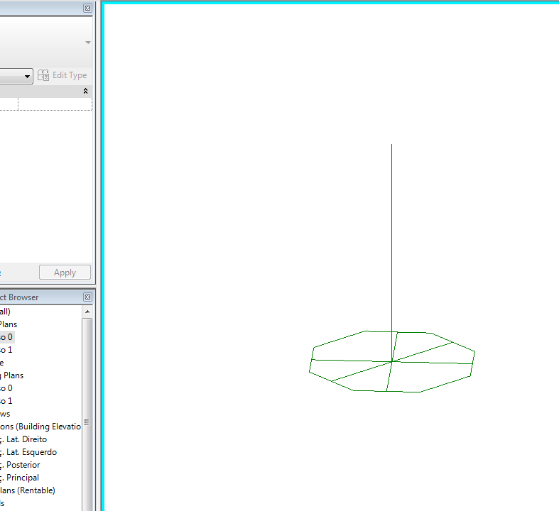

Attached is a picture of what reference line I select to set my workplane. The second picture is what shows up when I click "Show."

Use your TAB key to select the vertical plane of the Ref. Line...
that's the trick....
