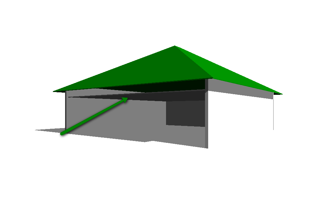

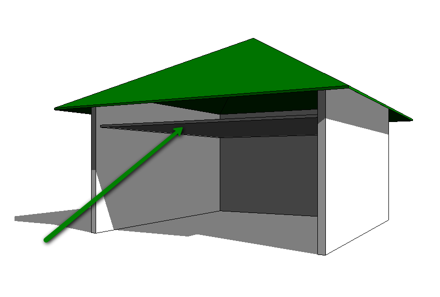

I know how to make the roof, but how do I create a flat, interior ceiling?

Welcome here....see the images attached.........

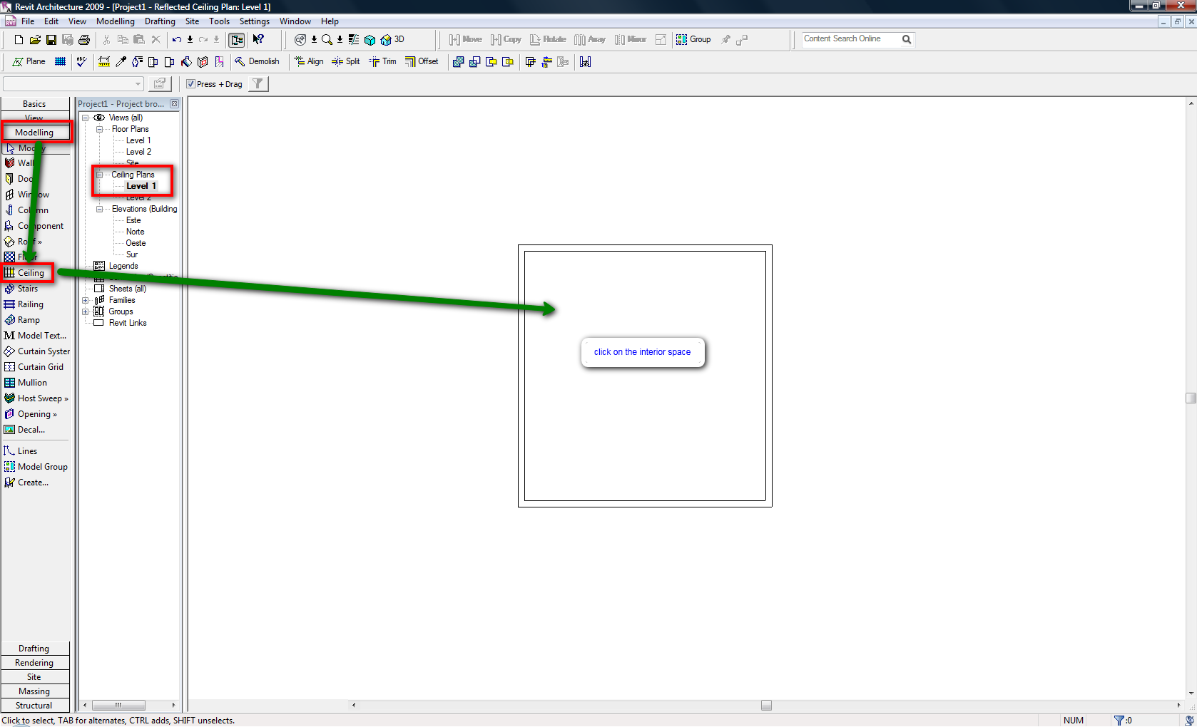

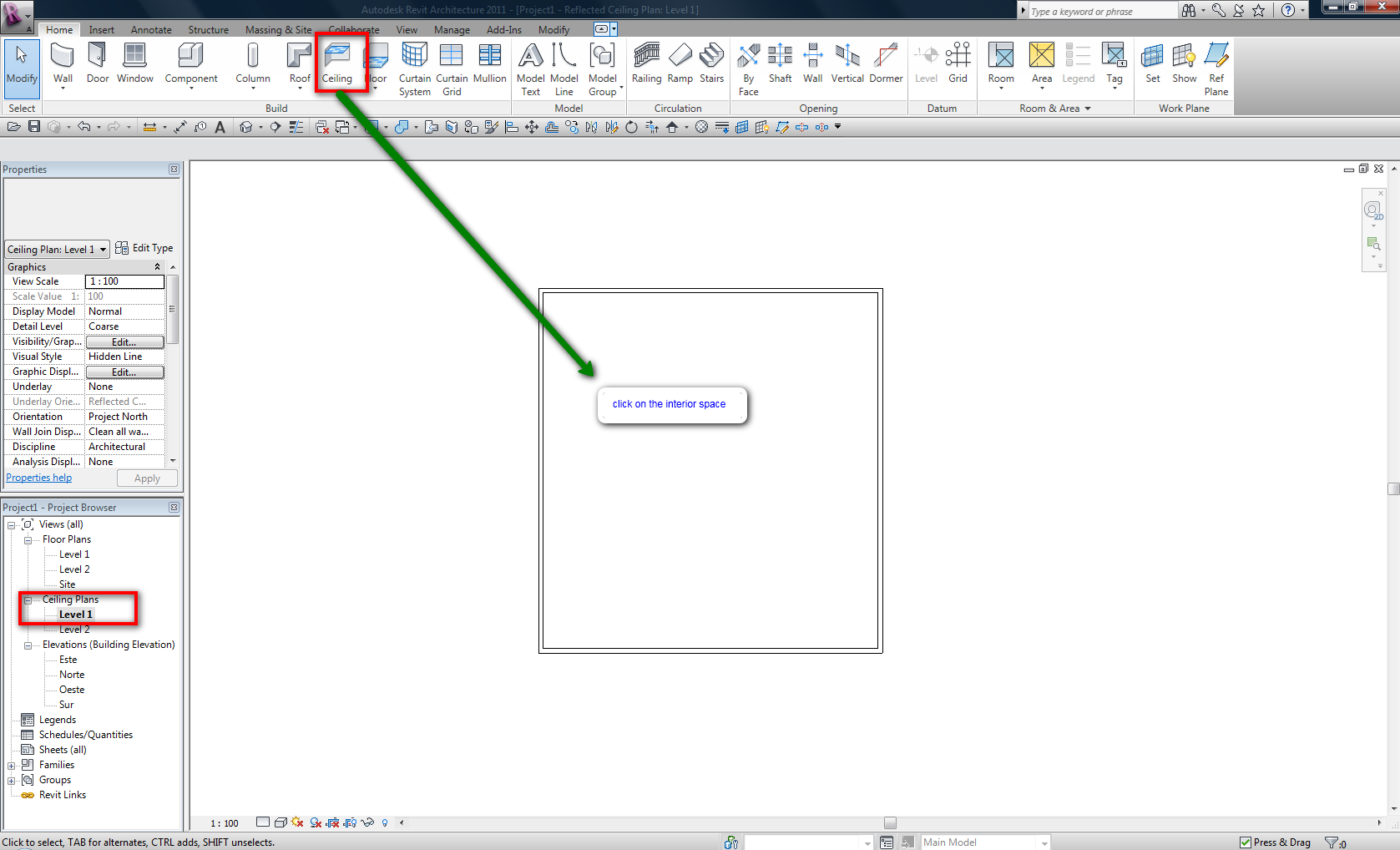

I have the 2009 version

Ok, RAC 2009.............
Creating ceilings.
