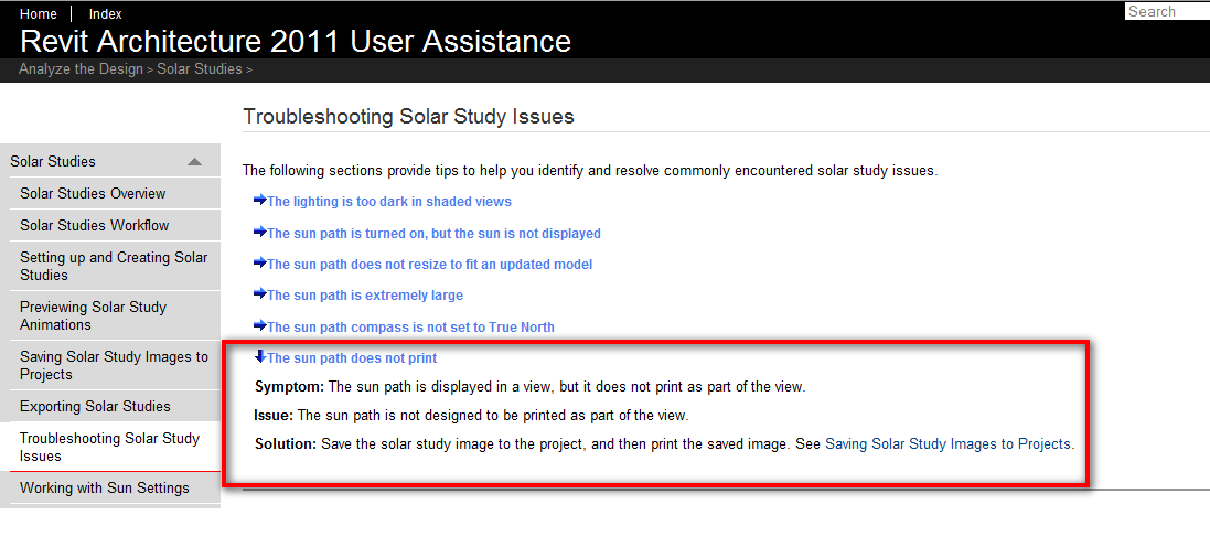

is it possible to print a 3D image with the sun path showing in revit 2011?

I DON'T KNOW BUT YOU COULD ALWAYS DO A PRINT SCREEN AND EDIT THE IMAGE IN PS OR PAINT. GOOD LUCK.

Leeroy, i don't think so.... I try printing directly from Revit and Export to a DWFX and don't print...

Leeroy... here is the solution from Autodesk.

well done typhoon... much appreciated

I had the help of HDD too...
