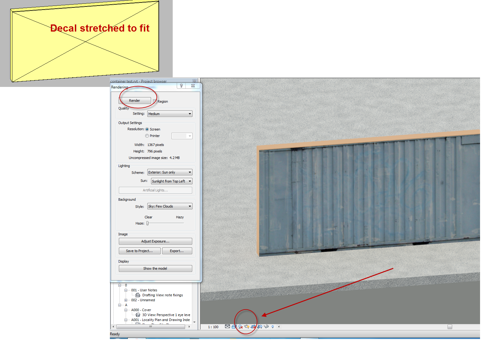

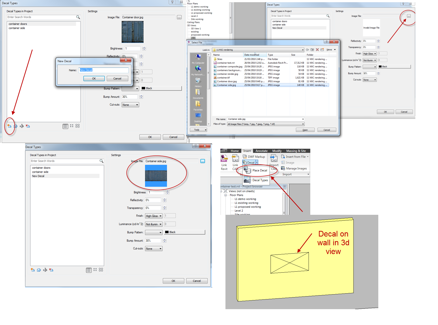

Apply walls to your masses
Create a decal with a jpg of the container sides and ends
http://www.google.com/imgres?imgurl=http://shaderlab.com/slrl/textures/urban/crates/container_side_white_1.jpg&imgrefurl=http://shaderlab.com/slrl/textures/urban/crates/&usg=__qcBdCornfaIup3yHX8TiziWAw3o=&h=256&w=512&sz=18&hl=en&start=9&sig2=Okl-XXPWrVZb4NHl5R1CfA&itbs=1&tbnid=pr8wOG95SDywwM:&tbnh=66&tbnw=131&prev=/images%3Fq%3Dcontainer%2Bside%26hl%3Den%26gbv%3D2%26tbs%3Disch:1&ei=1AfUS8mQMp7mtQOQmbjnCQ
Apply the decal to the wall and stretch to fit.

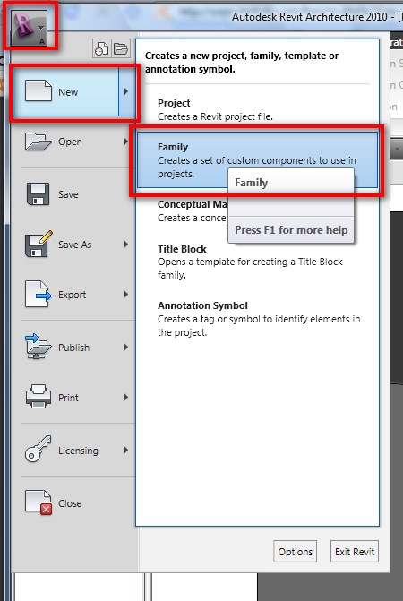

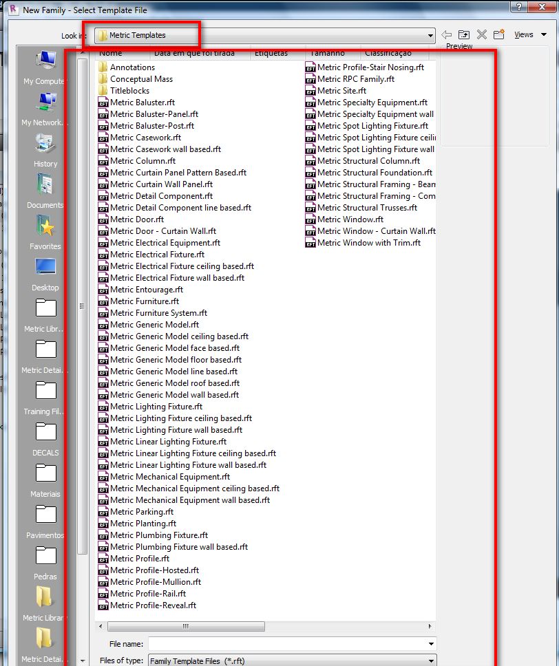

You can create all different kind of families using the family templates, there are System Families, Standard Families and In-Place families but you CAN'T create SYSTEM FAMILIES...
Check in your HELP menu what is SYSTEM FAMILIES and so one...
BTW a MASS is a family too.....
