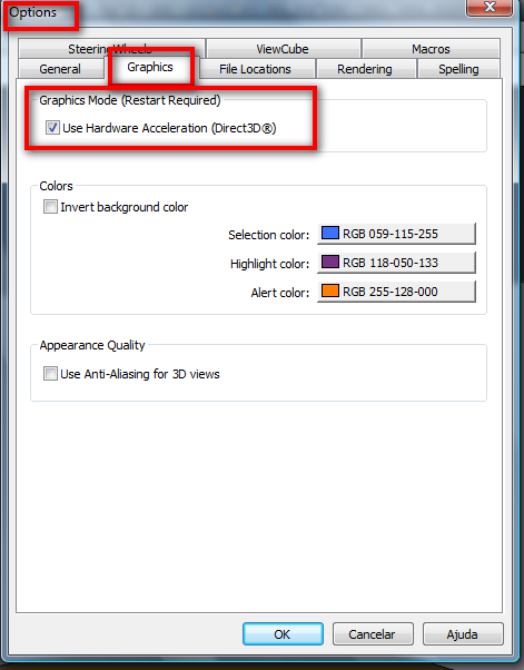

"The time to start a Revit session from scratch is currently 4 minutes?? " - I don't have Windows 7 but with that machine it's not normal take so long to enter in Revit.... Did you turn ON the "Hardware Acceleration"??

Have defintiely turned off the hardware acceleration - Last retart took 8 minutes and 12 seconds.  After it starts it works fine.  Currently looking at the infocentre as being the possible casue of the issue?

Turning on the hardware acceleration - Last restart took 10 minutes and 26 seconds.
