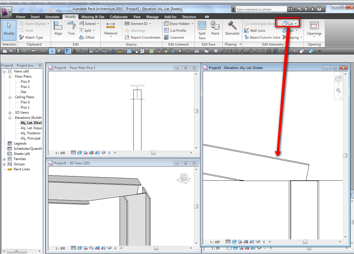

Hi Everyone,I'm having trouble joining diagonal beams to a column. I am using Revit Architecture 2010 and I just can't find a way to join them (see attached image). I don't need it for sections or details, it's more for renderings/3d model.Thanks in advance

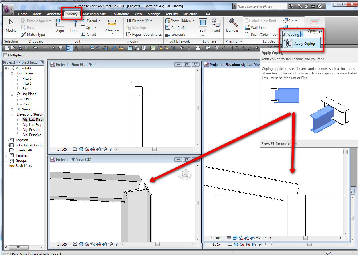

Did you "play" with the "Coping" tool?

Or with the "CUT" tool??
