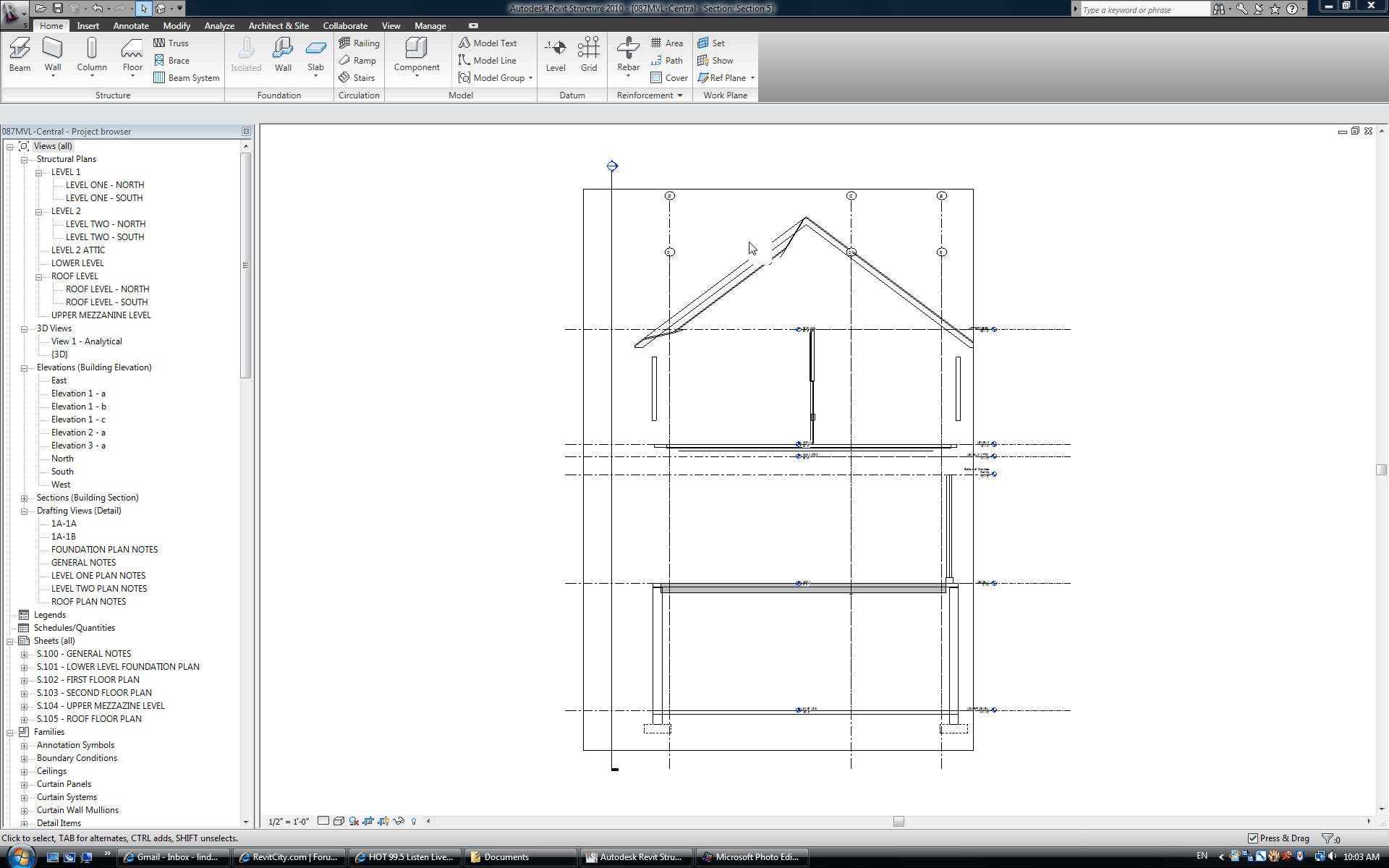

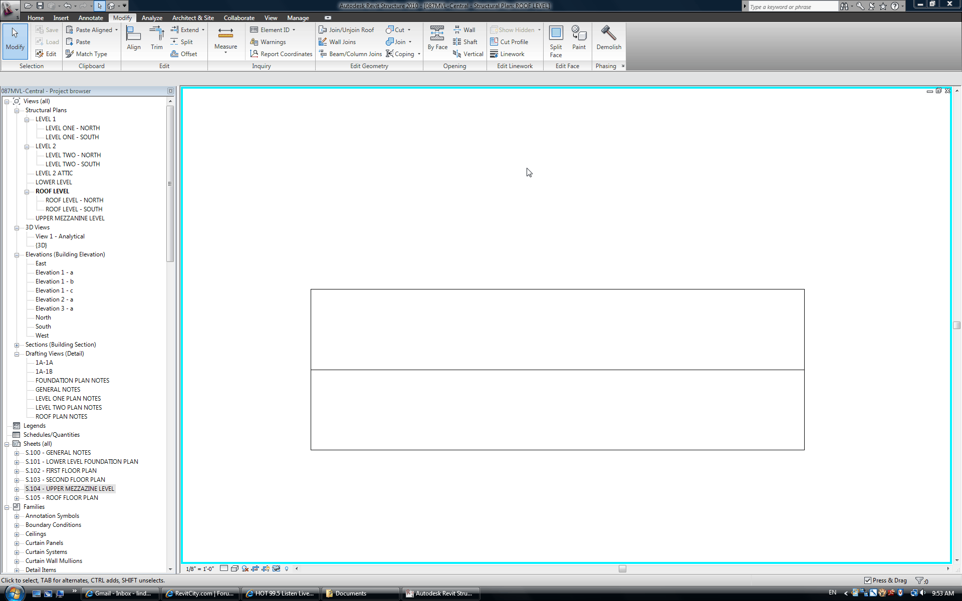

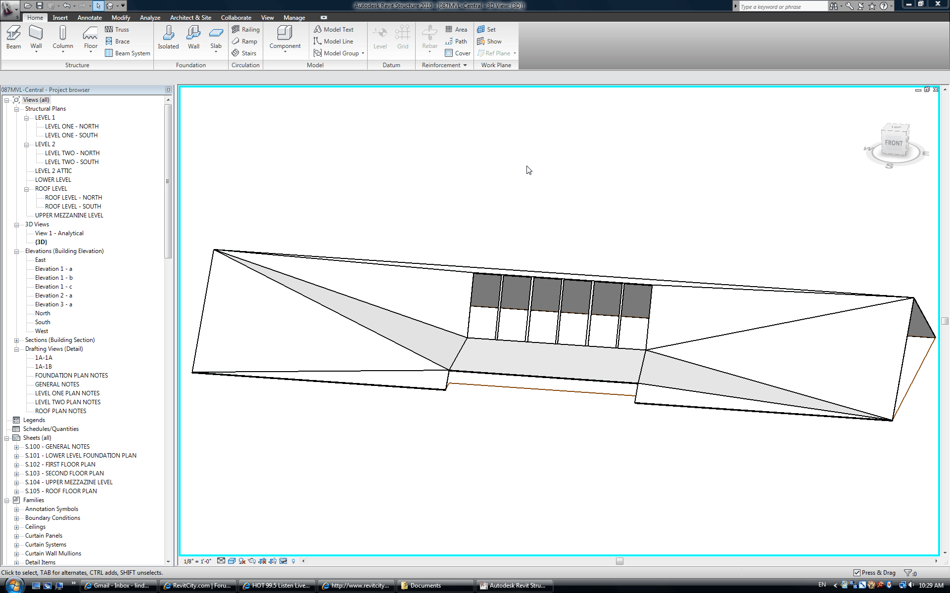

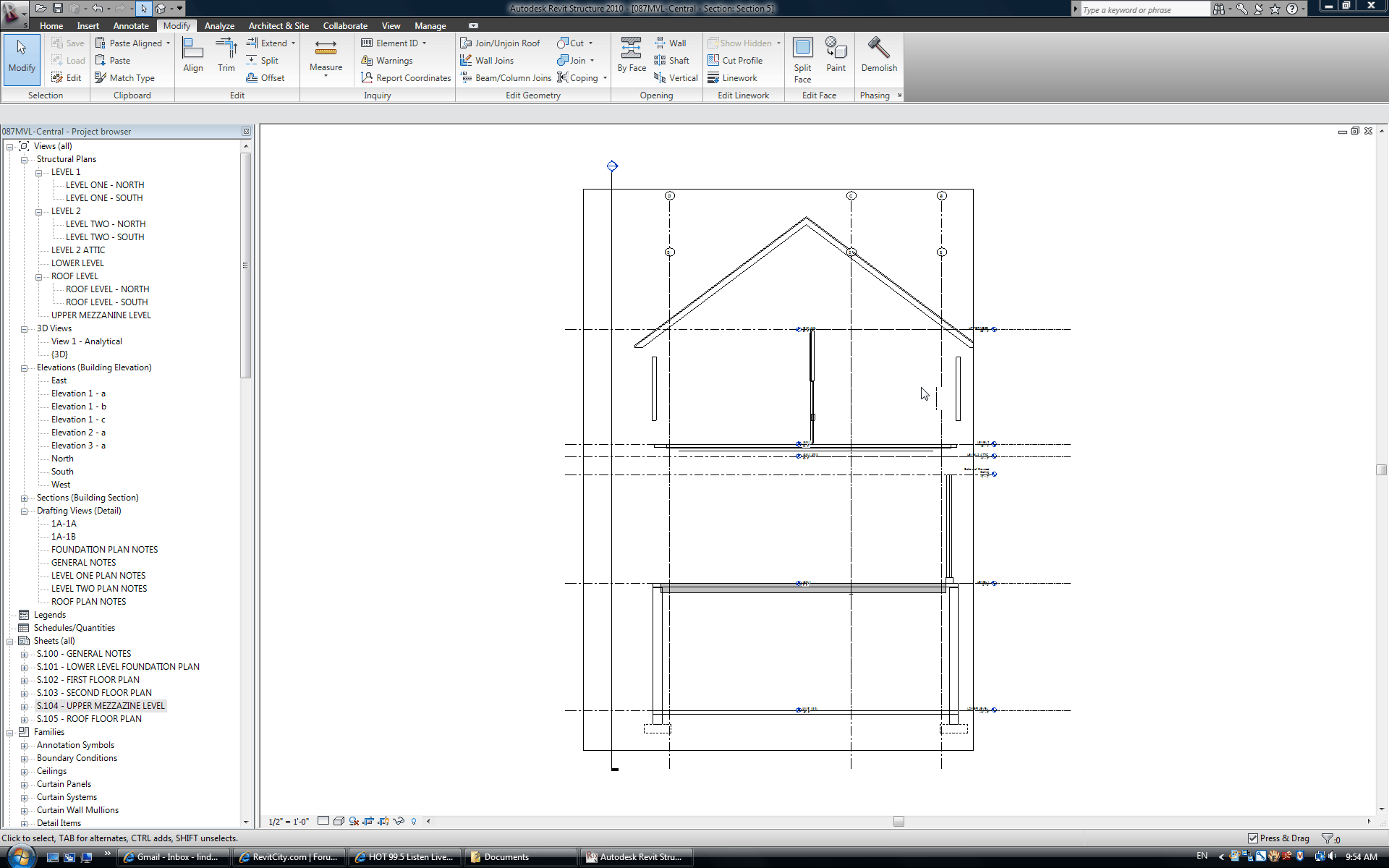

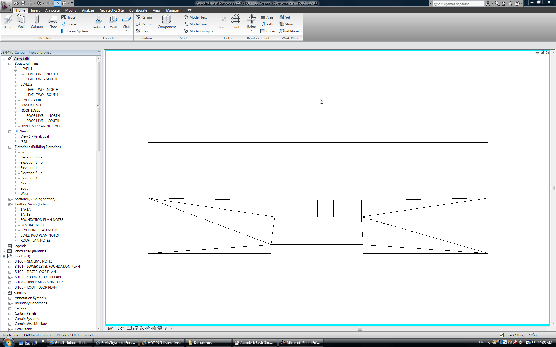

 I've been checking the forum for a possible answer.  I have a pent-up roof and it looks fine when the roof is rectangular.  The roof, however, has skylight openings and a notch.  I go to edit boudaries (or footprint) and weird roof slopes appear.
 This is what I did --
--I drew my rectangular roof (1-1/2" metal deck)
--after giving it an elevation height, I drew in my split line and added elevation points to both ends.
--I go to edit boundary, I draw in the openings.  Weird roof slope appears.  I add in elevation points the skylight openings and to the inside of the notch.
Am I doing this right?  I don't think I should be seeing those lines.  plus, in the section view, it doesn't look right.

I know what's wrong with it, but I'm not sure on how to fix it.
The openings and notch isn't going along the slope.

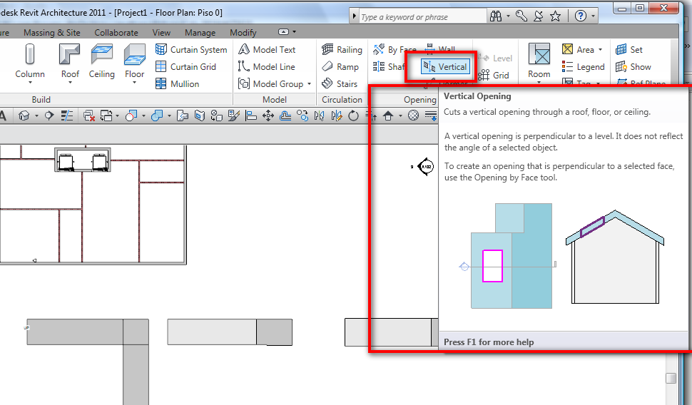

One Question: Did you try with the "Vertical Opening" tool in that Slab/roof???
