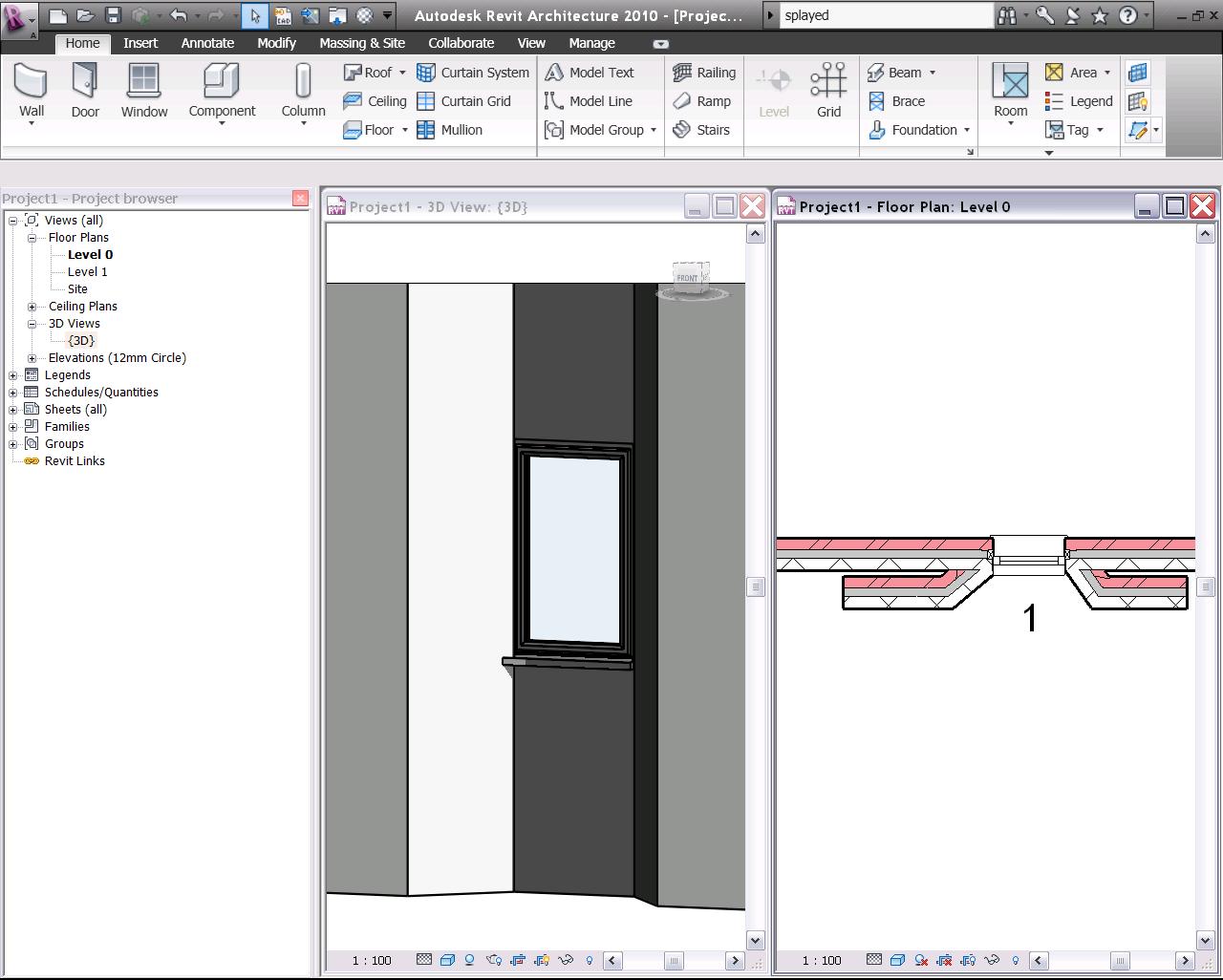

Here is a cheating way you can do it,
I'll have a play and see if I can come up with anything better, but this works in 3Dand you can just mask reigon to make it work in plan
- Just trying to help out while I wait in the office for my renders to complete

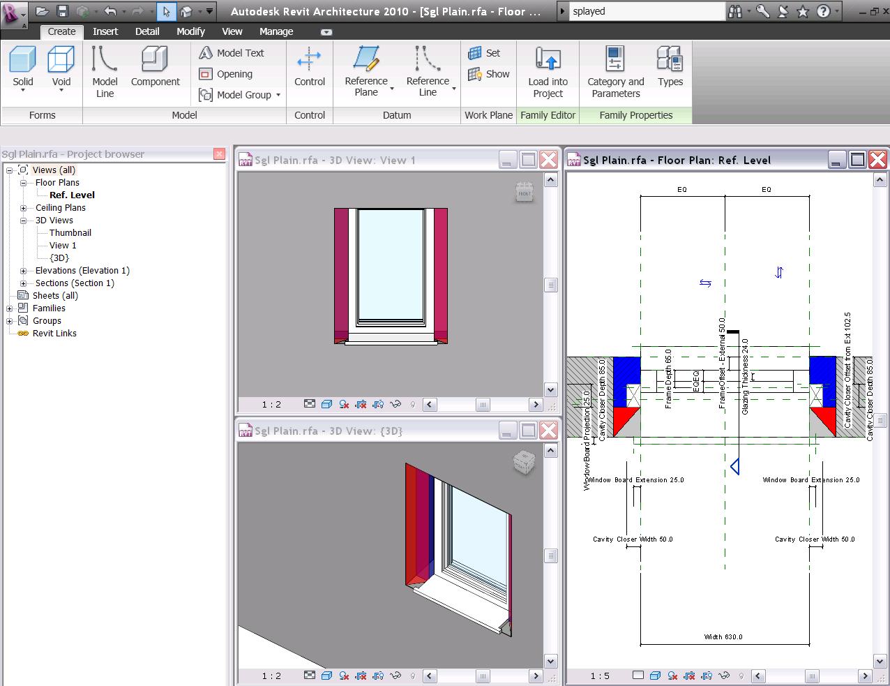

Another way is to edit your window by stretching the opening and placing two masses inside of it, the first being aligned to your external wall, and give it the parameter of 'Ext Mat'
Draw your splayed profile for the other and give it the parameter of 'Int Mat'
 Done as shown
be careful with it, as any bump patterns might not match up with your wall
www.danrossiter.co.uk

Thanks for the quick reply, i like the first idea as i can create i single plasteboard wall and do the profile, it does mean doubling up on walls but oit gives the desired effect. as you say in the second isea it knocks the materials out on my test render,
i was just wondering if there was a way of doing the splay in the window component itself, but may be not.

the second is built into the window itself.
Just follow what I did step by stop:Increase the opening
Add the solid extrusions
Align them up
