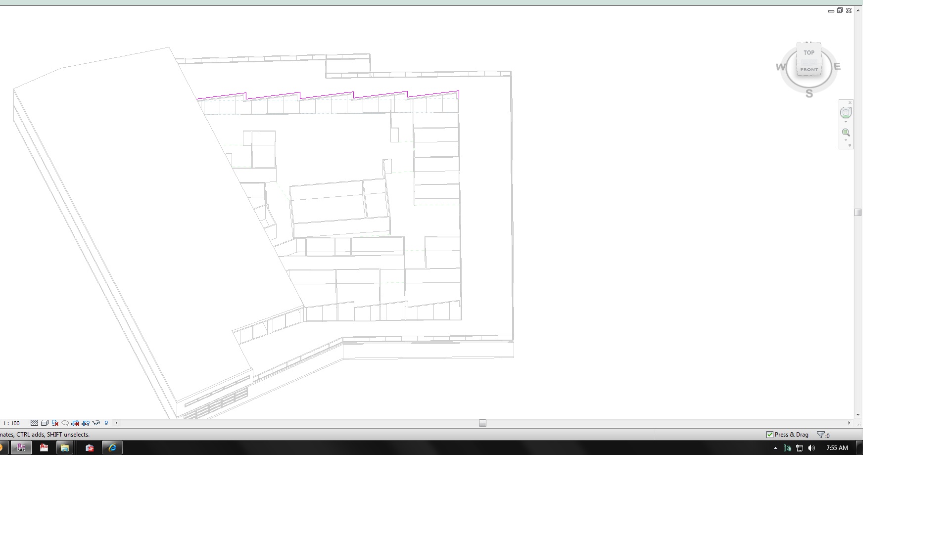

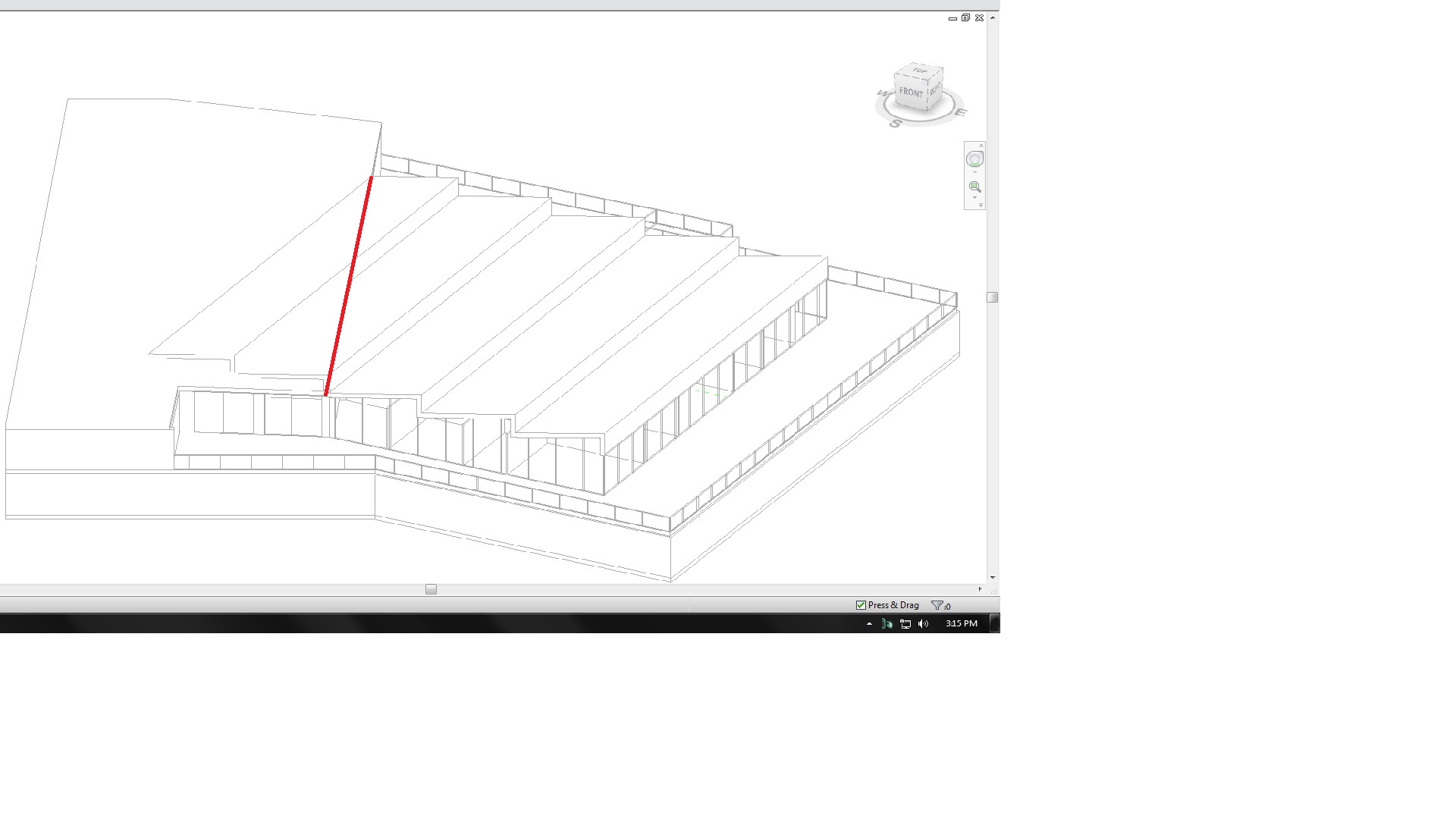

Just a quick question. I am modeling up a building with a saw tooth roof that meets with a flat roof half way along the building but i need to trim the saw tooth roof along the red line, and remove everything that is on the left. The flat roof section is a floor slab that has been coppied up. Is this possible? OR do i need to re-draw this as a roof to be-able to do this?
 Using Revit MEP 2010
 Thanks.

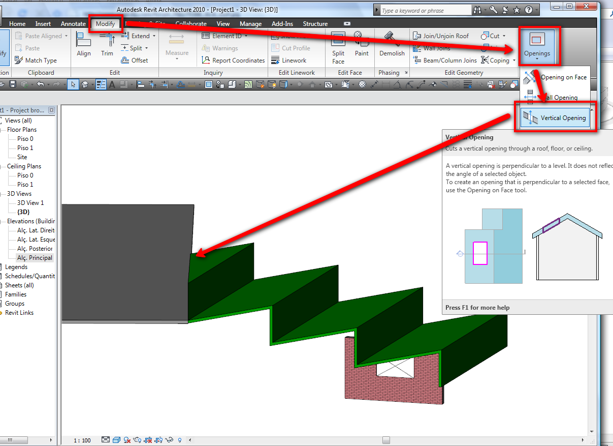

Try to use the "Vertical Opening" in the "Modify>Openings"

When i try to use the vertical opening i just get the error "The roof couldn't be cut." as soon as i click the button, before any user input.
Is there a way to you can draw a profile on both sides? as i have drawn the roof profile in elevation (see pic) but i need it to come across on an angle, as it dosnt butt up square with the other roof.

Look at my image above, i go directly to "Modify>Openings>Vertical Openings"... Can you put here only those two Roofs, so we can take a look?

Roof > Extrusion
