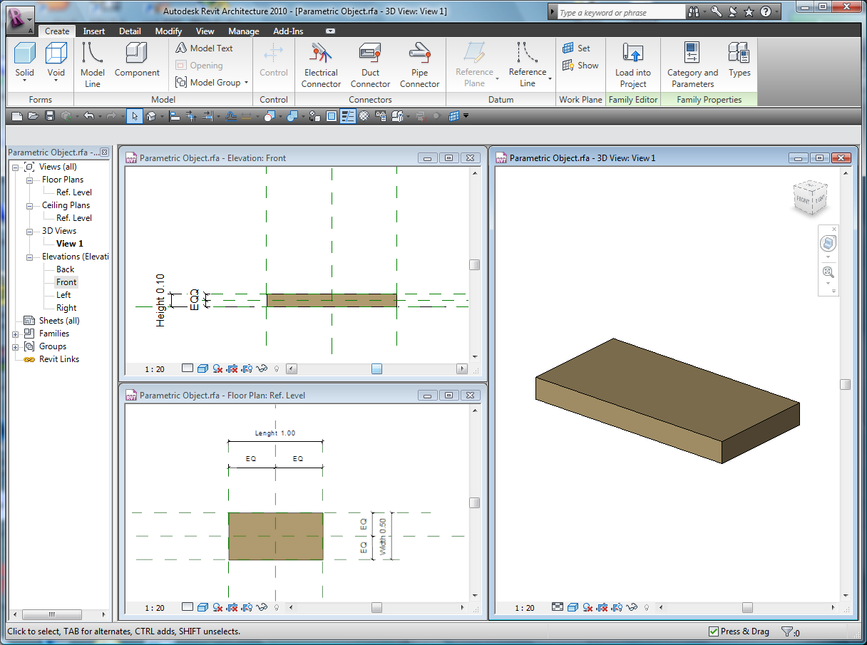

Sun, Apr 18, 2010 at 1:04:17 PM | hauling
Joined: Tue, May 22, 2007
5921 Posts
4 Stars: 205 Votes
Quoting hauling from 2010-04-18 11:36:50
Sorry for the small text
I am looking to create a parametric object
Edited on: Sun, Apr 18, 2010 at 11:37:52 AM"
Great, i ask you "what object are you try to create "Parametric"???" - Here you have a "Parametric Object"...
Enjoy

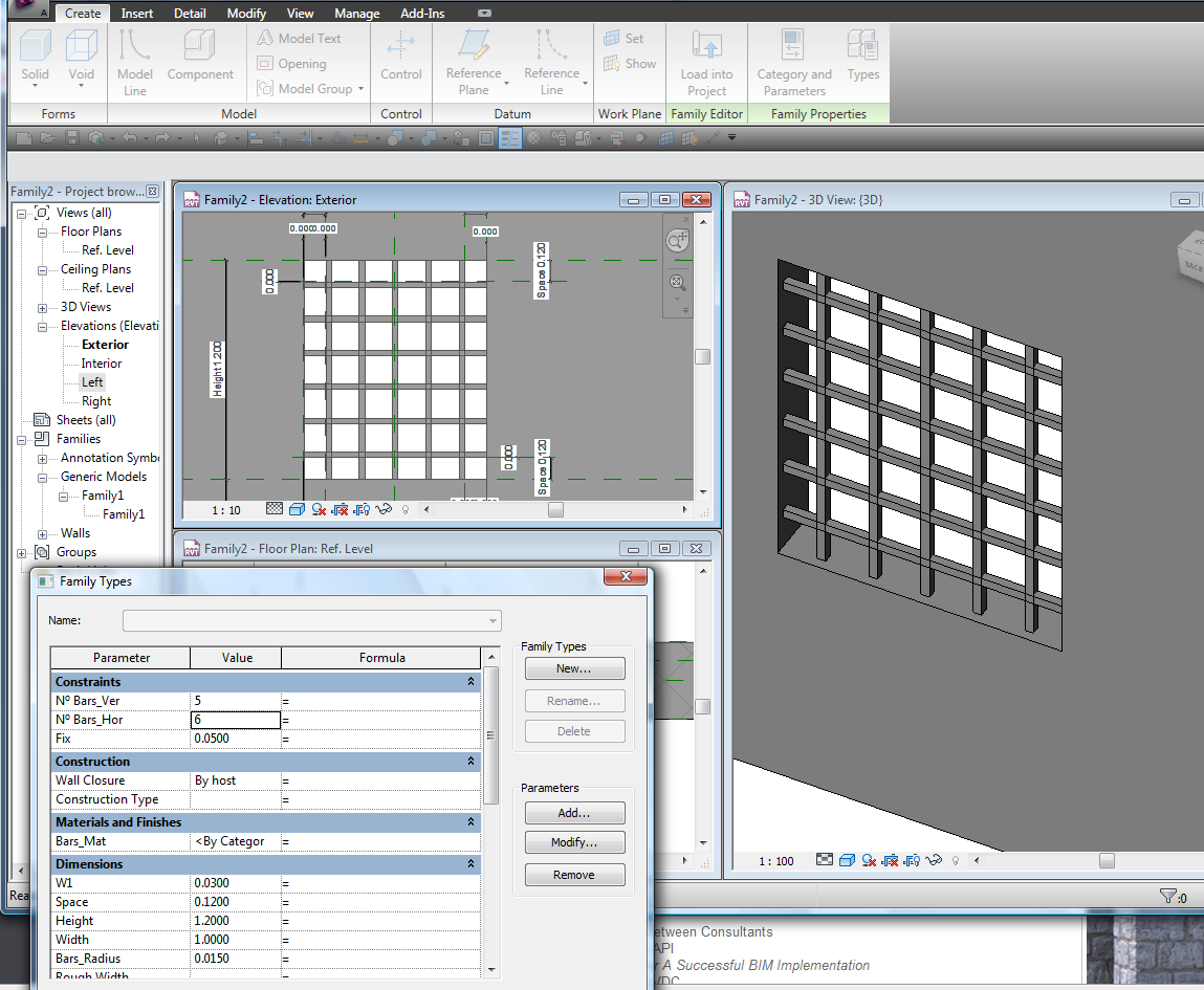

Sun, Apr 18, 2010 at 2:28:07 PM | hauling
erland73
erland73 Avatar
Joined: Fri, Sep 7, 2007
738 Posts
4.5 Stars: 85 Votes
Maybe this could be useful for you to create your "unknown" parametric object..........Part 1
Edited on: Sun, Apr 18, 2010 at 3:02:35 PM
Sun, Apr 18, 2010 at 3:00:57 PM | Create an object
erland73
erland73 Avatar
738 Posts
4.5 Stars: 85 Votes
Part 2..........
Edited on: Sun, Apr 18, 2010 at 3:03:13 PM
