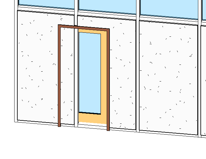

Fri, Apr 16, 2010 at 9:25:22 AM | Newb Question: Tilt Up Panel
#10
GRINHEART,
I'm not being offended and I hope your not.  You are missing the point of my post!  A door or window can not  span across a grid line!  You have to edit the grids.  Please look at the attached and if you can do something different - please post.

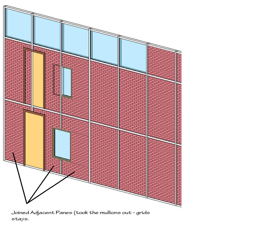

Fri, Apr 16, 2010 at 10:55:12 AM | Newb Question: Tilt Up Panel
#11
GRINHEART
GRINHEART Avatar
Joined: Fri, Jun 12, 2009
157 Posts
4 Stars: 5 Votes
I'm not being offended in anyway.... I consider this a "constructive argument" in which a lot of ppl learn a lot from including myself. Anyways... I was able to figure something out about it (see attachment).
 "If you tell the truth, you don't have to remember anything"
Fri, Apr 16, 2010 at 12:08:57 PM | Newb Question: Tilt Up Panel
#12
So you had to add grid lines on above the door (window) and remove those from other areas and remove the grid from the head down  Seems a little complicated.
Vertical wall sweeps are very easy to place on regular walls.  The problem is that the wall will not schedule as individual elements whereas the curtainwall will.
Fri, Apr 16, 2010 at 1:00:49 PM | Newb Question: Tilt Up Panel
#13
GRINHEART
GRINHEART Avatar
157 Posts
4 Stars: 5 Votes
Yup...that's exactly what i did. I totally agree... it's a little bit of tedious work but it can be done.
