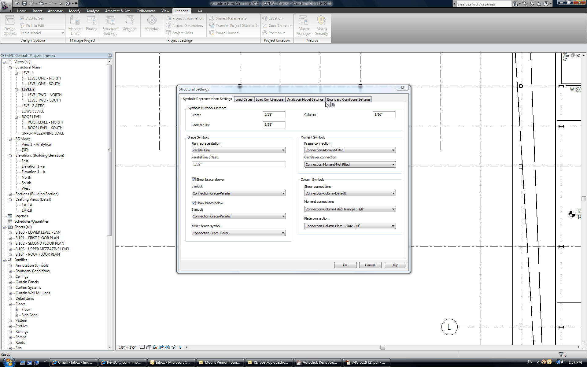

ok, this is very simple on your project browser under families right click on Connection-Moment-Filled and select edit.
modifie it and the re-load to project.

Also, is there a way for the cantilevered moments to have the filled symbols, instead of the not filled symbols?  right now, i have them as regular moment connections, just so the triangles come out solid.

if i understand right, you want to show your canterlever symbols not solid?  in any case if you are using 2009 go to setting and click on structural setting if you are using 2010 go to manage and the click on structural setting,  there you can change that.

no, i want to show them solid (filled-in)
 they don't let me choose, so i guess it can't be done...

yes you can
