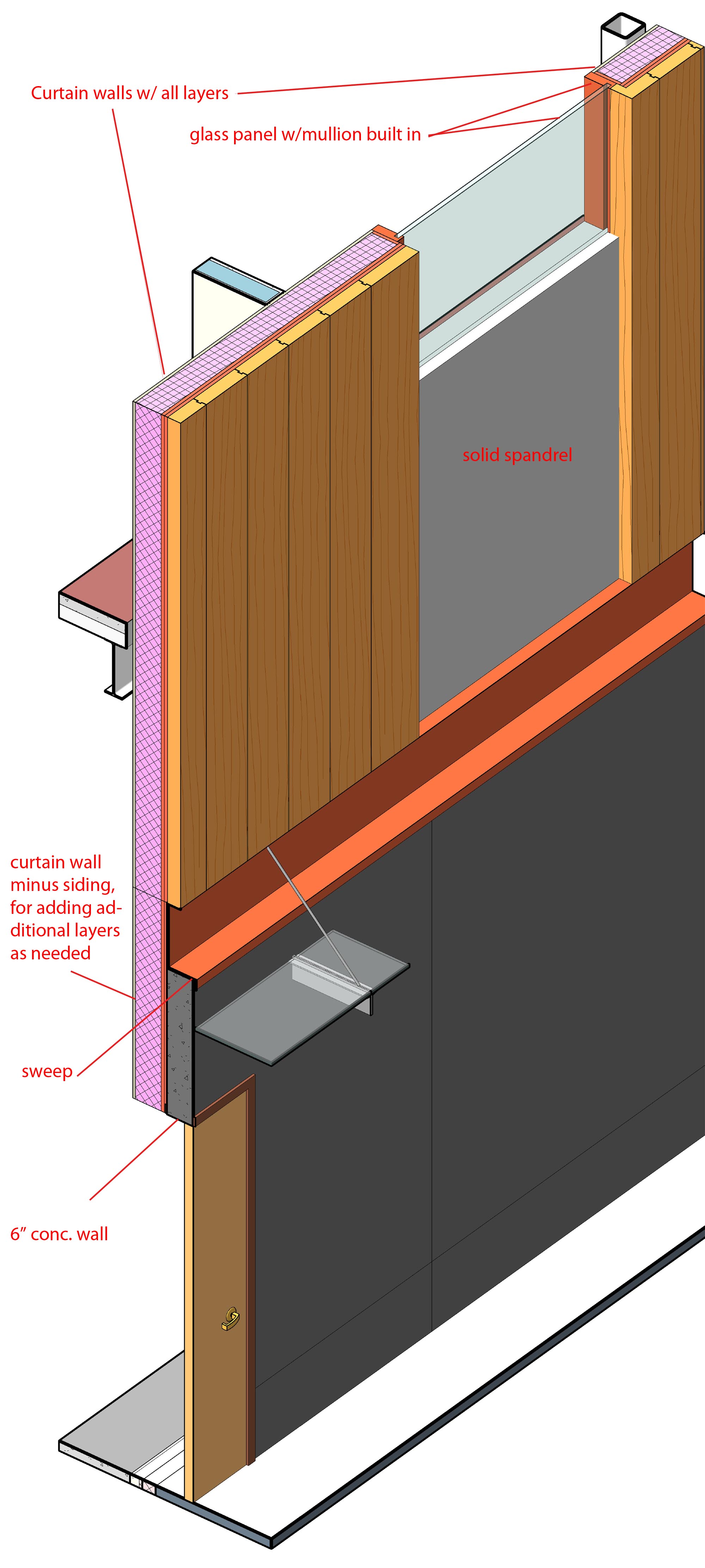

Here's a picture of one of the more complicated conditions on the exterior of my current project.  I've fallen in love with curtain walls.  What's nice about a curtain wall is that it moves as one object, and the panels that compose it are easilly controlled with grid lines.  I am a HUGE fan of keeping things simplified.  So once I know what a wall type is going to be -- I build a panel.  There are then a hanful of varriations to that wall type throughout the project, but probably no more than three or so conditions.
So, in the attached pic there's only one curtain wall, and one basic 6" concrete wall.   So two walls in the attached pic.  And it could have jsut as easilly been one wall if I didn't need to host objects in the concrete.
This building is sort of a peculiar case, however.  We're working with prefabricated panels -- if we had normal exterior walls, we would just use walls, most likely.  But with a complete set of wall layers.
So basically, I try to keep the walls to as few objects as possible, and I'm happy to build parametric families as a first step because it saves so much time in the long run.
