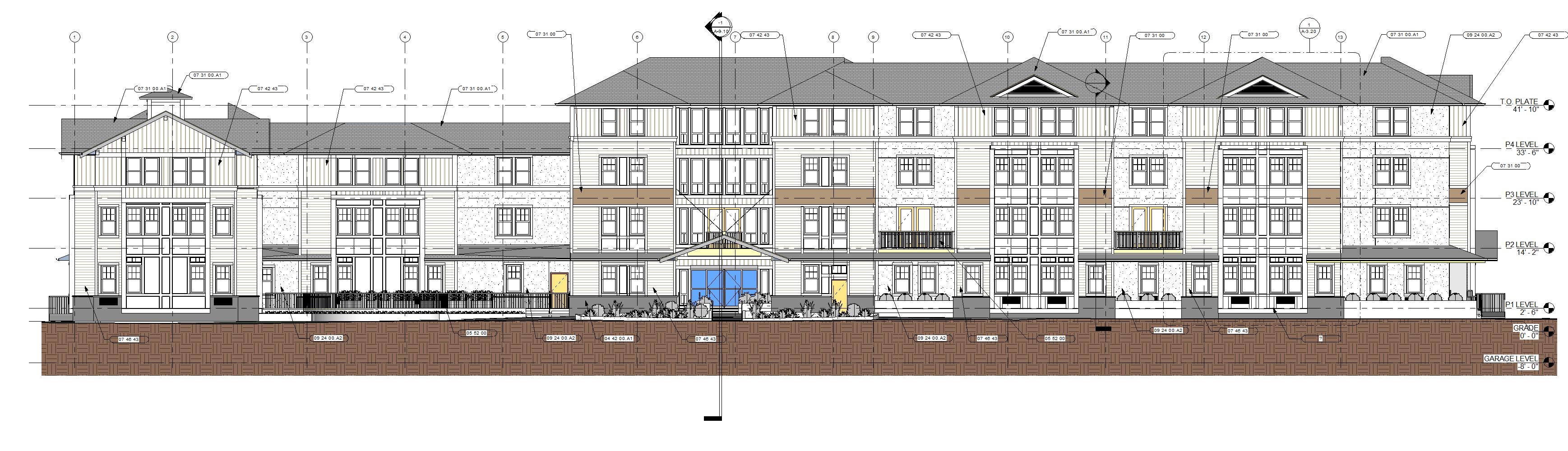

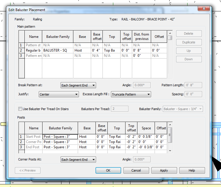

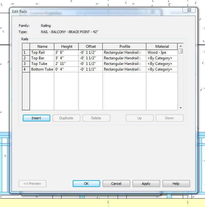

 As you can see in the attached images called Rail Elev_REVIT, I am having problems creating the railing in the image called Rail Elev. The baluster pattern is not working as I would like and I am not sure how to correct it. My baluster pattern family is the two 1.5" posts offset from each other. I made them the exact height, rather than parametric, because this product is from a manufacturer and the dimensions were provided. Please, if somebody could take a look at my settings and let me know how to correct this, I would be very grateful! Thanks

My mistake, I uploaded the wrong Rail Elev_REVIT image. Please see the new attached image. As you can see, the baluster pattern isn't centering itself the way that it should.
Tue, Apr 13, 2010 at 2:09:37 PM | Baluster Settings
Special configurations like this can be troublesome.  Consider multiple railings in the same location.  One railing might have the rails and main posts.  And the other might be a series of rails (ea panel) that just has the in-fill pickets.
