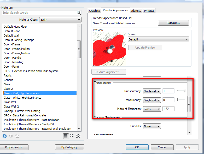

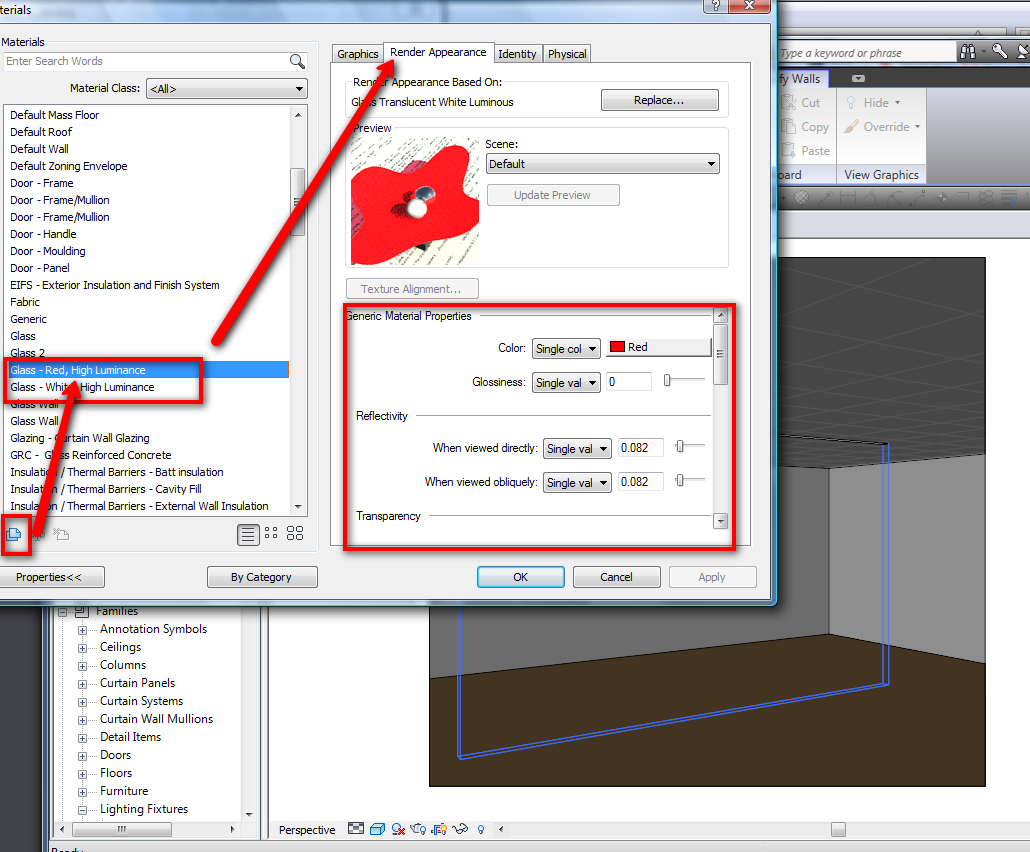

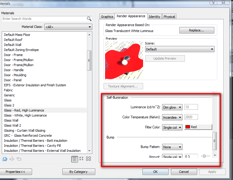

You can use the material to your wall, duplicate that "Glass - White High Luminance" and give another name then you must adjust the values of transparency, glossiness, Self-ilumination and color temperature to give that effect.
Play with that...

I see that I was using the wrong glass material. I will try that and play around with the settings.
Thank you so much for setting me off onto the right path. It was driving me crazy trying to get the appearance that i wanted.

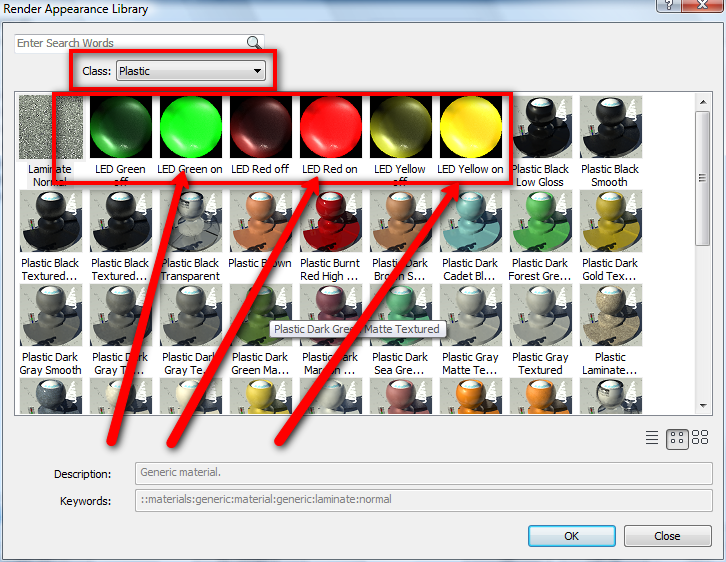

You also can use the "Plastic" material like you can see in the image attached...

Thanks, I will experiment with that material too.
