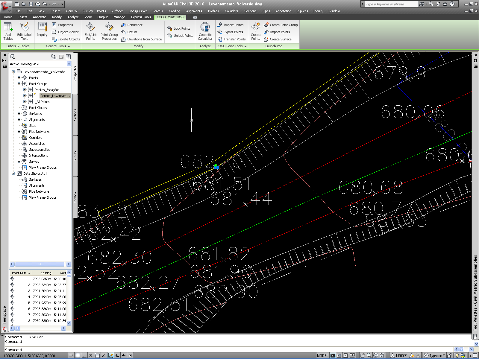

Cannot even start a site model. I have imported an autocad site plan and I am hoping to be able to "trace" the CAD lines in order to create my 3D site model in Revit.

Do you have the "Z" (elevation) Labels (text) in Autocad or points with Z ???

What i'm talking about (like you can see in the image) is the LABEL of the Elevation point, it's ONLY text..... do you have that in your CAD file?

typhoon - yes

I ask you: "What i'm talking about (like you can see in the image) is the LABEL of the Elevation point, it's ONLY text..... do you have that in your CAD file?" - and you said: "typhoon - yes"
So.... watch the video: http://www.megaupload.com/?d=QK9WS65N
BUT first download and save the LISP routine into a folder...

Thank you! this is going to be so helpful
