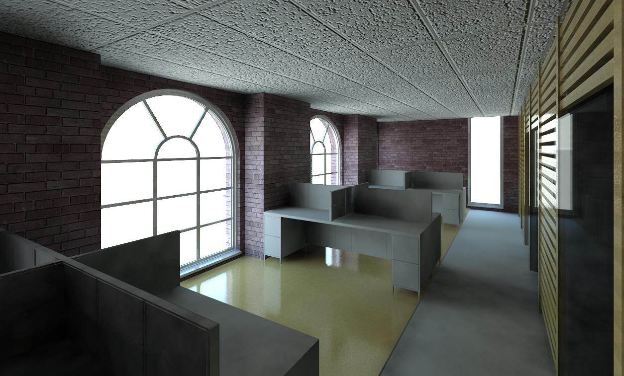

Thu, Apr 8, 2010 at 9:38:03 AM | New wall family
Kev030981
Joined: Tue, Oct 13, 2009
16 Posts
many thanks - with a bit of playing i'm half way there.... enclosed image
Just need to figure out how to make the horizontal mullions closer and add the doors!  Thx for advice!

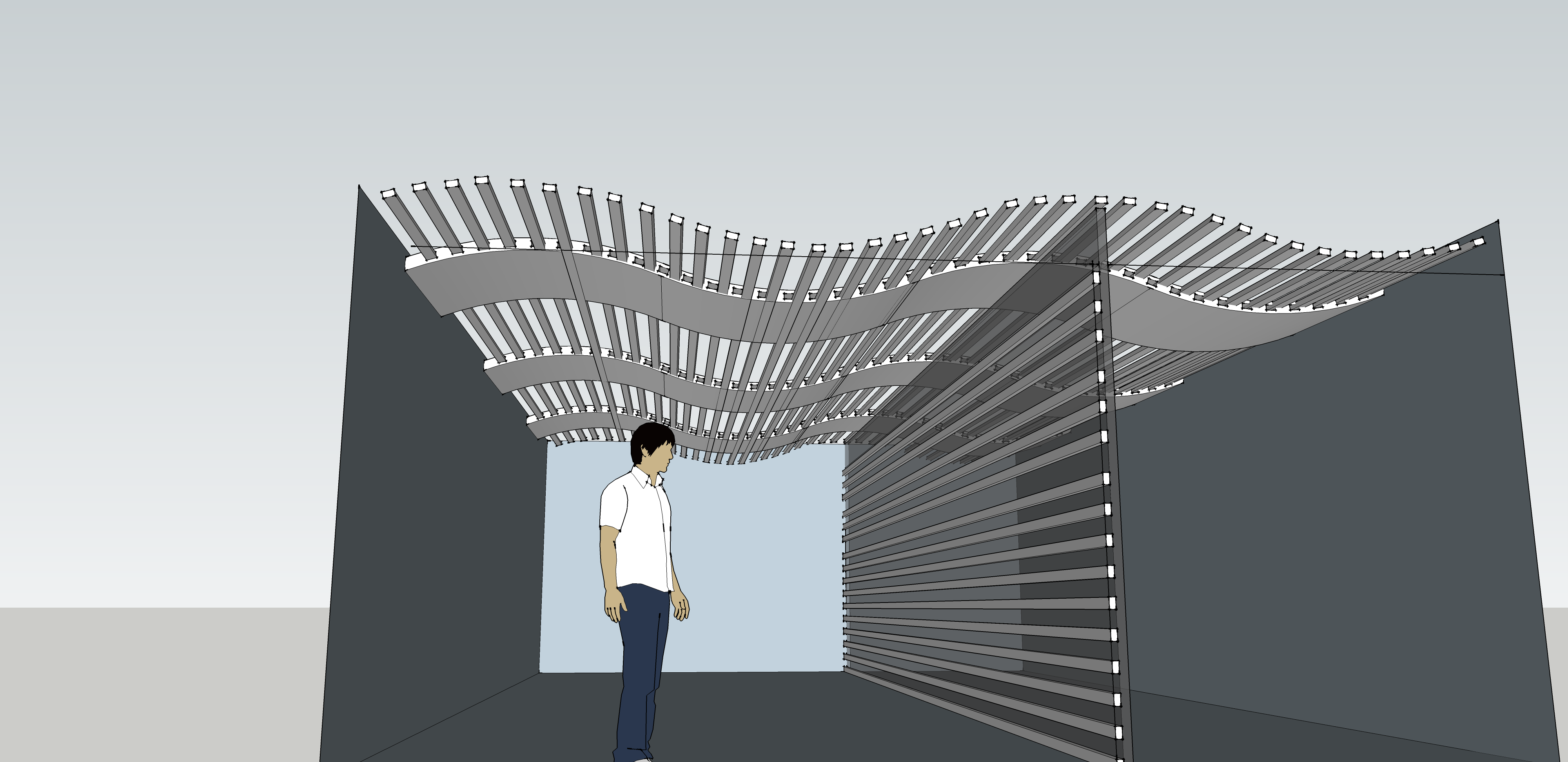

also thx WWHub - i think this will be easier way of handling the outer slats layer.  I'm attempting a similar thing with the ceiling next... I've enclosed a rough sketchup image.  I havent truly looked into this yet, but any advice on how to get started with this one? (sry to add into same thread).
KEv

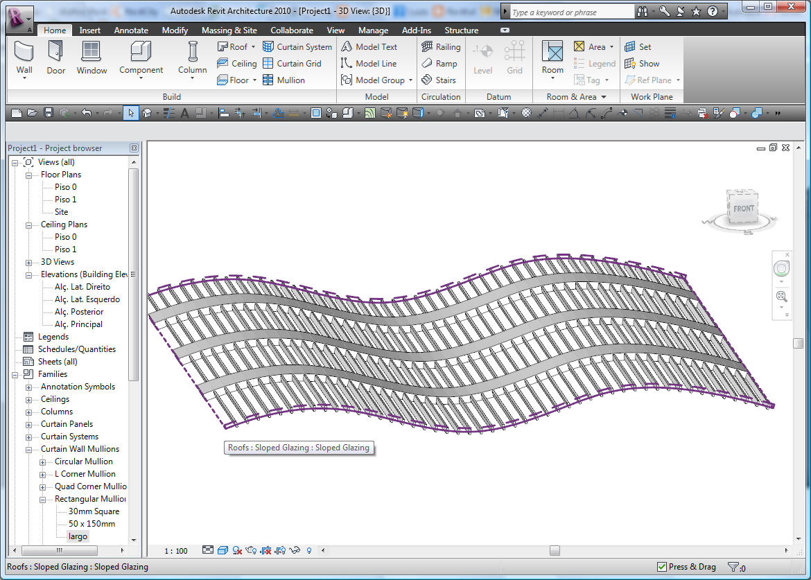

Thu, Apr 8, 2010 at 10:16:25 AM | New wall family
Joined: Tue, May 22, 2007
5921 Posts
4 Stars: 205 Votes
I think i use the "Sloped Glazing" system to create that...

Mon, Apr 12, 2010 at 4:22:40 PM | New wall family
#9
Kev030981
16 Posts
Thanks for that Typhoon - greatly appreciated!
