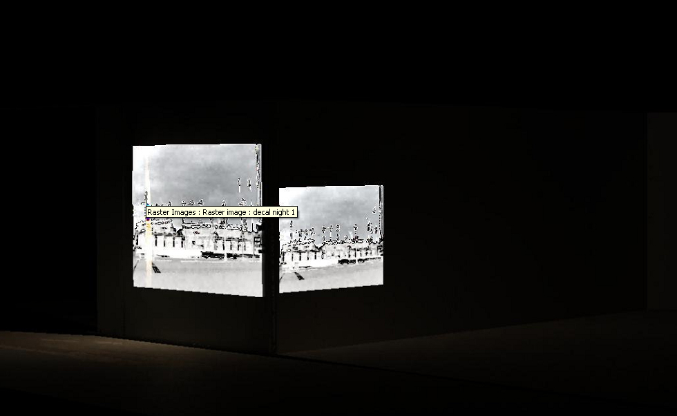

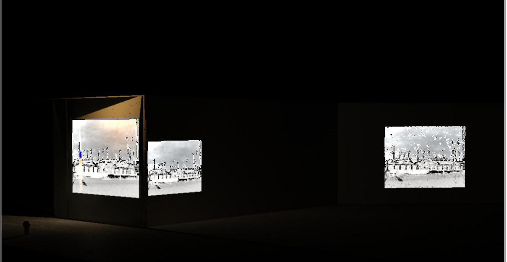

k so i've been messing with this for a couple hours now working with lighting and what not but nothing i do will allow me to end up with a normal colorful product for a night rendering.
i have multiple decals on glass and cmu, i can get it to see the image but its black and white, almost like its to bright but when i try lowering certain levels it doesn't help...any ideas?
 heres a couple examples of what i'm getting: one with interior light only, one with interior and an exterior spot light
the farthest left decal is on glass, the other on cmu, and there is a light source behind the one on glass.
Edited on: Wed, Apr 7, 2010 at 5:29:02 PM

well i've pretty much exhausted all of my revit knowledge over the past couple weeks...so if anyone has any ideas/ways to make a decal like the ones i previously attached look like a tv screen for the outside of the building...it would be such a big bonus to have a exterior night rendering showing the designed video facade panels

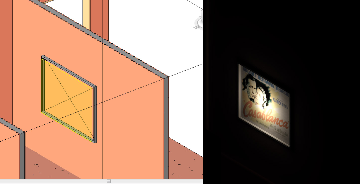

 If I were in your shoes, I would make a new family of light source.  In lighting families, the light source isn't actually an object--it's an emphemeral shape you add, which has a direction it's pointing.  When you model the bulb, you have a "light-emitting" material, which at best defies shadows, but doesn't illuminate anything but itself.
  So, to get to the point, what I would do is create a wall-based light fixture family with a rectangular inward-facing light source the size of your screen, and place this light source an inch or two from your decal.
your light fixture doesn't need any physical parts, not even a plane of glass--though by default light sources aren't visibile in VG, so you'd have to turn that on to see/manipulate it in your model.
In properties I toned down the intensity of the light too.
 out of curiosity I modeled this.  It seems to work.  Here's the screenshot of it rendered and in shaded view.  this is 2010, but I don't think they've made changes in this department.
