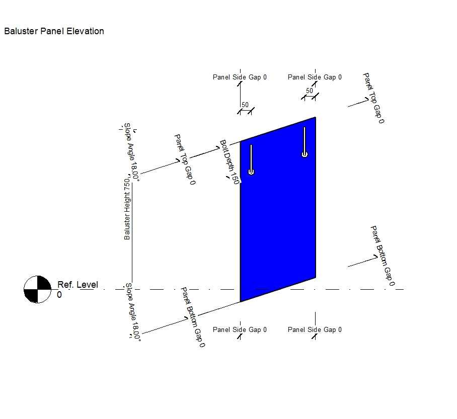

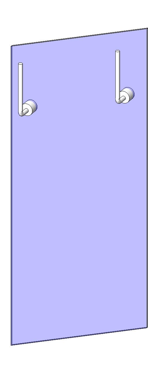

Hi Everybody,
I am slowly getting my head around families but have been stuck on this frustrating problem. As you can hopefully see from the 3rd image the vert. baluster connectors along the floor are ok and run parallel to the railing but the balusters along the stairs are also level but i would lke them to run parallel to the railing above them. i have been trying in the family editor to lock the connectors to the sloped reference plane but cannot because of the shape of them. Does anyone have any ideas on how to constrain them? I would really appreciate some feedback or tips.
Thanks in Advance Guys.

Can you put here that baluster so we can take a look and give you the correct answer?

Hey Typhoon,
Thanks for response, as requested here is attached baluster file. (revit 2009)

Here you have, a video and the Family: http://www.megaupload.com/?d=GH19ASLK

Hey Typhoon,
thanks very much for reposting the rfa file but I really appreciate the time you took to make video.
Exactly what i was asking and easy to understand!!!
Once again I really appreciate it.
