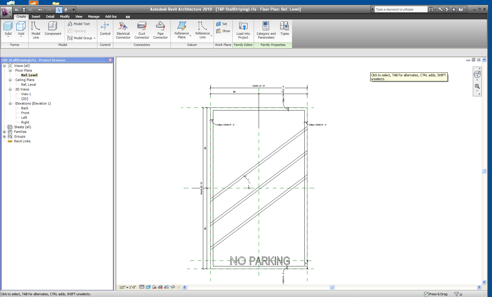

Hi, I am trying to make a stall with striping on a 45 angle. I think I got the parameters set for the depth and width, and for the visibility for the no parking lettering. Does any one know how to make the extrusions at 45 angle to adjust to the shape of the stall (width and depth).. I tried making an array but then u have to input the number of stripes u want and plus they don't adjust to the rectangle....
appreciate any Help!!
I have attached an image.... and I am on 2010 Revit
Tue, Apr 6, 2010 at 11:17:23 AM | Parametric Stall
The families guide will help you with parametric angles.  Look at the Help pull down and it will lead you to the families guide.
