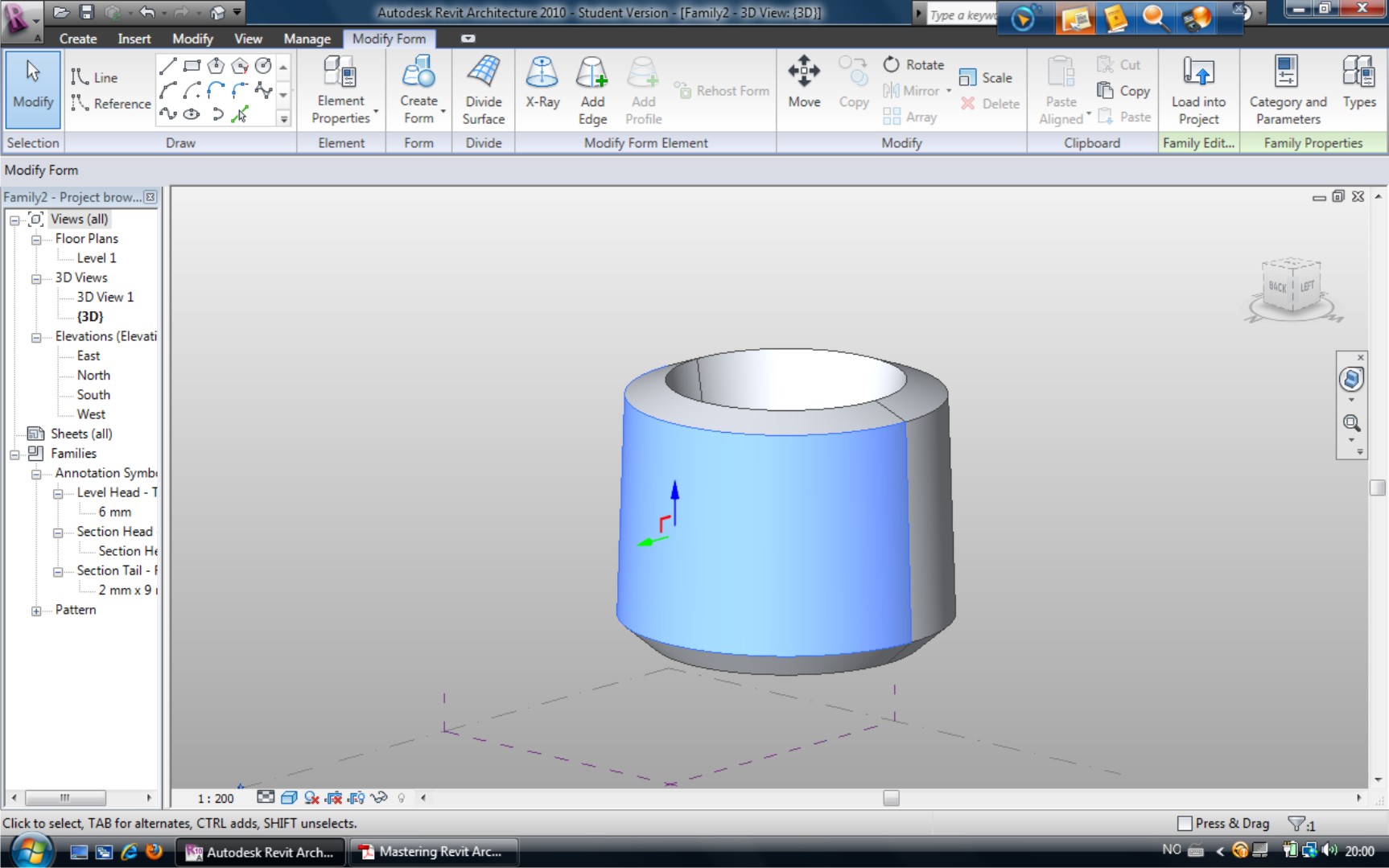

Dear friends
When I finished a *blend sweep form*, and would like to modify the divided surface, I noticed that the form was divided into 2 surfaces.
Thus if I continued to apply my own element type to these 2 surfaces, the borderlines could not be jointed.
How can I solve this problem?
(Please see the picture)
Thank you very much

Hi again
In this form, the surface was even divided into 6 parts.
How can I make them as 1 surface to edit or to apply the element type?
Thank you very much.

Oj
It's 8 parts, not just 6 parts.....

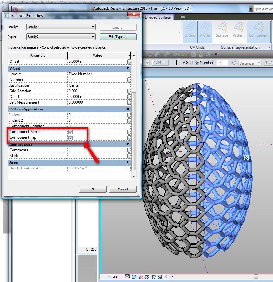

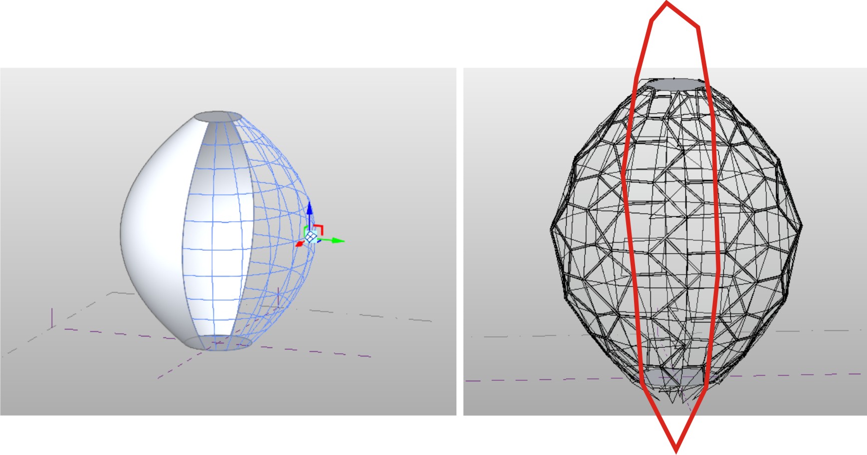

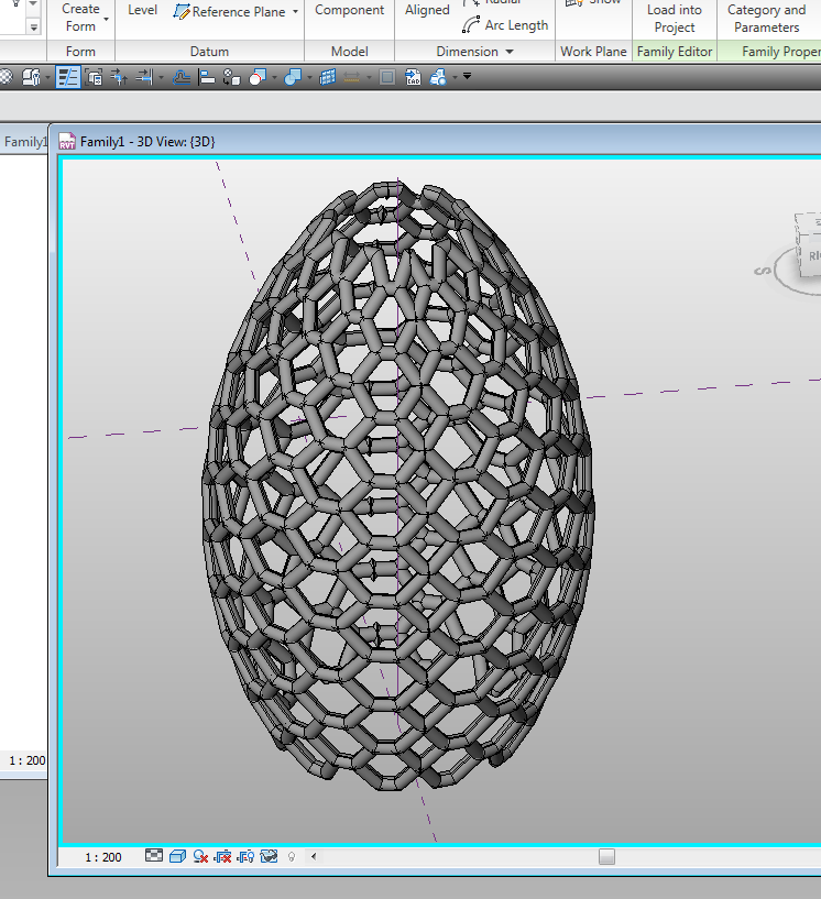

Try to play with those parameters... see the images
