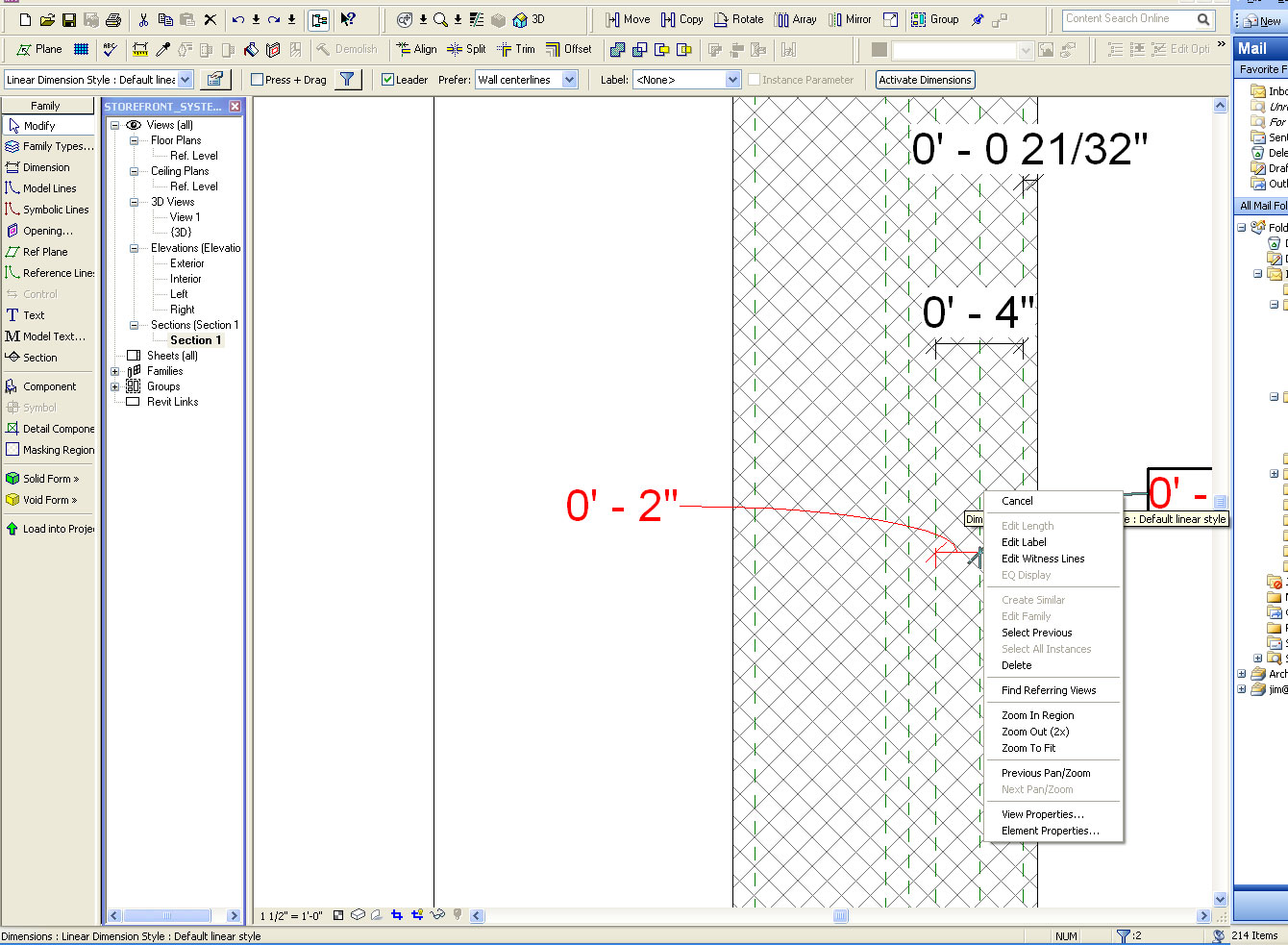

Sure, here it is with the right click ment showing that option not available.

I have a dimension of 4" whith a reference plane that will divide it equally into (2) 2" sections.  I want the dimension to display the EQ symbol so I can add a parameter to it.  In the drop down menu you can see that the item for that is greyed out and is not available.  Is this a high level option I can set?
I reshot the image to make it easier to see.

You have TWO different dim. on that, you create one and stop, then you create the other, that's why don't appear the EQ symbol...

Ah Ha!!!!.
 Thanks
Radial dimensions won't display but linear will?
