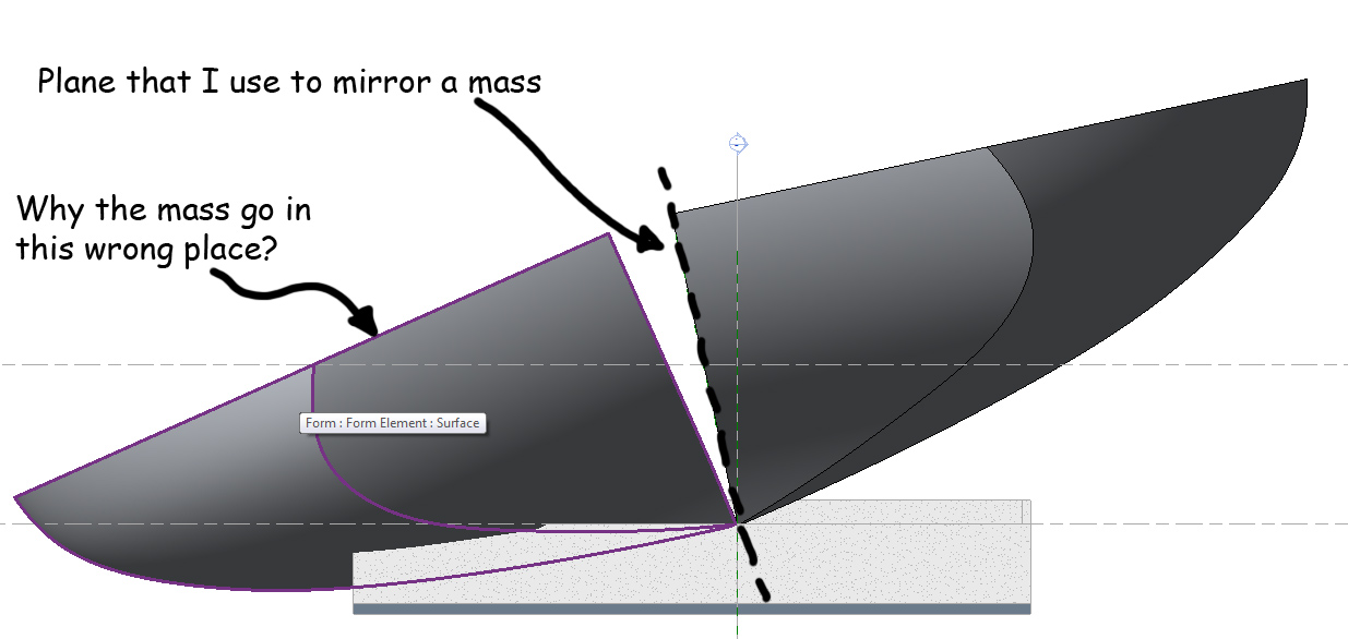

At the moment  I have a big problem in working with mass. I have to model a boat, and I have thought that maybe is better if I made and modify only half boat of that and after using mirror I can made the other part (Because I'm going to modify this boat many time to find a right form).
Together to the modelling I have to rotate the boat and my problem is here. After the rotation, if I try to mirror the mass using the same plane that was rotated together to the mass, the mass was mirrored in the wrong place (I have put a Photo to explain).
What can I do? The way to work is right? Anybody can help me?

Can anybody help me??? Because I can't really do what I want without to solve this problem..
Maybe I didn't explain well my problem.. If anybody didn't understand please tell me..

see the video: http://www.megaupload.com/?d=C7OO74TR

Hi, sure you have solved my problem.. thanks you a lot..
