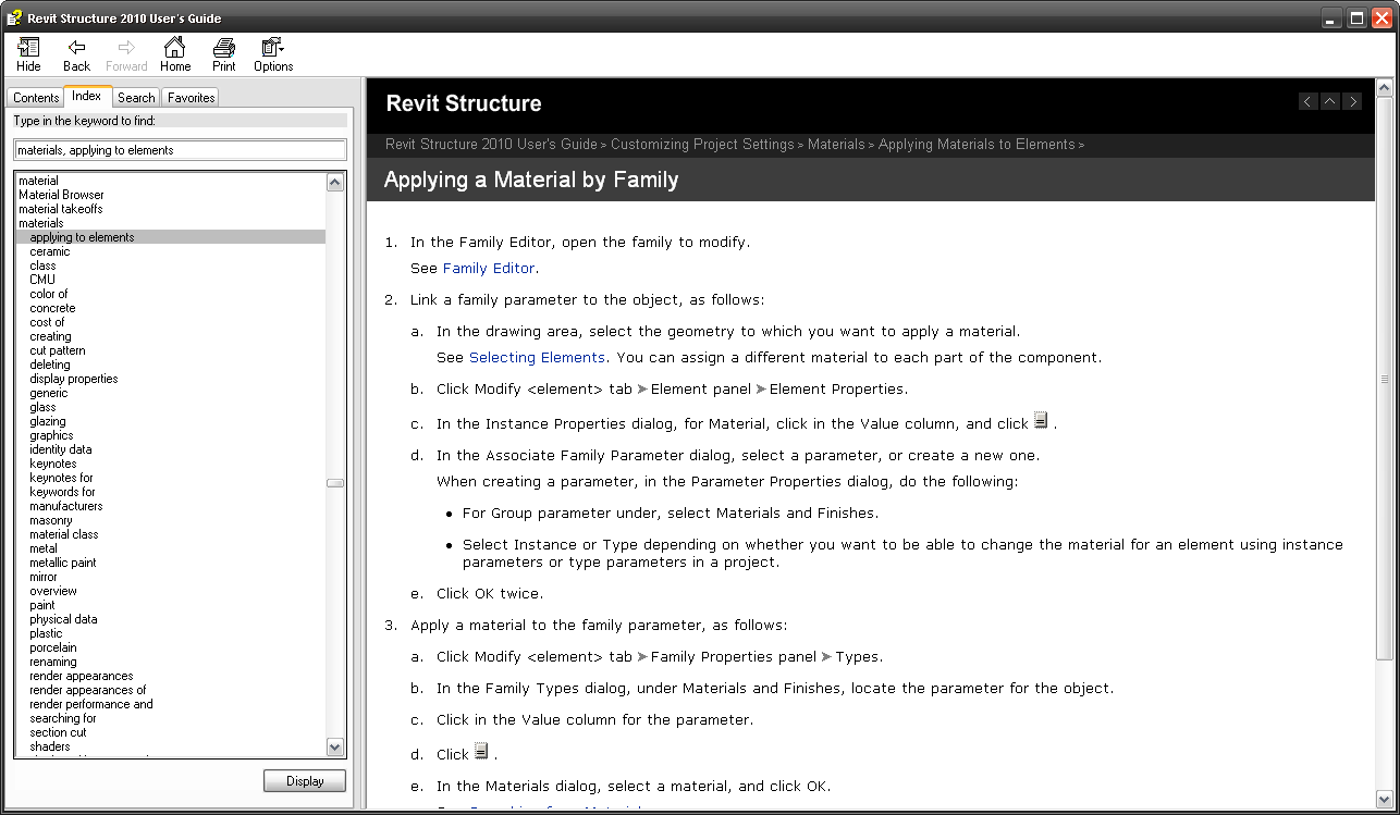

Press F1

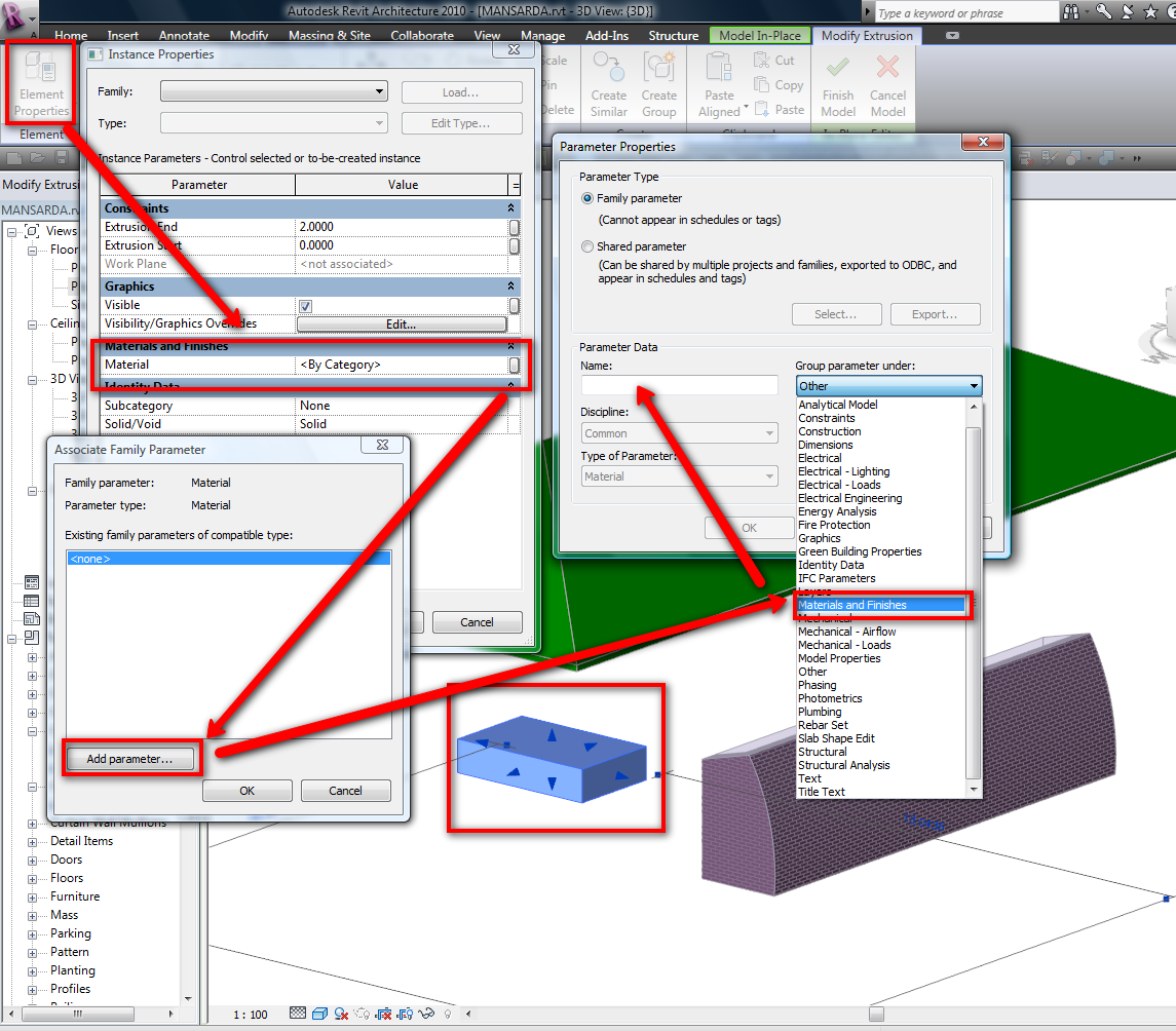

Wed, Mar 17, 2010 at 2:49:20 PM | Family
Joined: Tue, May 22, 2007
5921 Posts
4 Stars: 205 Votes
Just follow the arrows.....

"Press F1"
Thanks.
Wed, Mar 17, 2010 at 5:32:33 PM | Family
Oak3s
Joined: Tue, Sep 4, 2007
18 Posts
Typhoon - your image is very F1-ful. Thank you.
