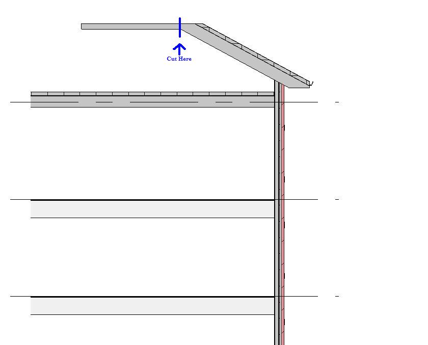

Hello,
I was wondering if there was a way to cut a roof after setting a roof cutoff.  Right now the roof has a leftover horizontal piece extending across to the back of the original roof.  I was wondering if there was a way to cut this off.  See the attached image.

Those lines must exist, they aren't in CUT but in Projection, if you don't want to see them just use the "Masking Region" tool with invisible lines...

Well I don't just want to cover them up by drafting over them, I actually want the model piece to be cut.  Maybe this image would help, the cut is actually cut horizontally.  I want another vertical cut so that in plan these lines will disappear and also in section the roof would be cut straight down.

I just create that roof by footprint like you can see and i didn't need to use the Cutoff offset to create that roof....

Awesome! We didn't have a roof plan, but worked with floor plans and elevations- so we needed to keep the same roof slope, but drafting over the back lines and recreating the roof worked.  Thanks!
