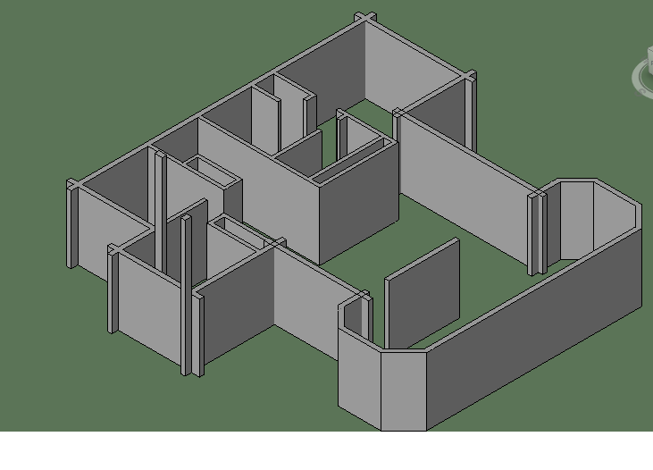

For anyone saying look below at similar threads, I already did that, and I still have no idea how to do any of the stuff. I am a COMPLETE newbie at Revit and I have only used it to design very basic houses with generic B&w walls. All I want to do it make my design look like a log cabin. The walls are my particularly challenging part. The basic wall layout of my hosue is below. How can I use this "sweeps" feature as I have seen on every thread so far? I am using REVIT Arch 2010.

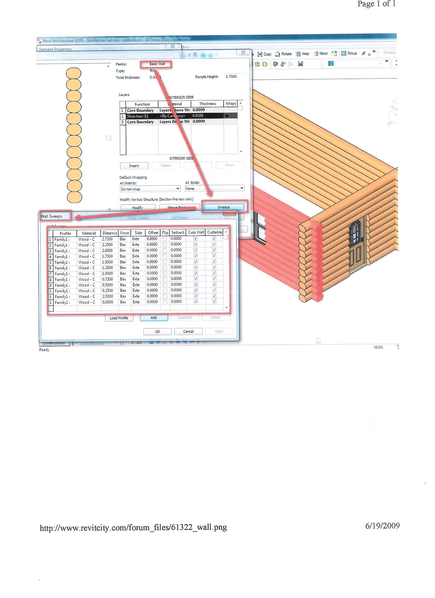

Sorry about the scan I downloaded this technique many months ago and can no longer find it on the site. Use the sweeps menu to build your wall type. I think it looks pretty good. Hope it is readable.
