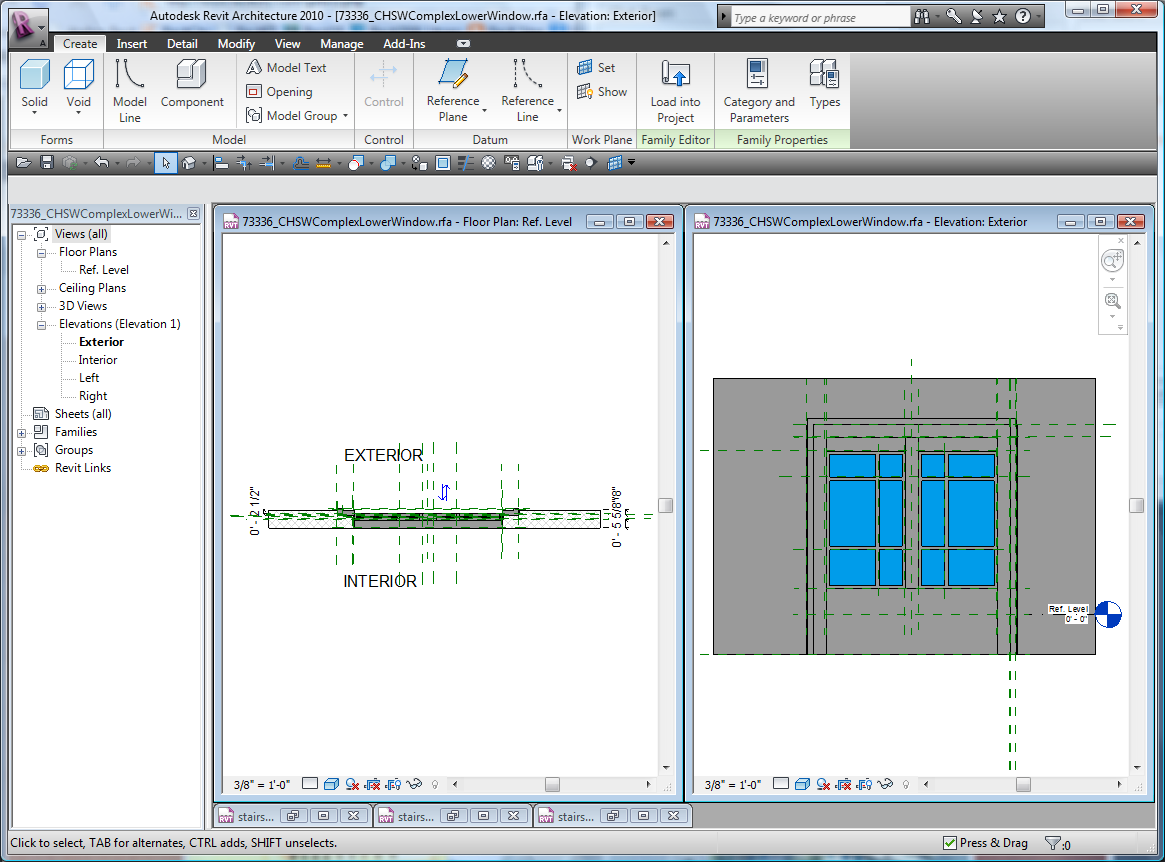

Someone in our office has modeled a complex window family where the initial opening in the template is deleted and several voids are extruded to cut through the various materials in the wall (i.e. brick opening, core opening, finish opening).   When loaded into the project, the window does not appear correctly in plan.  It seems as is the voids are blocking all of the solid extrusions.  This window was modeled according to a "How to" revit article.  All steps were followed.  Why is the window not appearing correctly in plan?

Sorry. I forgot to attach the family.  You will see that it looks ok in plan in the family.  It only views incorrectly when loaded into a project.

 "This window was modeled according to a "How to" revit article.  All steps were followed.  Why is the window not appearing correctly in plan?"
WHAT??? are jokking right? You don't have any Dimension or Parameter in this window... How do you want to control THIS window in the project? The unique dimensions that appear are the "Automatic Sketch Dimensions"...

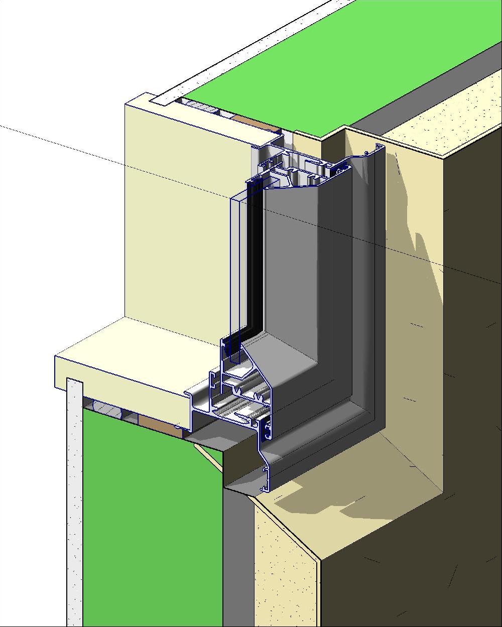

You mean a complex window families like the attached images? Typhoon is right, you need a series of parameters driving the thickness of the internal/external claddings that can be either instance or type based.
And the reason you use void sweeps/extrusions rather than openings is due to the fact that you can only have one opening OR many voids cutting the wall, not both.
