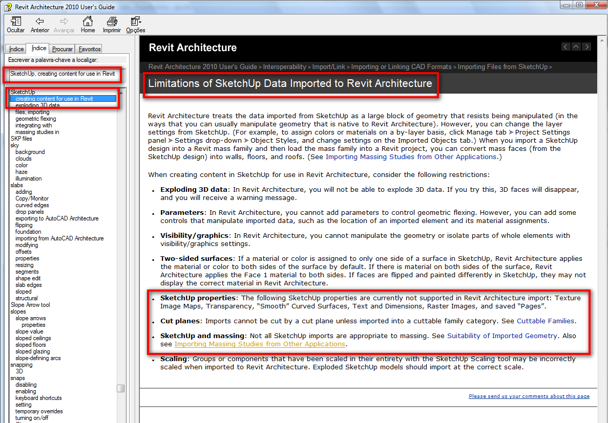

I need to use a Sketch-Up model as a background for my Revit 2010 model.  I can import the file by Insert>Import CAD or Insert>Link CAD but I can't cut sections or view it in plan.  I tried to insert it as a mass by Massing & Site>In-Place Mass> then Import CAD or Link CAD, but I can Finish Mass. (Error message - This family instance has too many edges and faces. Remove unnecessary geometry or split the instance into multiple instances.)  Any ideas?

Quincer, look in your HELP menu what you can do and what you CAN'T do with SketchUp files...
