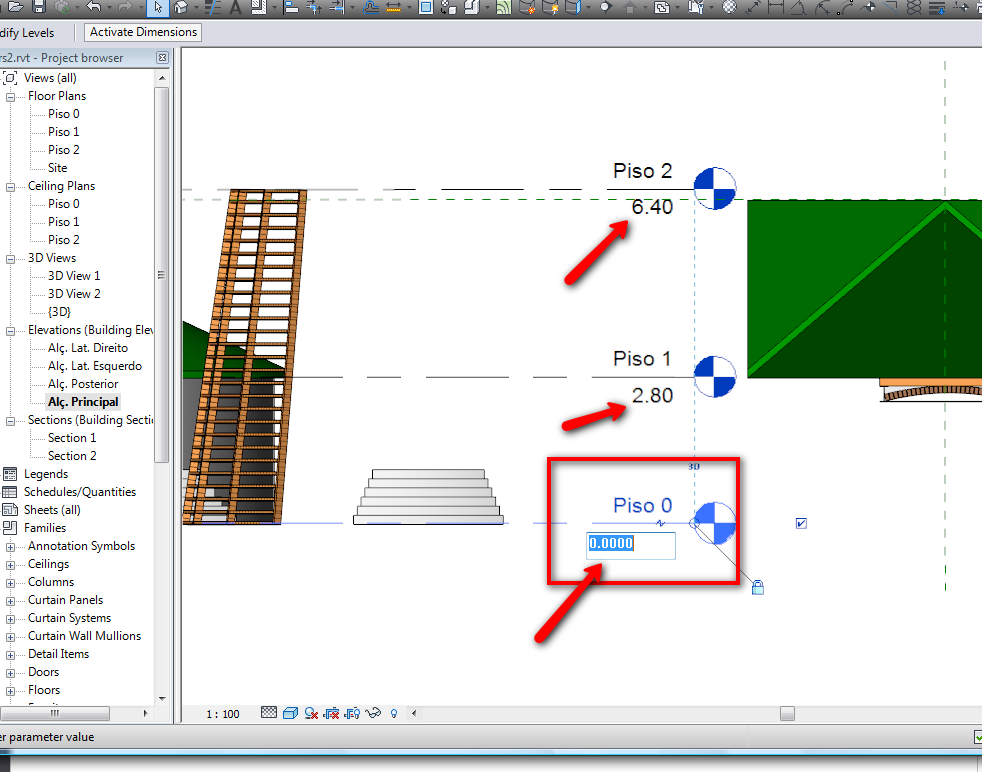

I have tried moving levels in Revit Architecture 2010 and some levels will move independently and others move levels with them.  I have opened all views and made sure there aren't dimensions linking levels together.  I need to move each level to different heights individually...

In a elevation/section view, you can pick and change the elevation (Z) of your levels.

I have tried that numerous times, and the problem is not that the levels won't move, it is that the levels move together, and I need each level to move individually.
Thu, Feb 25, 2010 at 1:24:35 PM | Moving Floor Levels Independently
Ah but your levels were linked together....
To Fix This... Add a dimension level to level then lock each one then unlock each one.  If a locked dimension is deleted, the dimensiuon is deleted but the lock remains.

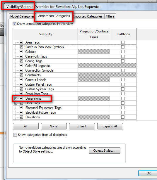

Are you sure you don't have locked the some levels? In your elevation view check in VG>Annotation Category>Dimensions and see if the "Dimensions" are turned ON.

WW hub, you ROCK!
