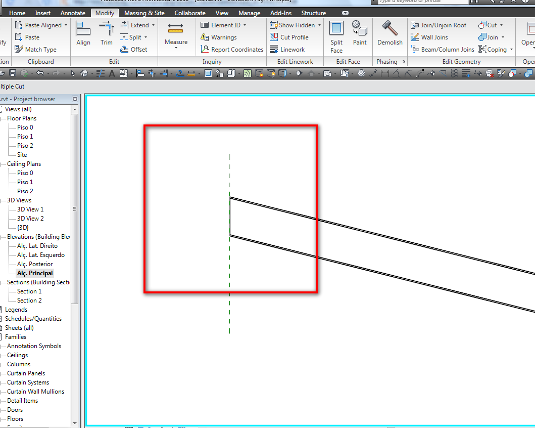

I have some steeply sloping W18x35's at the roof and I need the ends to be vertical.  How do I do it?

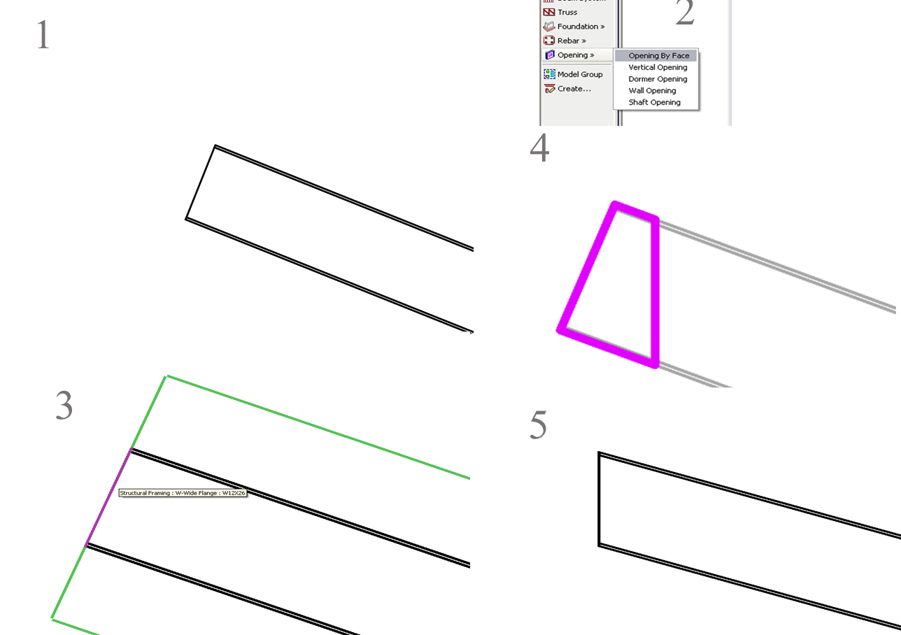

I think I would have gone with the "Opening By Face" command instead...a lot less complicated and requires less RAM allocation.
See attached image.

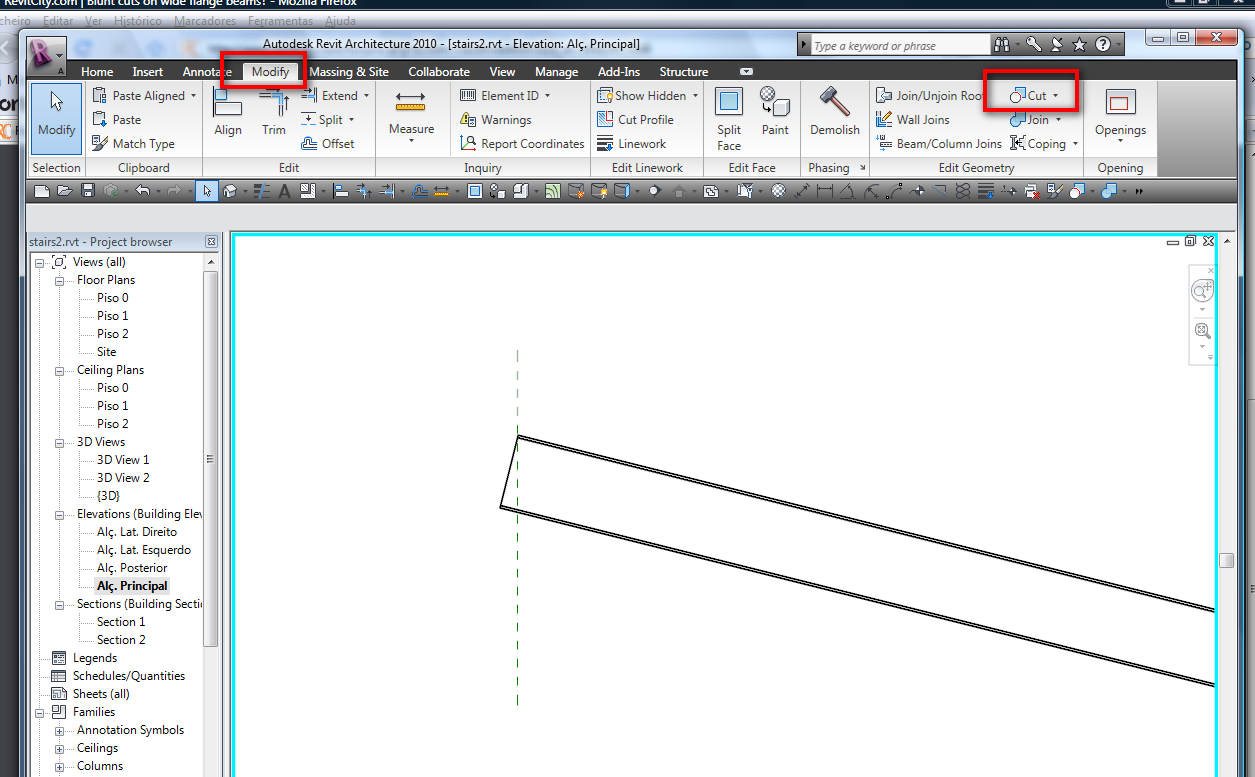

Why don't you just use the "Cut" tool with a "Ref. Plane"?

That is an excellent recommendation Ty!
The only reason I do not use that method is to avoid having any more workplanes in my model, named or otherwise...
One large benefit to Ty's suggestion is that if the slope of the beam changes, the cut stays vertical
