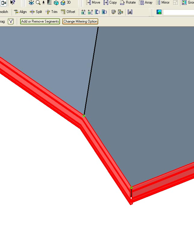

I'm having trouble with some fascia that wont miter properly. I was looking through the Revit help file and came across this: "Select an existing fascia and from the Options Bar, click Change Miter Options." Unless there is an option bar that is not visible be default, I can't see any button that says "Change Miter Options" when I have a fascia selected. I'm using Revit 8.0 build: 20050620_2300

Change Mitre options button only appears if you have fascias that are located on different work planes in the one sketch... Refer attached image.
