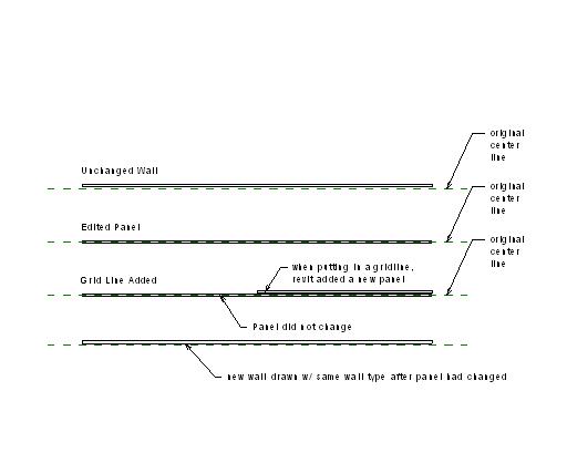

I would like to draw a Storefront wall w/ the glass in the middle of the wall and only 1/2" to 1/4" thick. Revit's default is 1" thick and it offsets the panel / glass from the middle of the wall. Is there a wall to change this setting? or do i have to manually change each Glass / Panel indiviually?

The panel thickness and offset from the center of the wall are properties of the curtain panel type itself. Hightlight a curtain wall panel (tabbing helps), then either change the properties you desire or duplicate and create a new type with the properties you want. HTH Tom

I've done that and that only changes that particular panel. If I try to put in grid lines or draw another curtain wall after that, it goes back to the original settings.

Make sure you are editing the "type" parameters of the panel. Tom

Ok, that was the step i was leaving out. i had edited the wall and not the properties. thanks.
