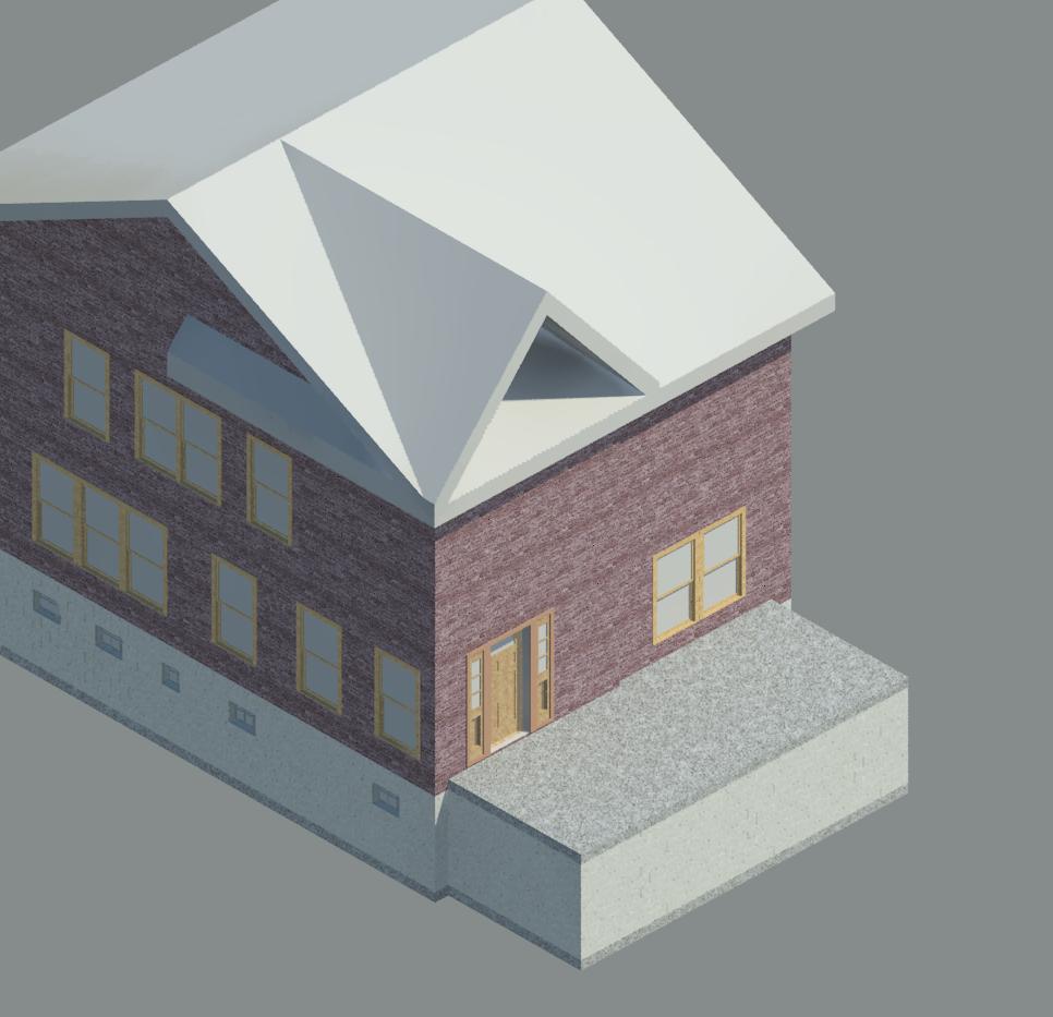

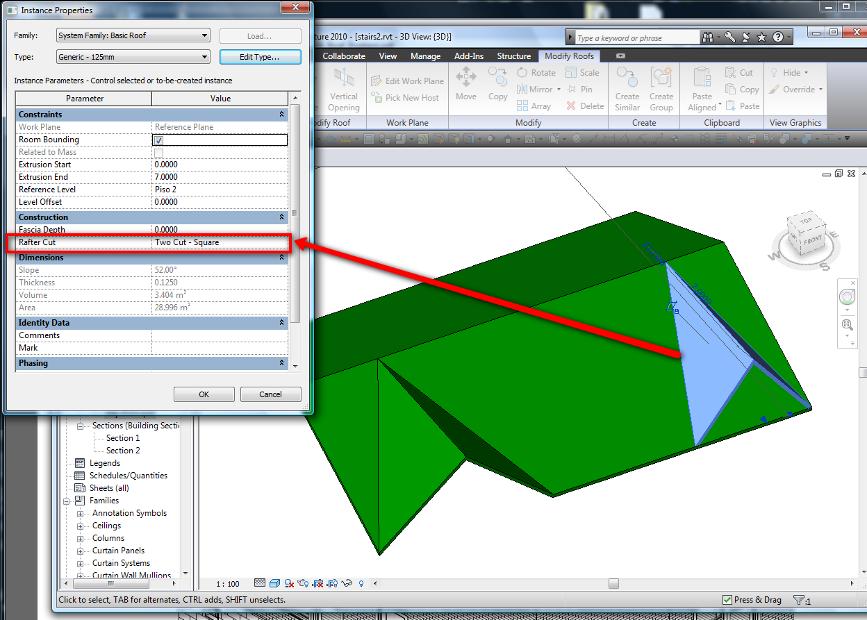

I am trying to join two roofs. One has a pitch of 6/12 and the other of 14/12. I can create both of them fine but can't seem to join them. I have tried using the Join roofs command but they don't create a seam between them. I have included a picture for reference. Any help would be appreciated. Thanks.

You'll probably have to do some manual cutting using vertical openings if the roofs won't join

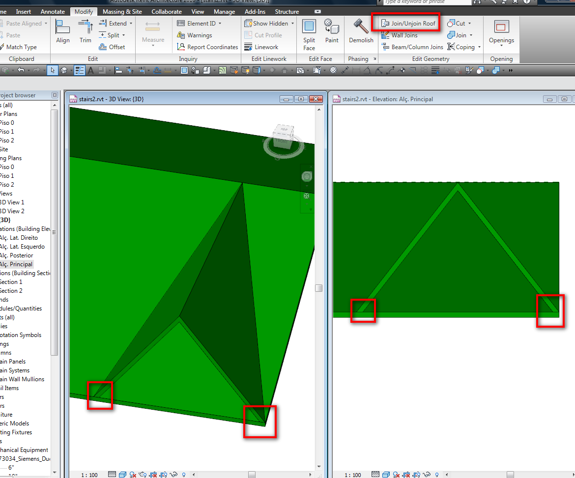

Pick in that small roof, go to properties, change the "Rafter Cut" to "Two Cut - Square" then use the "Join/Unjoin Roof" tool....
Check the image attached.

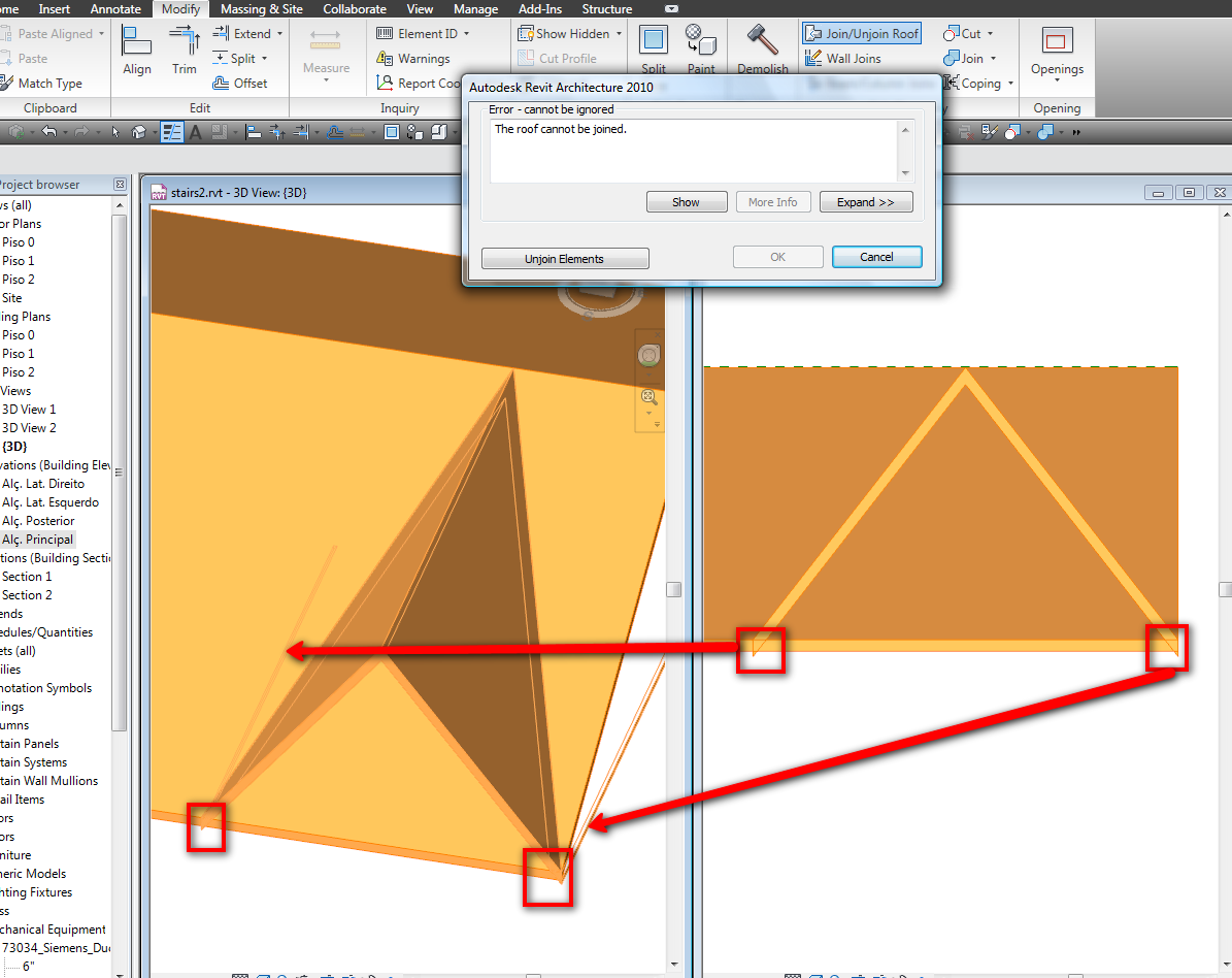

I have tried cutting opening and changing it to square plumb but I still get the error message that they can not be joined.

That's the Error? so... that's the problem.....

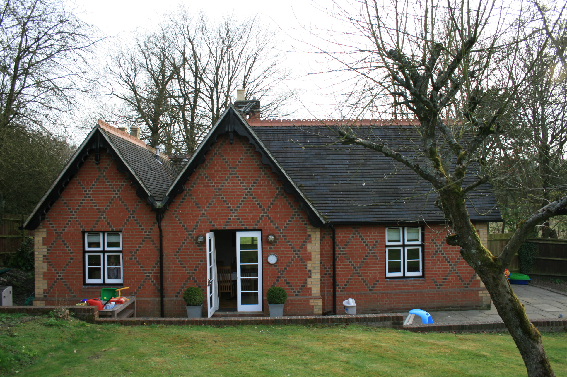

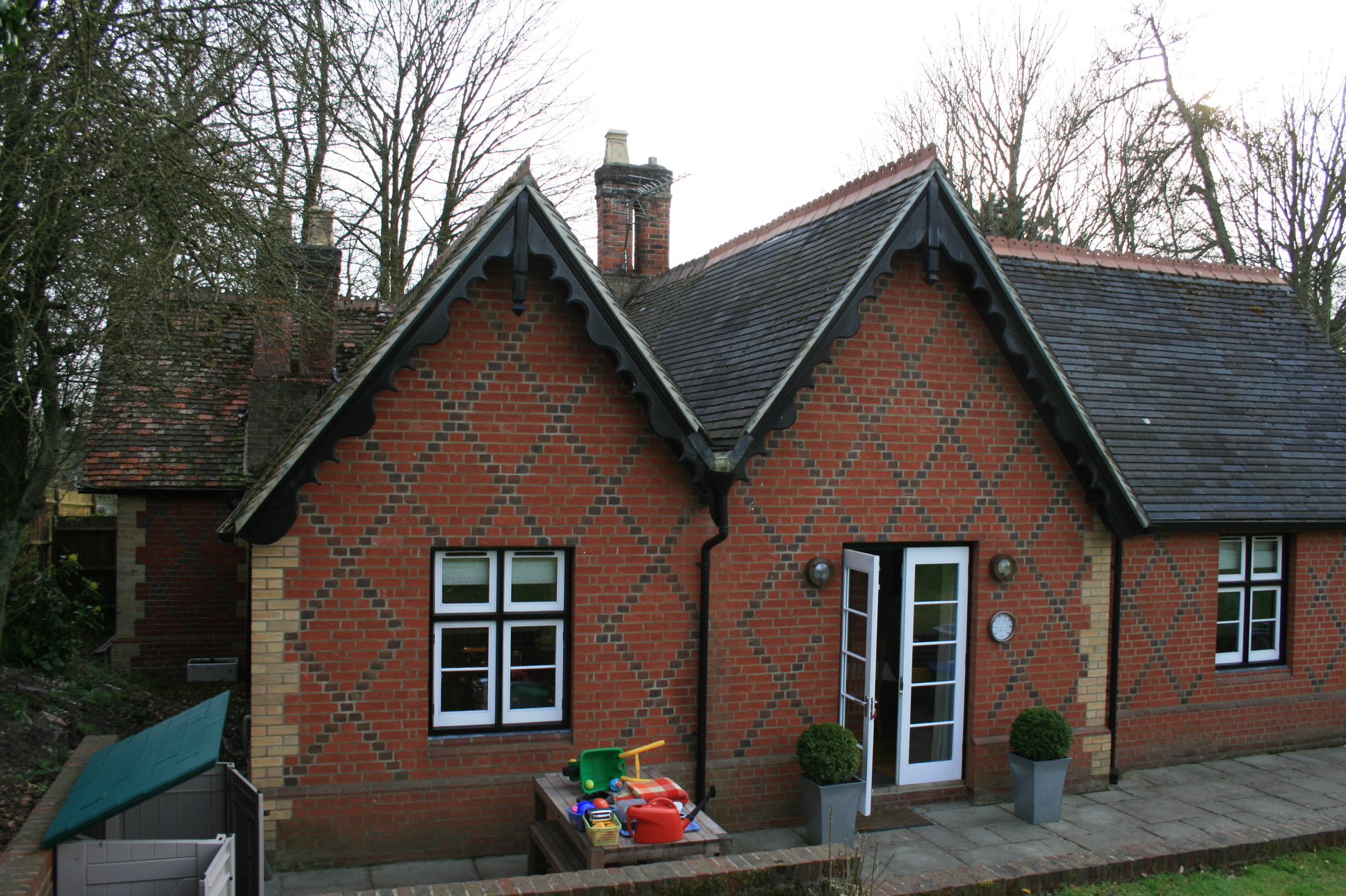

Hey guys i need some help.
 I need to build a roof that looks like this photo.. is there a way to build a double pitched roof. I have tried to join to seperate roofs but with no success. I have also tried to draw the roof with a valley but did not work. I hope some one can help me as I need a solution fast.
Wed, Apr 28, 2010 at 4:30:54 PM | Roof problems with 2 gable roofs with different pitches.
egoled
Joined: Sun, May 31, 2009
16 Posts
Also it would be helpful if any one had ideas with how to replicate the brickwork

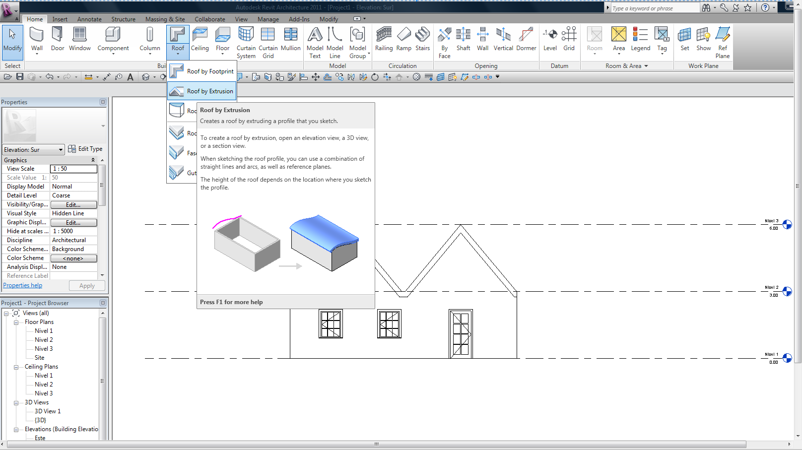

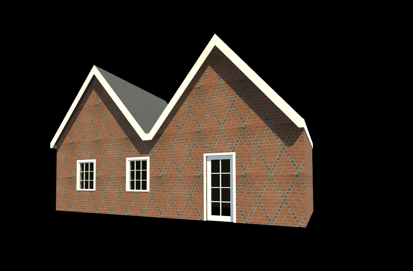

You can use Roof by Extrusion and an image for the brick work.....

erland
 Thanks realy appreciate that thanks... thanks for the quick response
