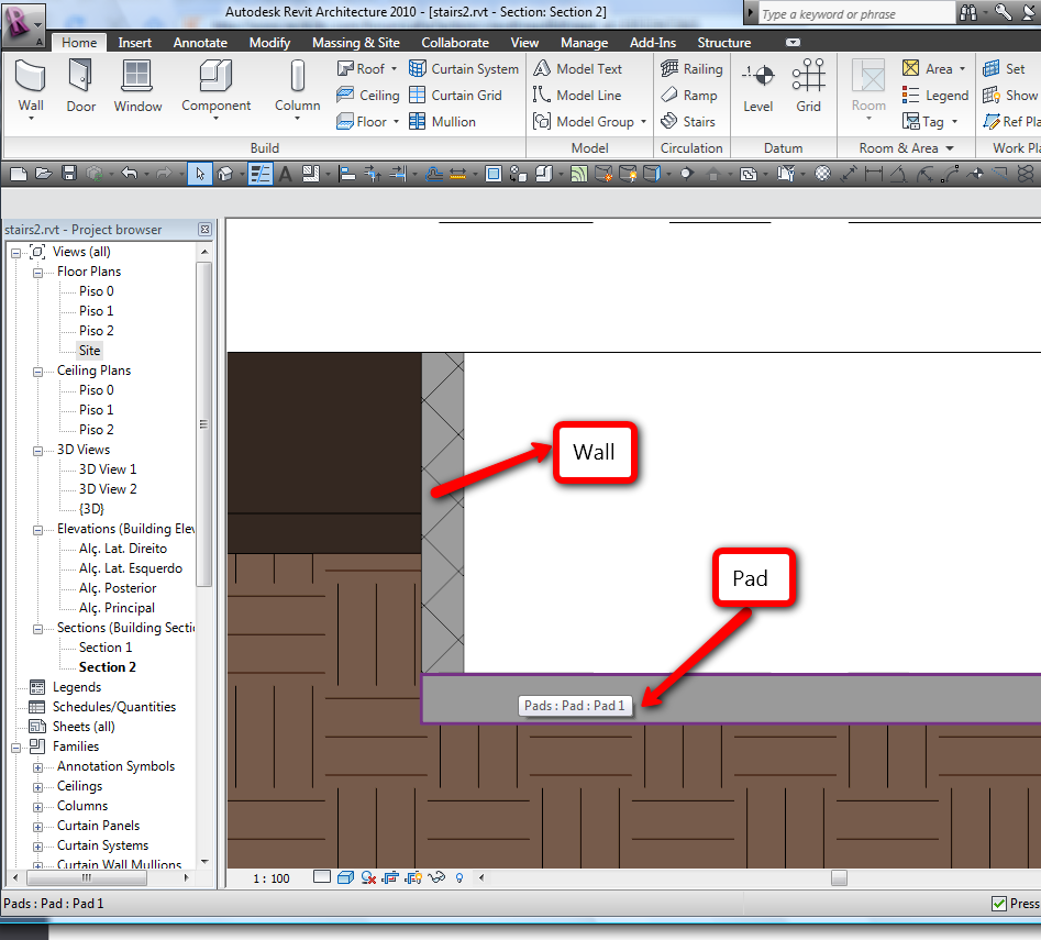

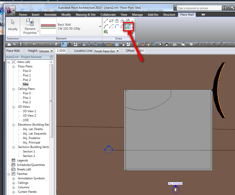

"pick line tool will allow me to choose model lines, col center lines, model faces, other walls, just not the edge of a pad. any pad when i am in a plan view - even on the same layer as said pad." - "...to clarify, i am referring to using the pick line tool in a plan view, not default 3d." - Sorry but Yes you can, see the video: http://screencast.com/t/YzkyNTI0
