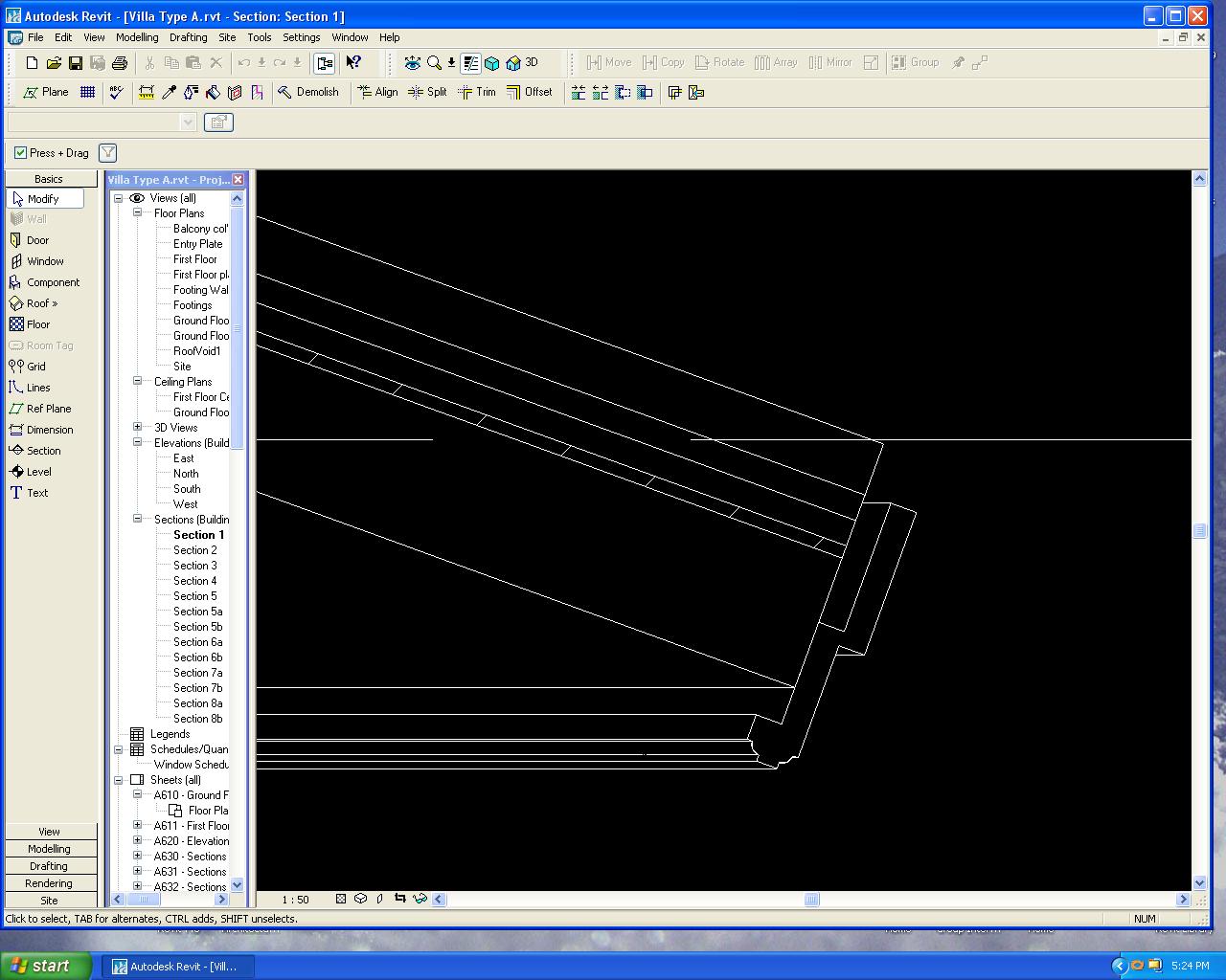

Hi All, I have attached an image of a fascia that I am working on. You can see the fascia as a two piece unit. I have shown the roof structure as well by setting the visibilty to fine. How do I extend the end of the top layer only on this roof (the roof sheeting) to extend beyond the fascia line? cadjockey

add the extension as a special fascia type then join it to the roof to remove the line (providing its the same material)

Hi Mr Spot, I tried that. It didn't work. I'll try again. However, I did create a void sweep at the roof edge to cut it to the profile I need. How do you re-use the void sweep you created in another location? I do not want to create the same profile each time I need to cut a roof edge. cadjockey
