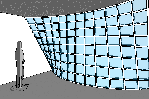

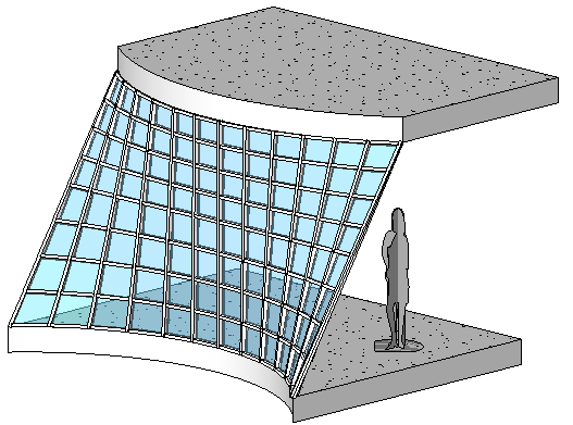

Here's the new way to create a 'Curtain System by Lines' in REVIT Architecture 2010.
In previous versions of REVIT there was a simple straight forward way to create the curtain system as illustrated above by using a tool called 'Curtain System By Lines'.
The first thing we noticed in RAC 2010 is that tool is gone without at trace. Not only is it gone but if you go to the help menu to the 'Where is my Command' tool and search for it you will discover that it does NOT tell you where that command went to. It has been erased from the face of REVIT without a trace or any direction as to the 'NEW' way to do it . . . . . . that is until now of course : )
1. Create a new In-Place Mass Form by picking existing geometry or linework.
2. Turn the linework into a 'Form' and finish the mass.
3. Use the Curtain System by Face tool.
4. Add the Curtain Grids.
5. Add the Mullions.
6. Bob's your Uncle !
