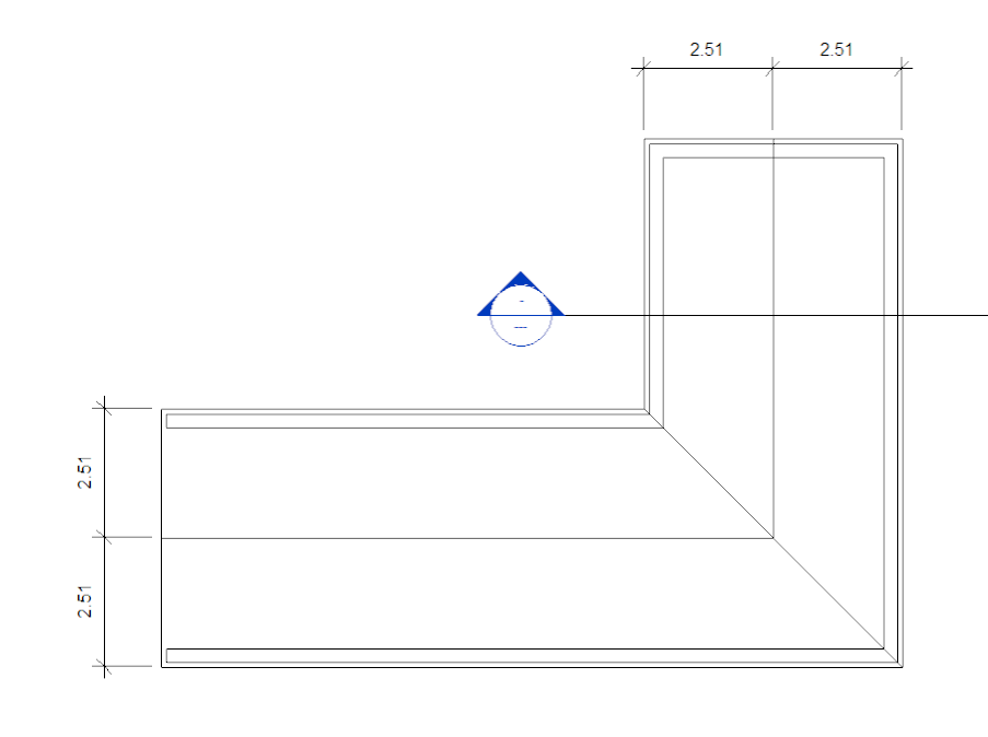

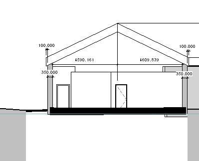

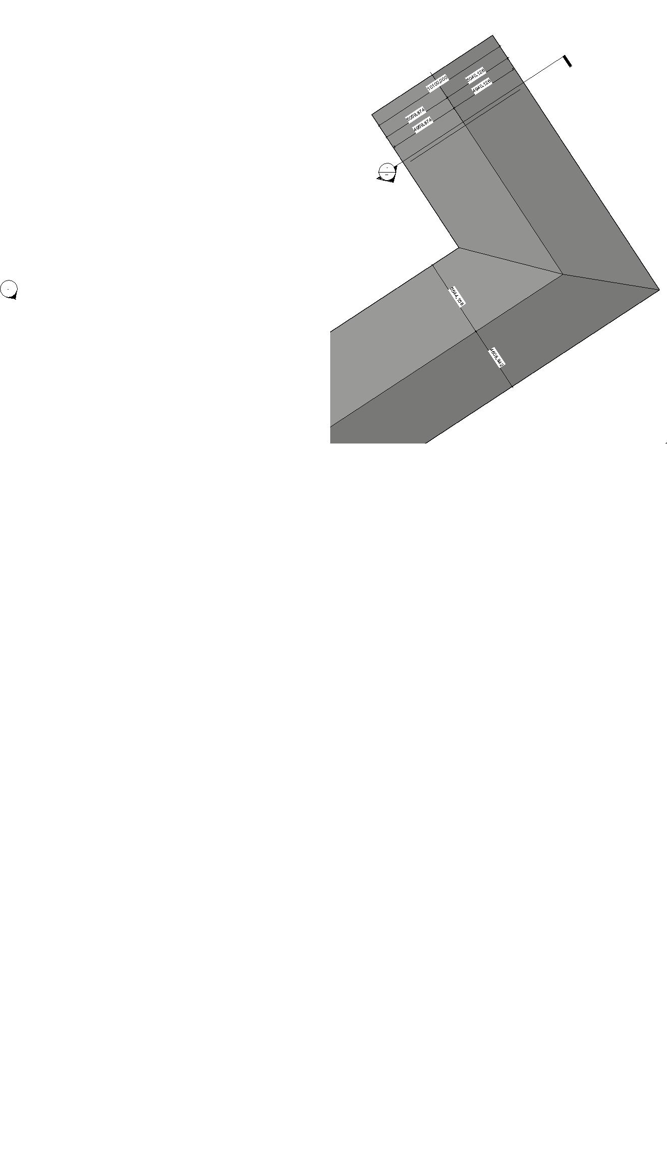

Attached are images below.  My roof ridge line is not centred.  I have checked and the angles are even on both sides, but the ridge has been placed 10mm out
It's negligable really, but I want to know why it's happening as i can't find a reason for it
Images attached

Fixed my own problem
 Even thou the hip is right, the angles main part arn't even, so they threw my ridge line off
when I deleted the main part and kept the NW facing bit, it errors my dims and re-aligned itself
it must of kicked off because of the other angles to align my ridges or something
Ended up making two different roofs instead of the one
