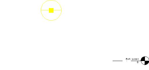

guys, im trying to creat my own light fixture thru creating family lighting fixture then element properties, for material i used default light source..when i render it it didnt glow...how would i be able to create my own light fixture and make it glow? thanks in advance.

Can you enclose the family or an image ?
 If you have wrapped the light fixture (yellow dot in the middle of the light yellow shpere) in any material changes are it won't appear to glow, as it can't shine through a solid object
secondly it might be worth checking your render setting as only when your using 'sun and artifical' or 'atificial only' will it render with your light on

when you make a family chose generic lighting fixture (or similarly names) as a template, and it'll come with two reference evelvations and a centre line, on the second elevation line is you light fixture.Attach a picture of what you've got so far in Shading and edges for me, and ill have a look

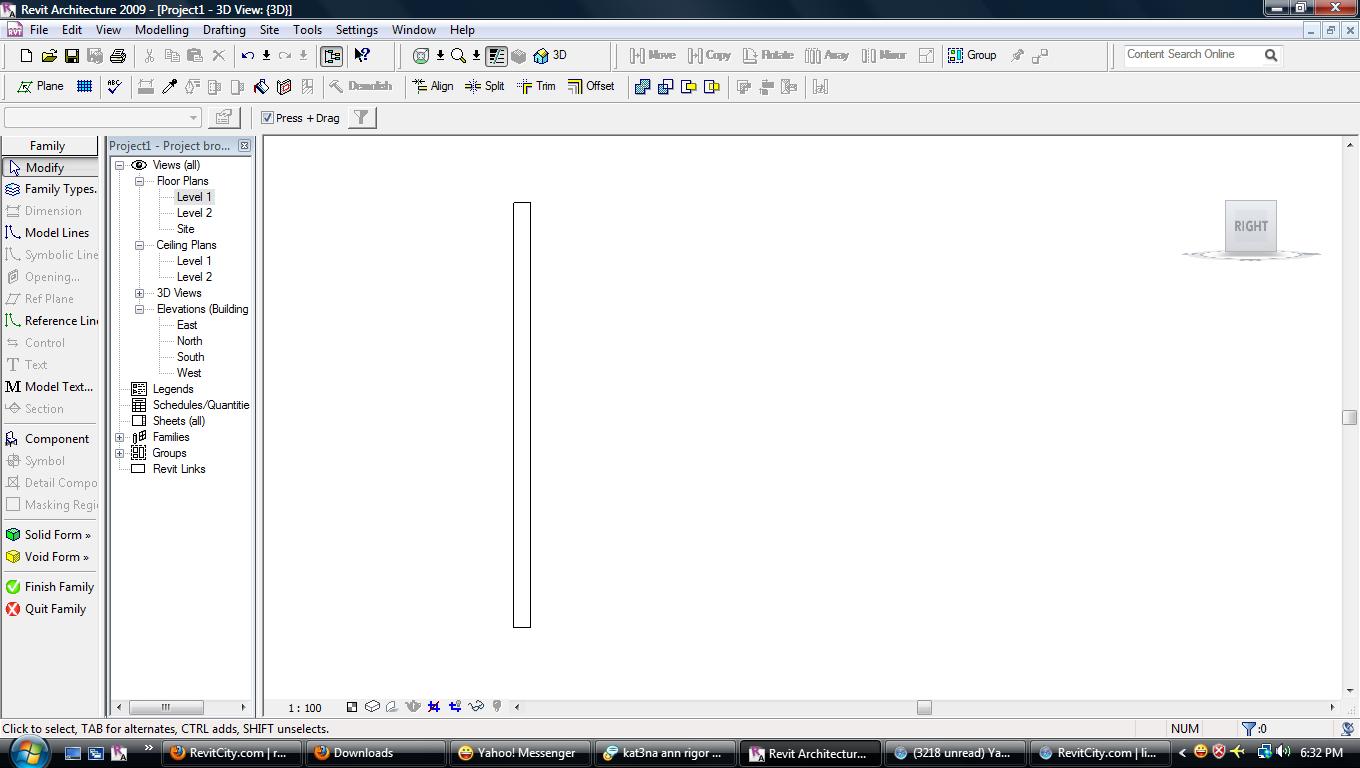

why is there no light source option?, i created it in modelling tab-create-family-light fixture...where can i get the light source(yellow dot)...thanks

 attached are images of what you want
Choose the lighting fixture family, and it appears in elevation as below
using that you can make a light

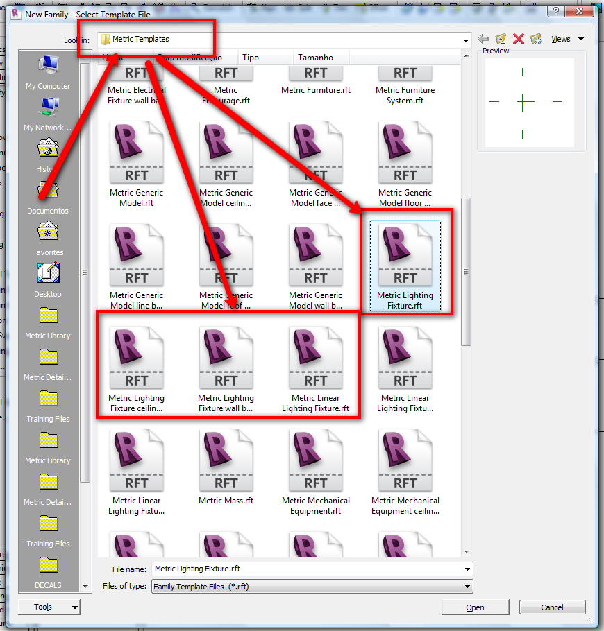

my elevation is empty..no light source like the on your post. am i doing it right? on modelling tab, click on create and select lighting fixture... is that right? this is frustrating.

Quoting 71veedub from 2010-02-16 04:32:43
"why is there no light source option?, i created it in modelling tab-create-family-light fixture...where can i get the light source(yellow dot)...thanks"
You try to create that into the project with a "In-Place" family, don't do that, do like Kardiff said, use a TEMPLATE, go to File>New>Family then in your template folder you can choose what kind of light you want...

71veedub
Joined: Sat, Jan 17, 2009
13 Posts
super thanks typoon!thanks thanks! more power revit!

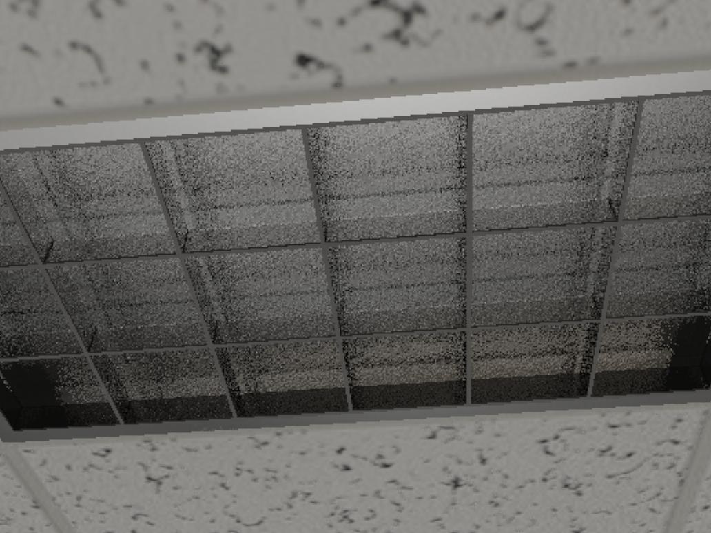

I am having the same problem with revit 2012 with the lights. I have inserted some different light fixtures in this simple mode. The view - 3D View 2 - shows a parabolic lens fixture. However, no light is emmitting from it. Can anyone figure out why?
