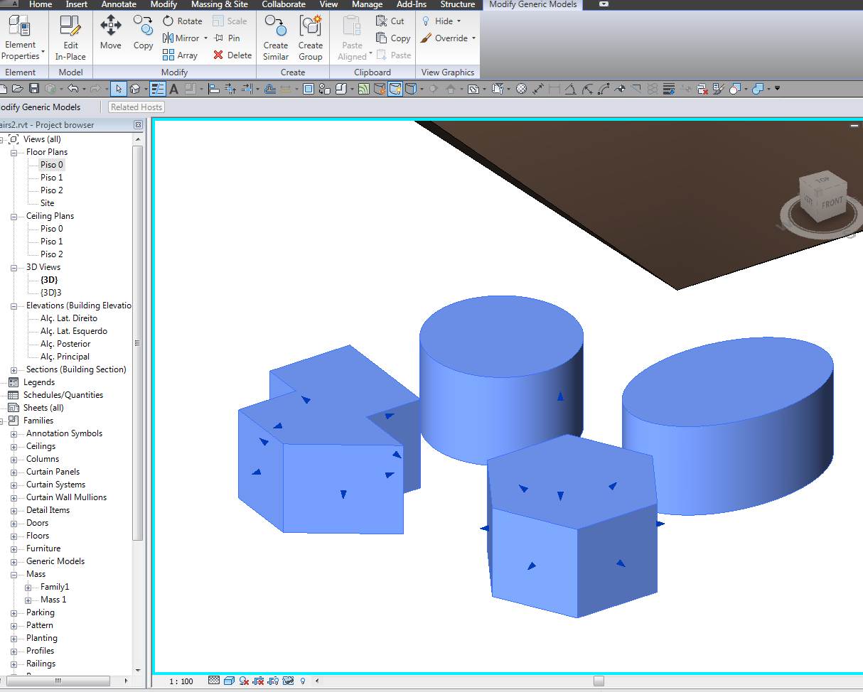

Like what? show me an example! here you have several extrusions made at once in one family...

I trying to extrude them all at the same time, instead of extruding them 1 at a time which is time consuming. I have about 30 extrusion objects, and doing them one at a time, is time consuming. In 2009 I can extrude all in once, with this new modeling thing... I dont have a clue lol... Thanks

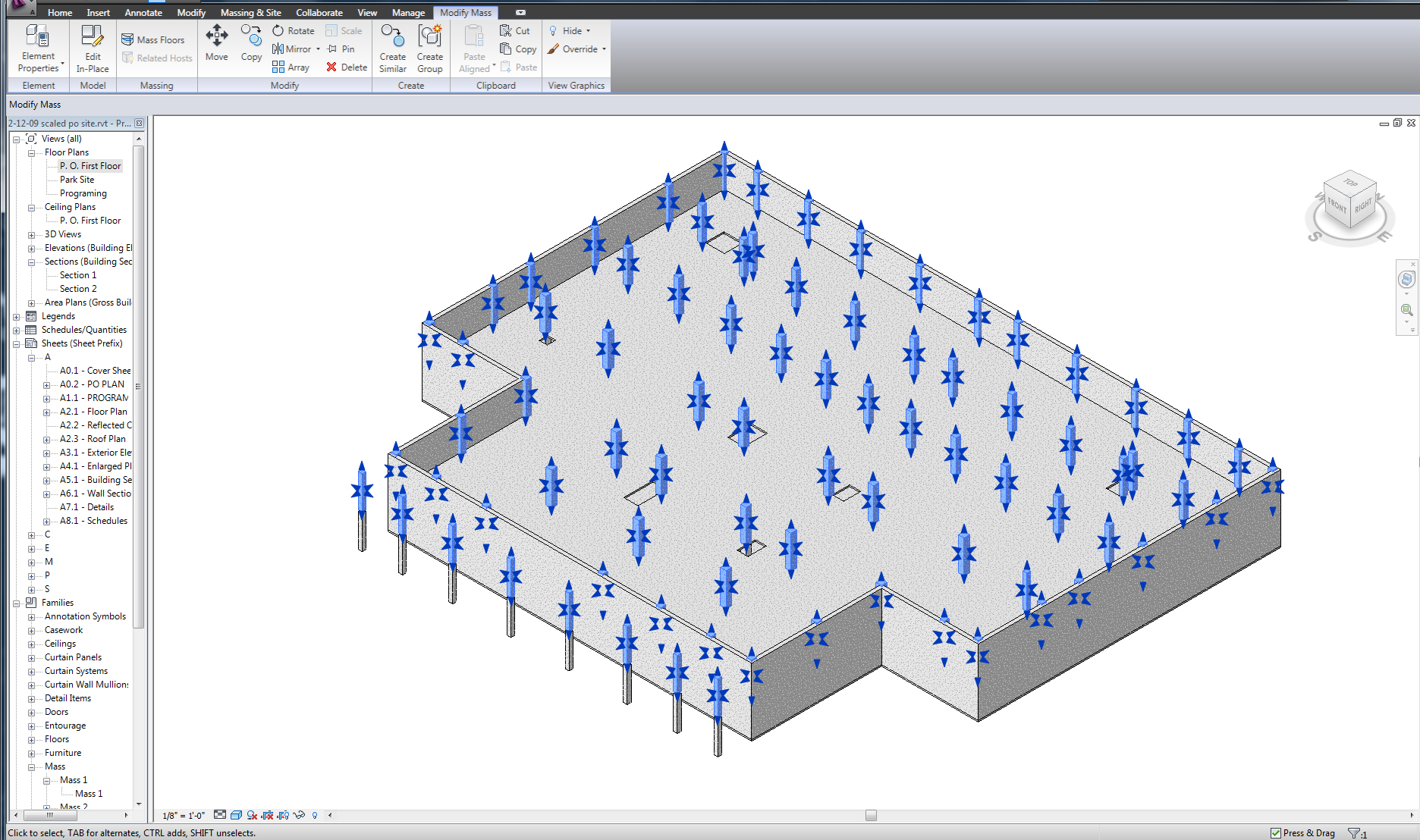

here is an image i am working with... see how each individual one has its own pull... i want to pull them all at once

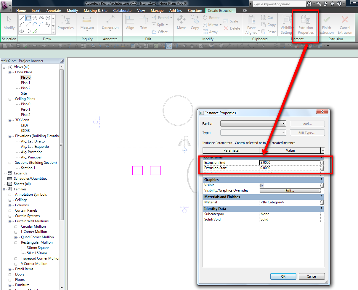

if you made your extrustion on the reference level just highlight them all and set the 'start' and 'end' elevation to the correct distance.If you need to edit width i suggest draw one right and then copy/array all 30

not totally sure whats going on...
 I am in 'Massing & Site'
 Click on 'In-Place Mass'
 I name it.
 I draw all the profiles with the 'Make surface from closed loops'
 I select all, PR, and there is no option for Start or End.

on the ribbon while you draw it where will be an element properties button
the first two options should be extrusion start & extrusion end
also while you draw it in the upper left just below the ribbon it should have a 'depth' figure
use those while you draw your in-place mass

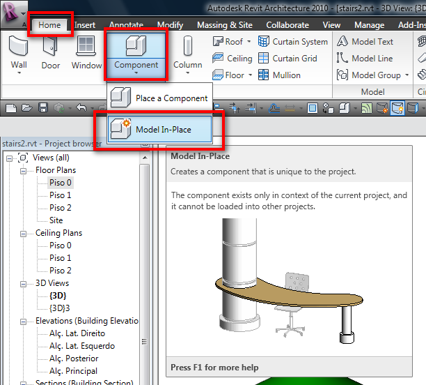

Pamoroso, you are doing that with the "Massing" tool, you have also the "In-Place" tool in Home>Component>Model in-place.. that's what Kardiff is talking about... only use the Massing tool if you want to create wall, roof, floor and curtain system by face, if this is not the case (and i believe so) use the "In-Place"...

oh thank you so much typhoon! i thought they got rid of this feature all together! this is beautiful! thank you so much!
