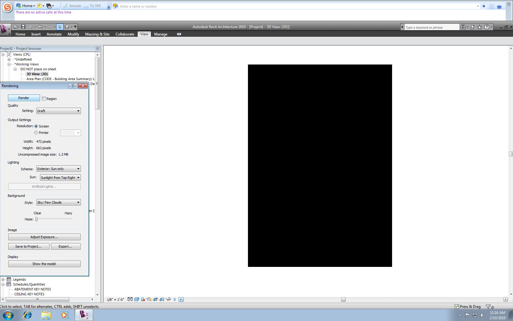

I've installed Revit 2010 Arch on a Dell Precision T5500 with 6GB of ram. I am having trouble rendering models. When trying to render, the render progress window pops up for 3 seconds and then disappears and my model shows up with a black box. Is anyone experiencing this problem?

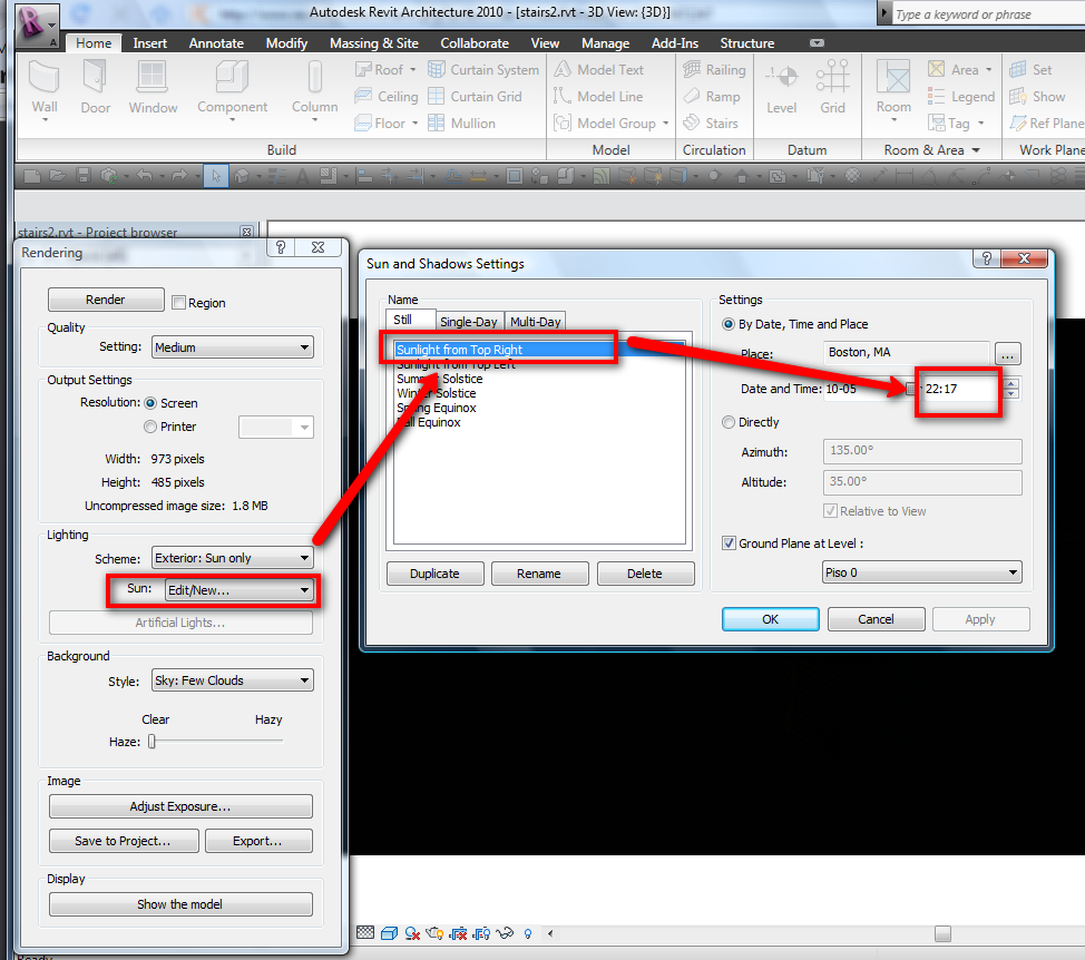

Wierd... One question: did you check the "Sun" parameters?

i changed the sun lighting to what you had configured and the render progress window disappears and my model becomes a black box again.

I didn't told you to change that, i told you to check if you had change the "hour", if you have a night hour it will render black....

i've set it to 1pm in the afternoon and it was still box black.
