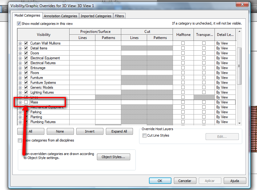

Hello everyone.. I am currently working on mass elements and there are instances when i render an area, my mass elements are missing.. there are materials already added to the elements.. hope to hear from you.. thanks =)

What version of Revit are you working? Anyway, in that view type VG then go to "Mass" and check if is turned on....
