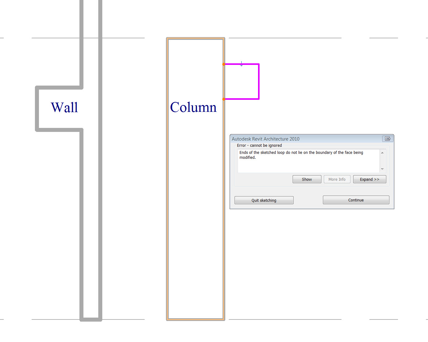

When I use the cut profile I get this error only when I am trying to cut the column.  A wall in the same secton or callout cuts fine.    What am I missing?

I couldn't get the column to Cut Profile seperately but if I place a wall into it, or place a wall and align, it will Cut.  You can place the wall, remove it, then go to section and it will cut.  It must adopt some new characteristics once this is done, but I think it should do it one its own without the workaround.

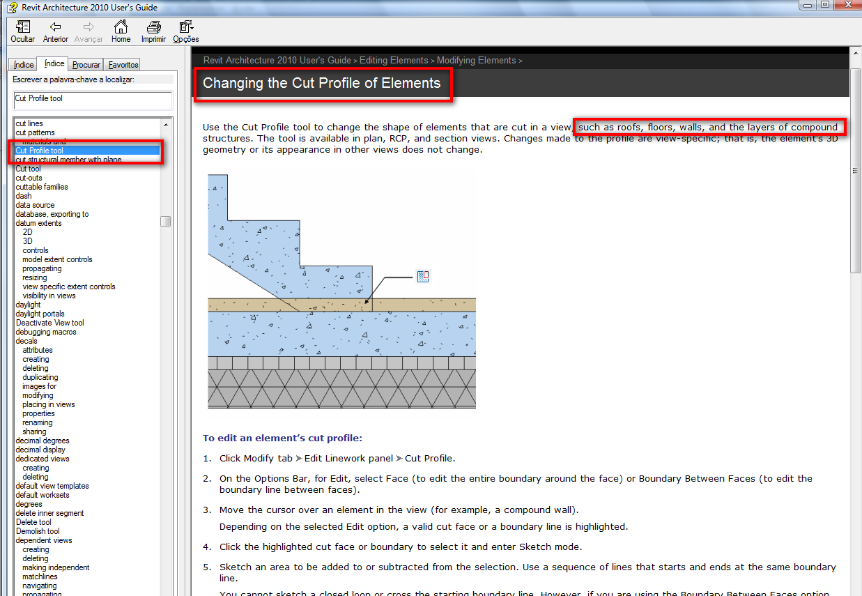

Check your HELP menu...
Sun, Feb 7, 2010 at 8:00:22 AM | Cut Profile and columns
zanzibarbob
Joined: Wed, Aug 4, 2004
26 Posts
3 Stars: 1 Votes
I understand Cut Profile, just try it with a column seperately and see if you don't get the same result.  It seems columns are a problem, not walls, floors, etc.
