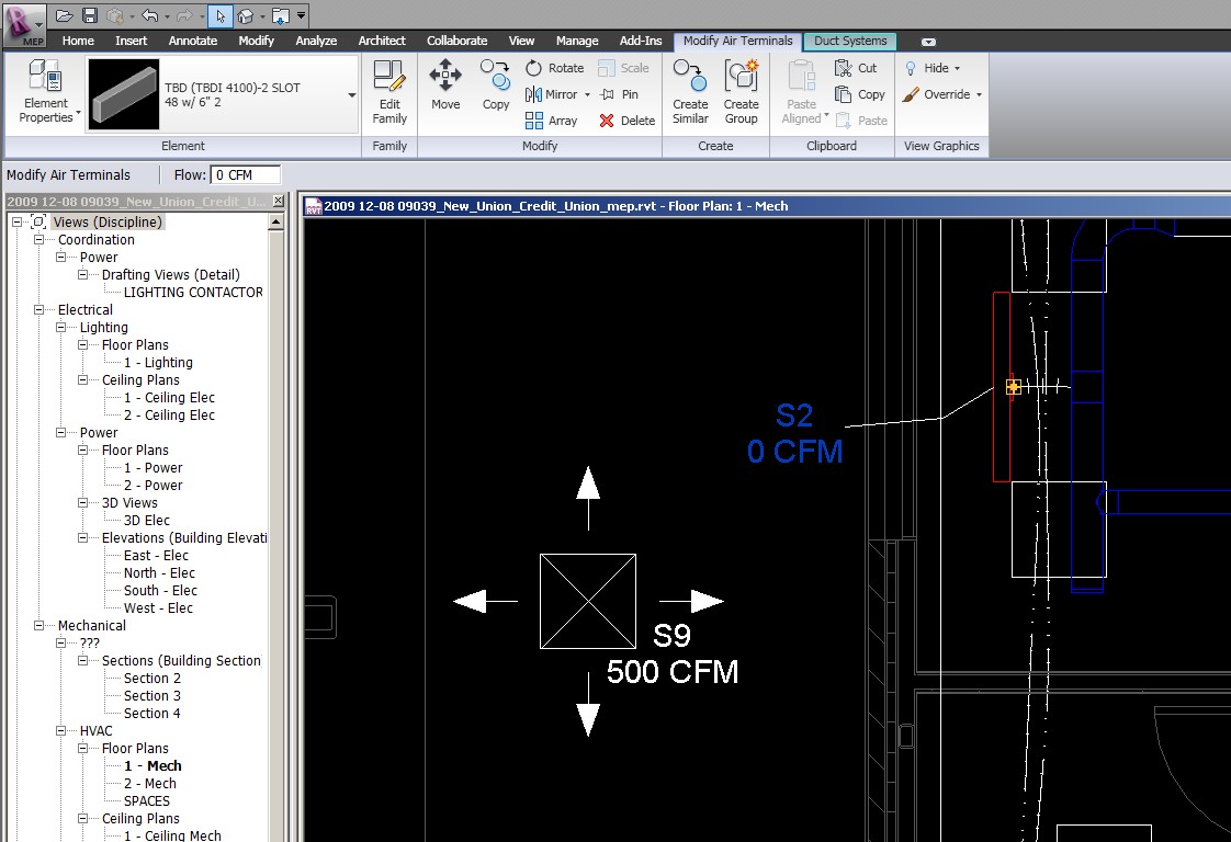

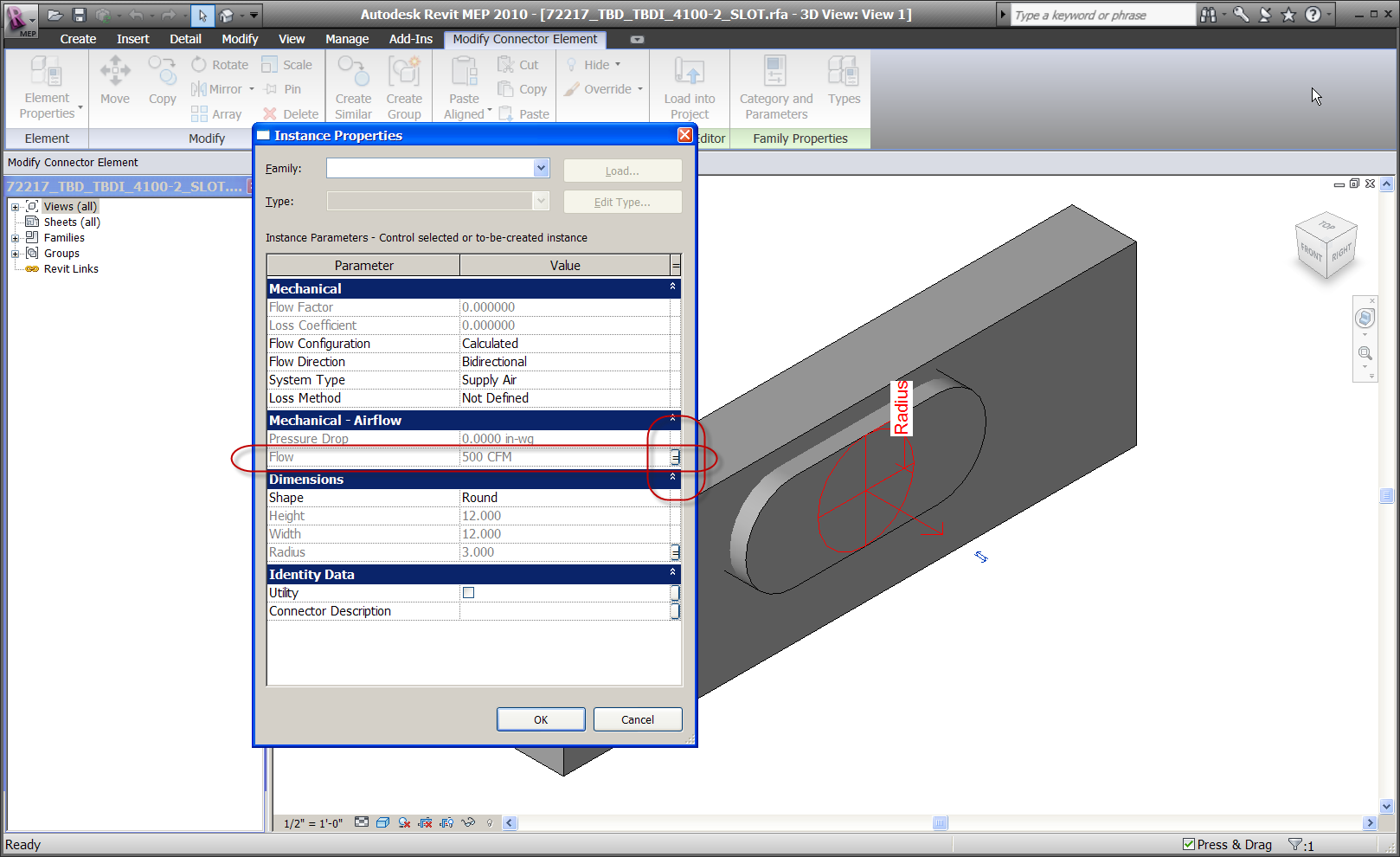

working with mep 2010 i have downloaded the air terminals, and vav boxes from the manufacturer, and everything looks fine. they have the flow set up as a default. but when i place them, and go back to  the units the properties show the right cfm but no cfm is being associated to them for the system. and the diffuser tag can't find the flow. they have flow under Mechcanical-Air Flow and no matter what i change that to it won't update the system. what am i missing?

here is an example of what i'm referring to

Hello, if you take a look at an out-of-the-box air terminal you will see that it is using a property of Flow rather than Air-Flow for the CFM.  To be able to read the CFM on the Price components you could create a new diffuser tag that reads the Air-Flow property instead of Flow or, you could edit the Price components you use and rename the Air-Flow property to just Flow.  Problem is the manufacturer didn't use the standard used by the Autodesk software to identify the CFM.

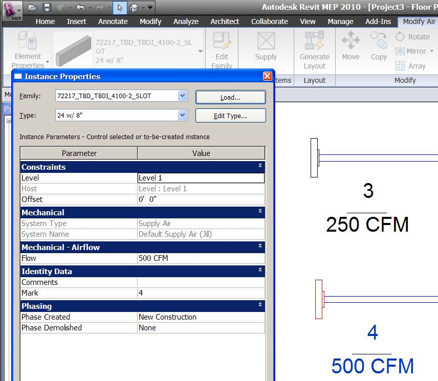

i opened up an out of the box, supply diffuser. that one and the price both have the settings the same. they are instance perameters under Mechanical - Air Flow group, and the line called Flow. i don't understand why it's not getting it right.

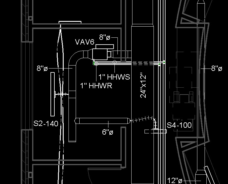

Sorry, I read your post too quickly.  Keep in mind that air terminal flow values only make sense to the system if there is a connected component on a closed system (no open endcaps, etc.) that is providing air to the diffusers.  Then it can size the system.  If no air is making it to the diffuser it isn't going to function correctly.  Are you assigning each of your diffusers to a system along with a component to supply air?  Also, what are you doing on the right side of your second image?  It looks like you are breaking into a duct with a grille?  No can do.  No air can flow in such a situation.  You have to tap off a grille and place a grille.  You can't attach directly.

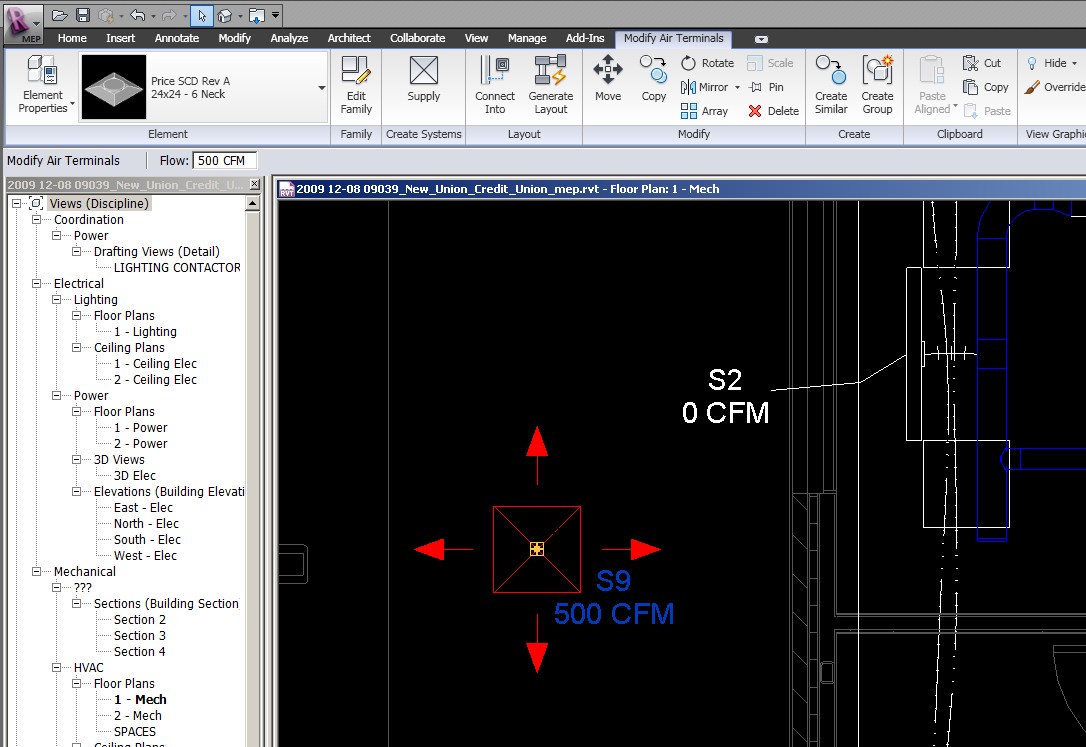

here, i think this is a better picture of that same area. i have the end of the duct capped off. there are 2 diffusers connected to the vav system by flex duct. the other lines going up and down are the suction and liquid lines for a ductless split system. in the properties the diffuser says the right flow. but in that box under the ribbon it says 0 and it won't tag. so i ended up using text next to the tag for the fixture type. i just want to know how to do it the right way. and not have to keep doing things 2 and 3 times.

Hmmm.  The way this is supposed to work:  When you place a diffuser, there is a check box on the Options Bar below the ribbon where you can have it automatically tag on placement.  The value of the CFM you will receive when doing so will be the default value assigned to the diffuser in the Family Editor by whoever created the diffuser.  If that is not the amount you wish to have assigned to a diffuser, you should be able to swipe through that Flow value shown on the Options Bar and type in a different value.  That should update the Flow value in both the Element Properties dialog and the Diffuser tag.  If not, it would seem that your tag is using a different label other than Flow.  Make sure you have a diffuser tag loaded that is using the same label, in this case flow loaded into the project.  Click on one of your diffuser tags, right-click and choose Edit Family.  You should see two labels, one of which should be flow as shown below.  I would recommend taking a look at the tutorial available in your Revit MEP help for Creating a Duct System for additional info if you haven't looked at it yet.

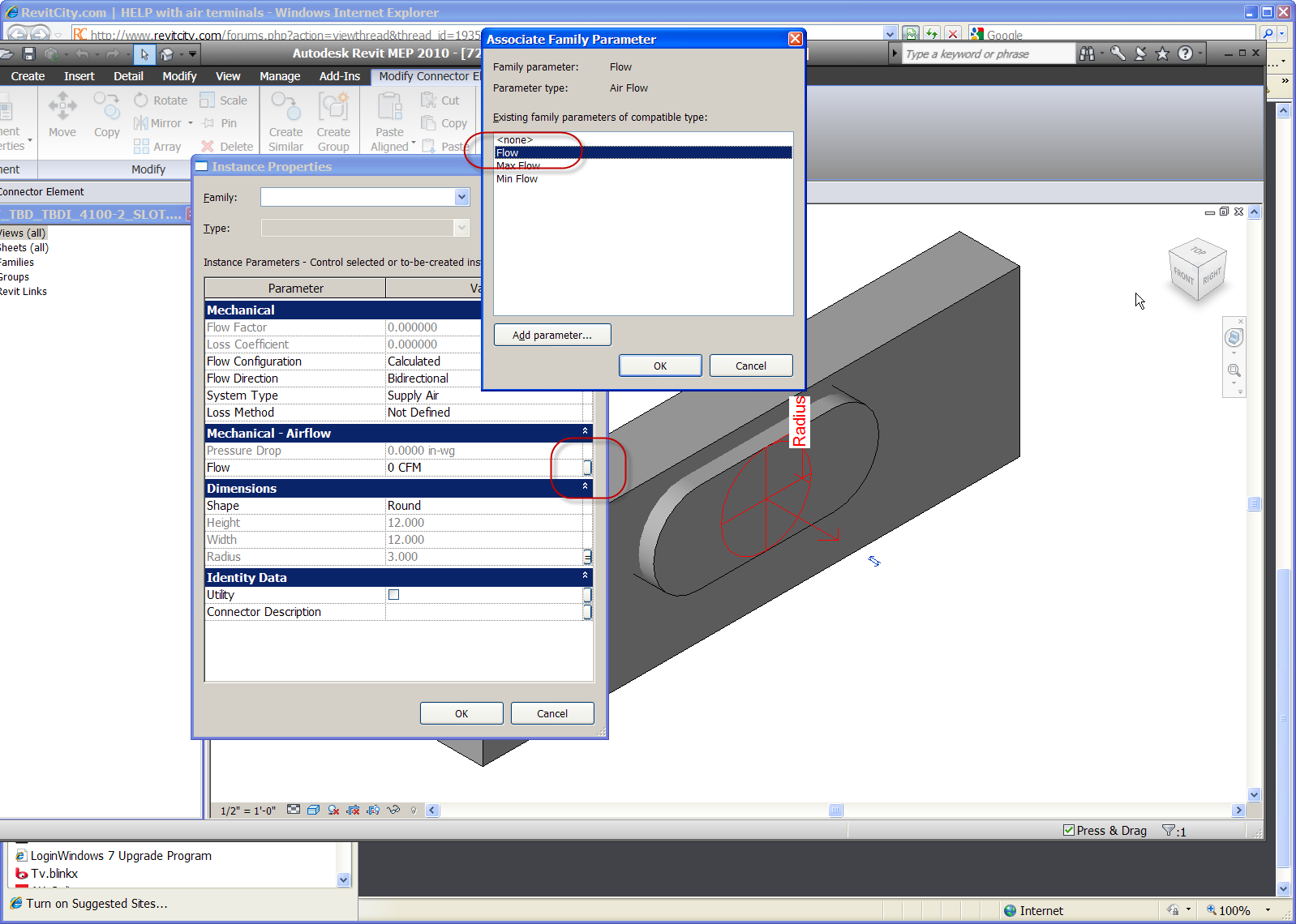

I was able to recreate your problem and figured out what was wrong.  It is difficult to explain in an email though.  First of all, make sure that you have the Price shared parameters file assigned to your project.  Go to the Manage tab > Shared Parameters and browse to find it.

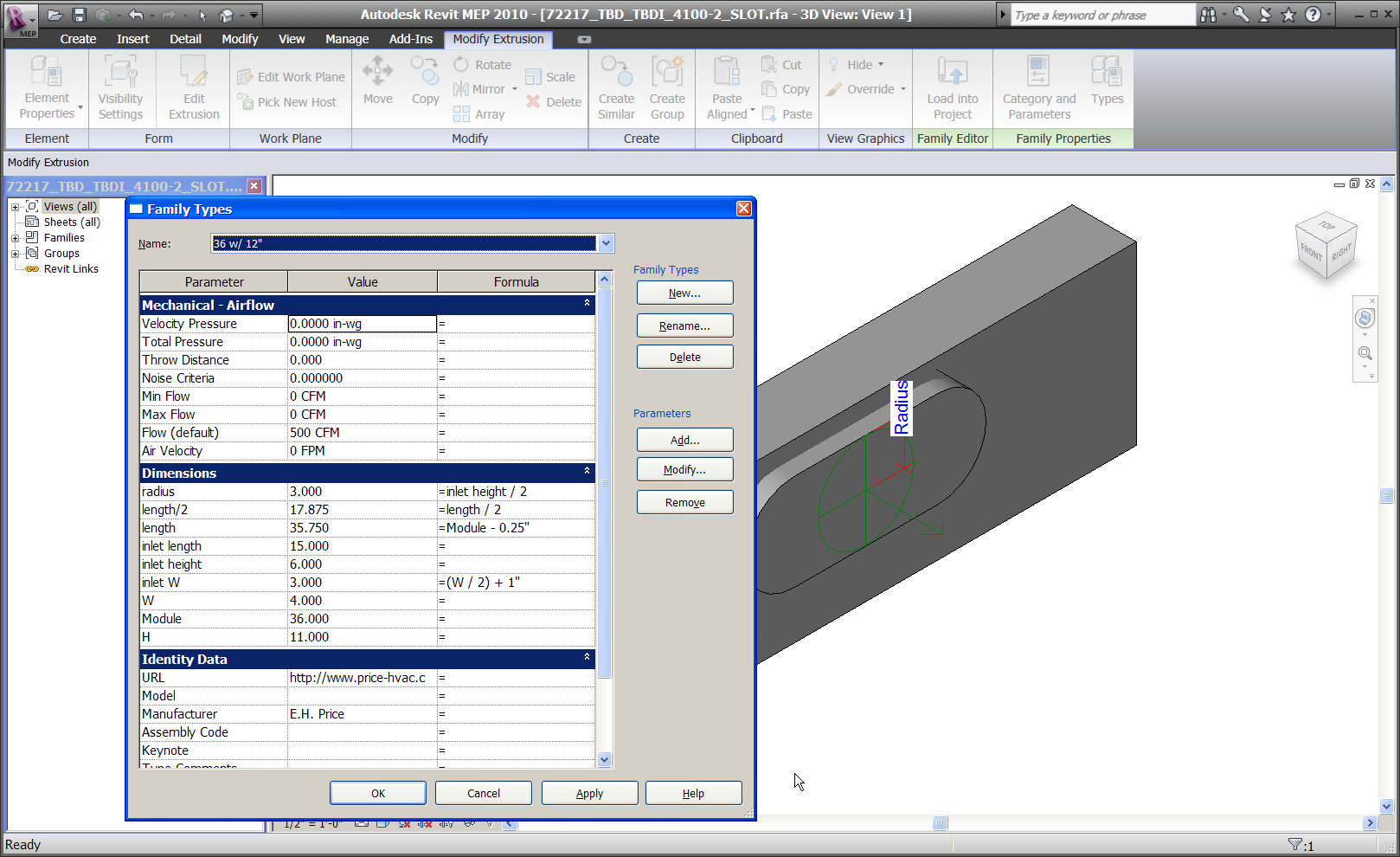

Right-click on one of your Price diffusers and choose Edit Family. In the connector for the Price component, the Flow value listed in the Instance Properties is not associated with the default Revit family parameter of Flow.  Click on the little grey box to the right of Flow as shown in the following image and click Flow in the resulting dialog to make the association and click OK.  You should see that the little grey button now has an equals sign on it to indicate that it is associated.  You will also see that it is greyed out, and automatically reading the current flow value assigned to the current family type as shown in the third image.  Save the diffuser family, and click on Load into Project on the ribbon.  Choose the project you were working in and accept to override all changes and parameters.  You should see that changes made to flow value on the Options Bar and in the Instance Properties dialog can now be made interchangeably.  Hope this all makes sense.

thank you that was exactly the problem. and now it is fixed. do you think that is why the other Mechanical equipment was not scheduling right for me. i mean instead of making my schedules in 10 minutes it took more like and hour to add the perameters into the project and then updating each vav box, each boiler, on and on..... big pain!
