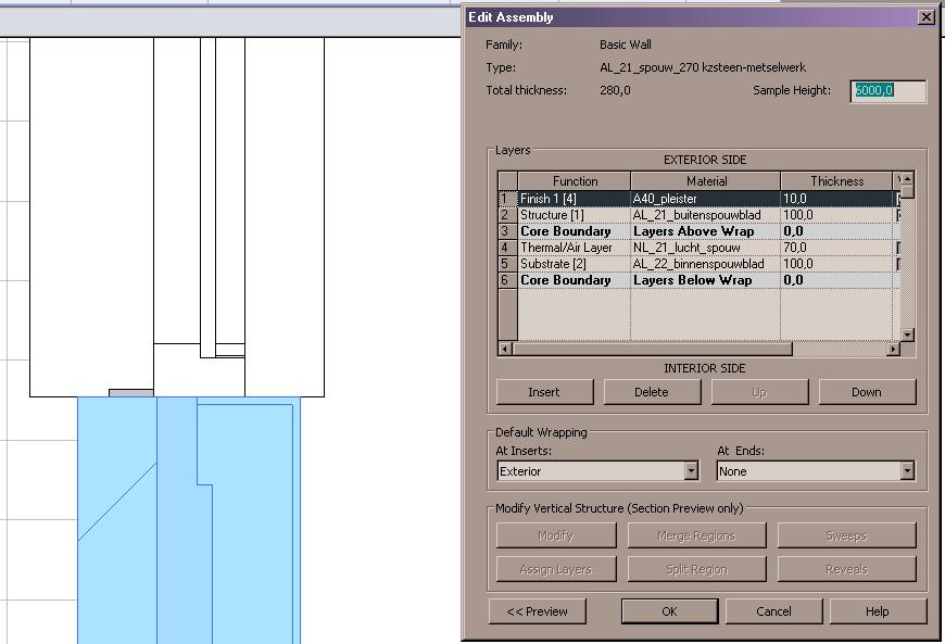

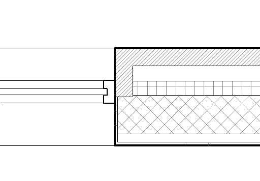

some are telling me this wall wrap is not right with the
wallboard return behind the window frame..
does anyone know anything about this and
could you please show me how to do this
correctly? thanks very very much..

I gues you will have to change the core bounary (check the image).
Otherwise you can also change it using the cut profilletool (not to be recomended).
